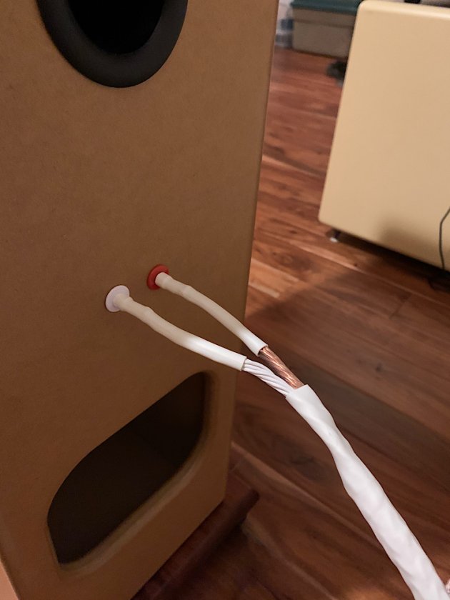

Here are a couple build pics of the 16 strand GR cables.
Very pleased with them. The blisters from twisting and stripping wires have almost fully healed....
