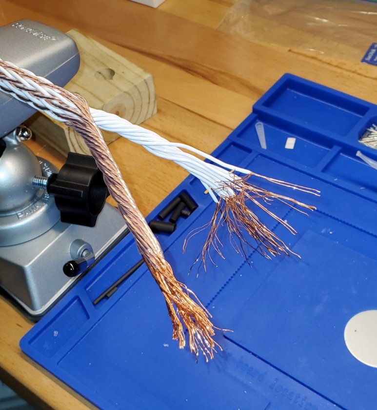

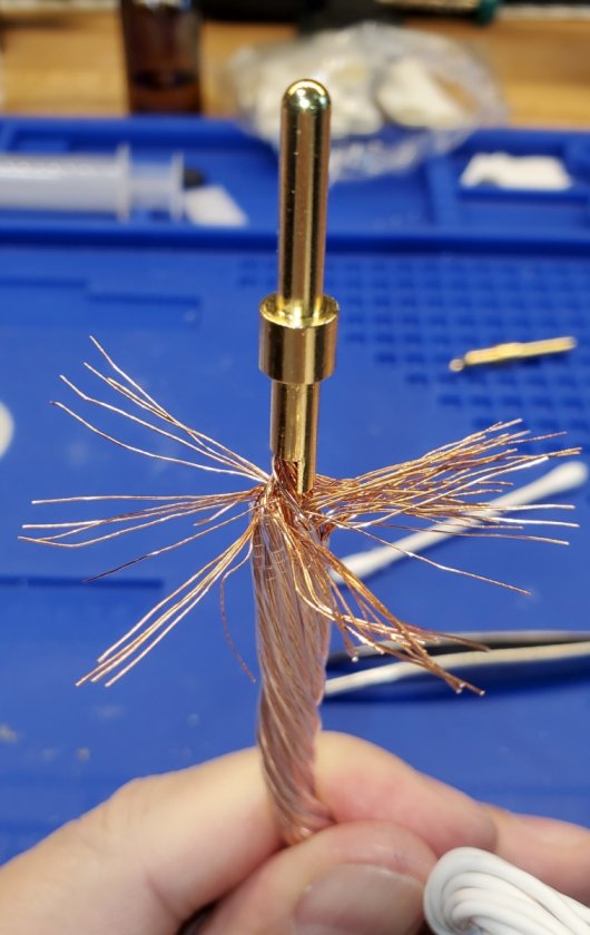

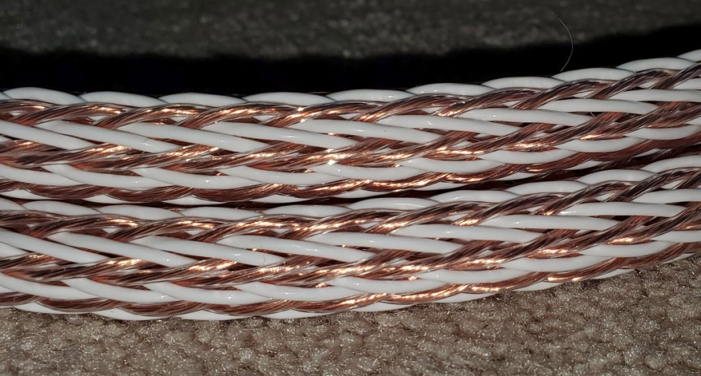

First of all, the cable is beautiful.  It's constructed of 24 wires (12 white/12 clear) braided in a way that forms a tube.

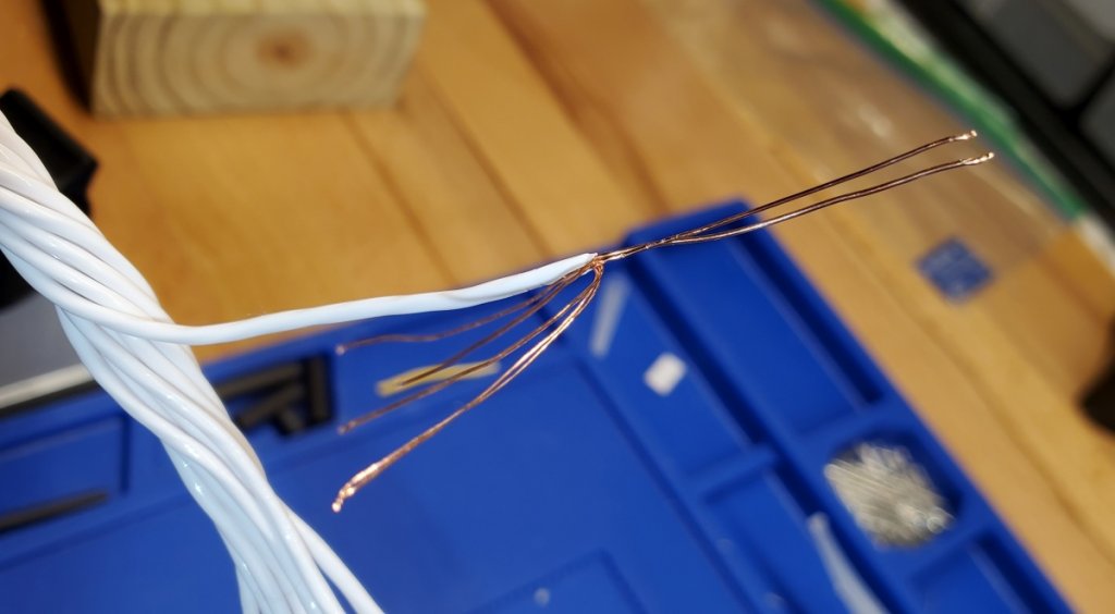

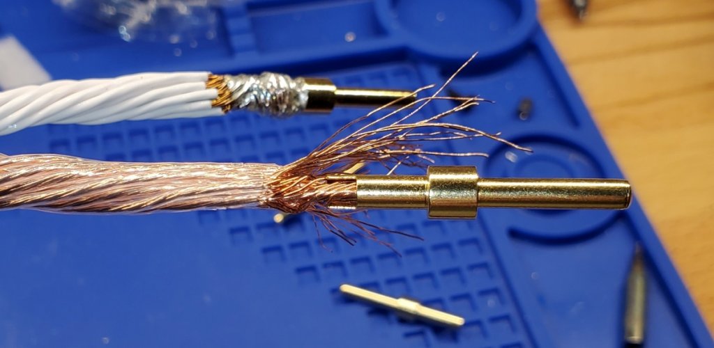

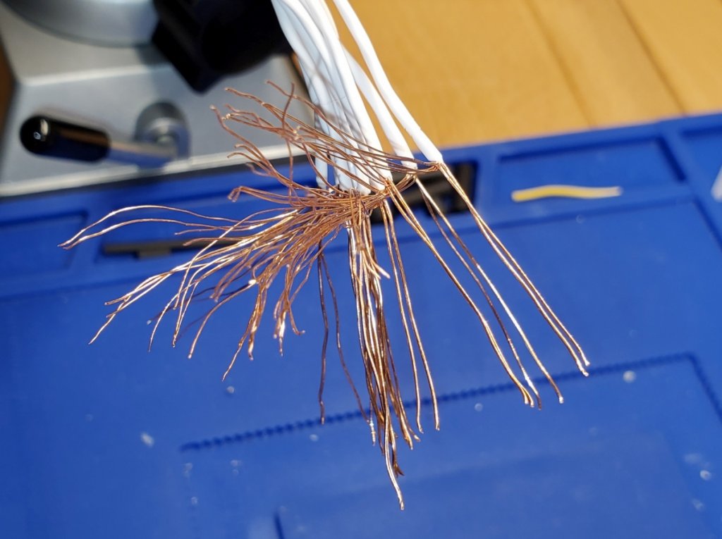

I separated the wire into two twisted groups.

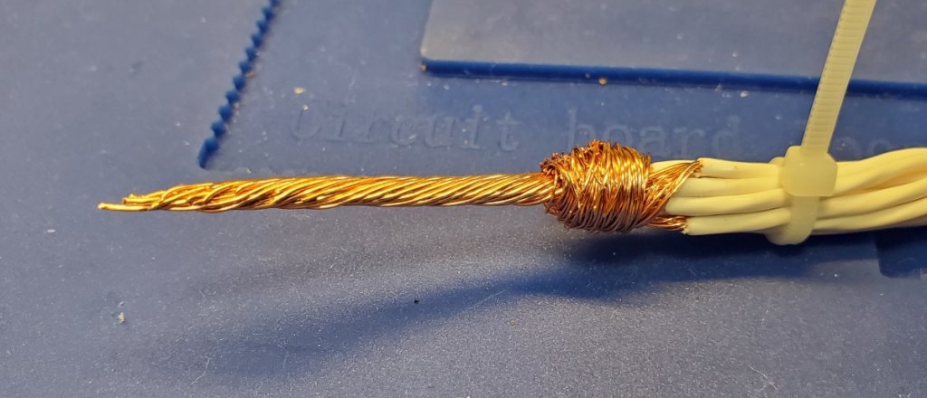

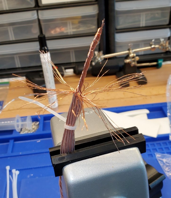

Each wire contained 7 strands of different gauges.  For each wire, I isolated the two largest strands from the rest.
I took the larger strands from all the wires and twisted them together so that they would fit into a male tube connector.
These fit very tightly.  I did not crimp the tube because I wanted to keep it round.

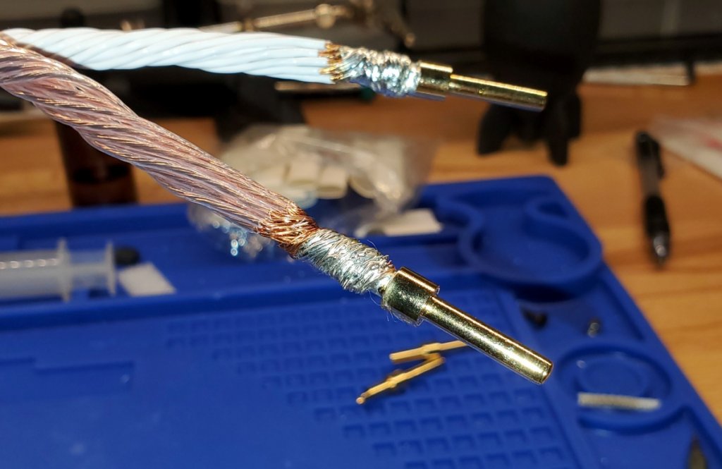

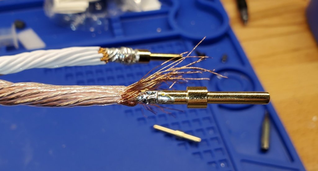

I soldered inside the tube first.
I wrapped the remaining smaller strands from all the wires around the outside of the tube connector and soldered them.

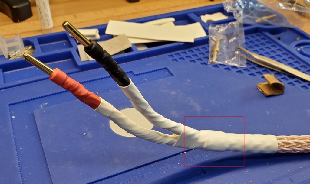

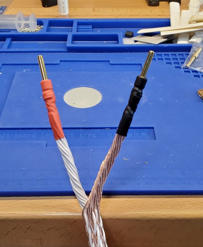

I applied heat shrink.  Do you see anything wrong with this picture?
(My OCD failed me.  I didn't notice that I had the red and black heat shrink swapped, but the mistake was obvious the first second I listened to the cables.  I had to redo the heat shrink only on these two.)
I applied the white heat shrink over Danny's 'secret sauce' wrap (in red box) before the Y and covered all of that with white heat shrink.

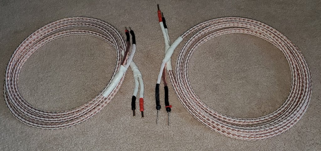

I didn't use tube connectors on the opposite end so I formed it for bare wire use.

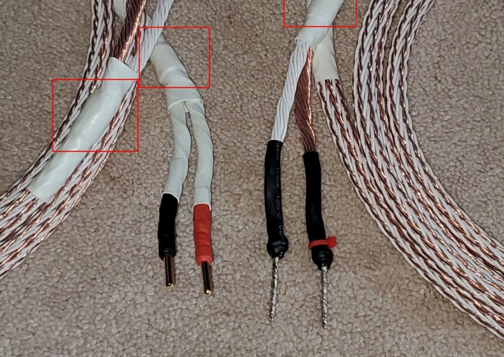

I ran out of red and white heat shrink.  Here are the final results.
I drew red boxes around the secret sauce.

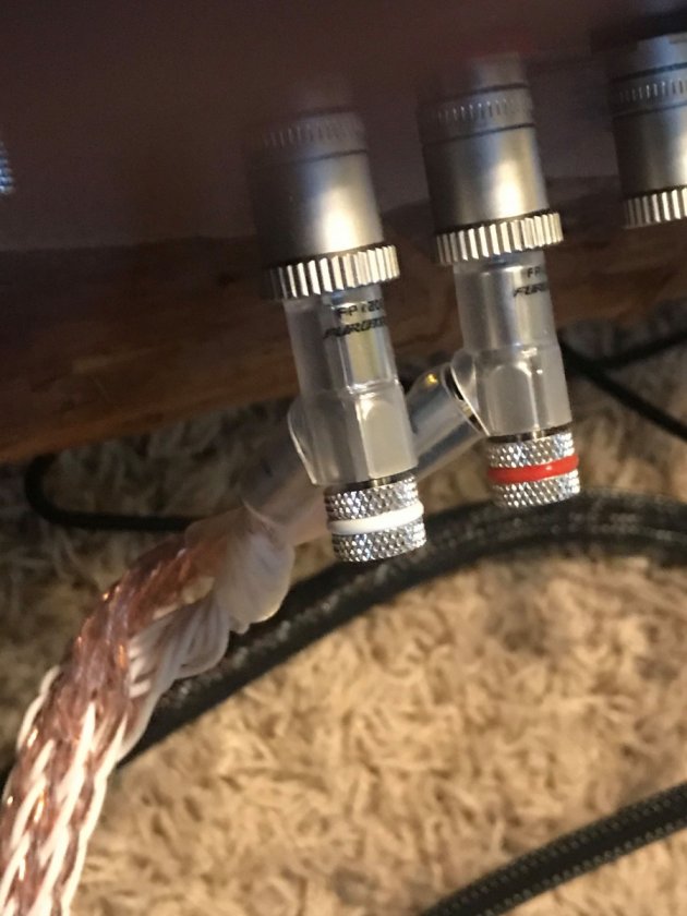

I did mine similar except I did crimp the tube connectors and used clear shrink wrap so not as pretty.
Instead of bare wire at the amp end I used Furutech locking banana plugs
