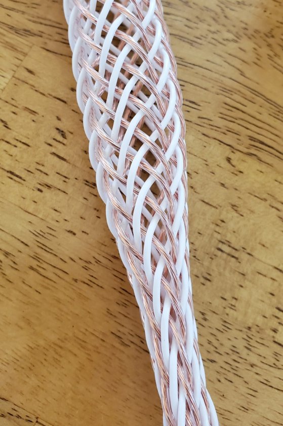

« Reply #40 on: 19 Sep 2020, 04:28 pm »
The braided white and copper certainly is prettier than the typical black techflex.

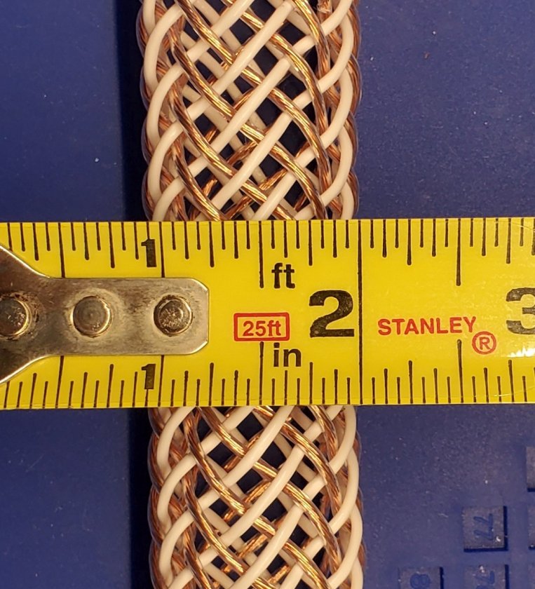

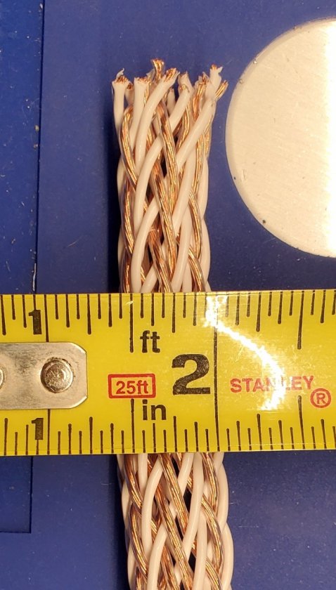

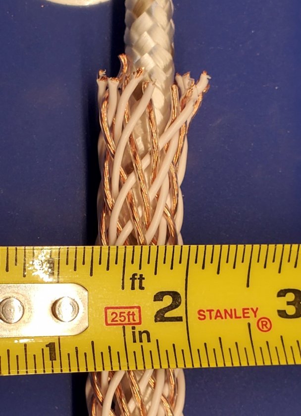

I just received another GR Research 24 Strand Cable Kit from Danny.  The first one was my brother's.  This one is for me.
After reading the discussion about inserting rope and talking to Danny, I was curious about how easy it would be to install the rope.
I experimented with compressing the cable lengthwise to widen the center area.
Width of cable as received:
Width of cable with 5/8" rope inserted:
Width of cable with larger diameter such that the wires cross at a more perpendicular angle:
I think it looks really cool with the larger diameter.
It seems to stay in place pretty well if not moved around.  I don't have pets or children so I suspect the cables would be safe.  If bent, I could form them back into shape.
Has anyone experimented with the wider diameter?

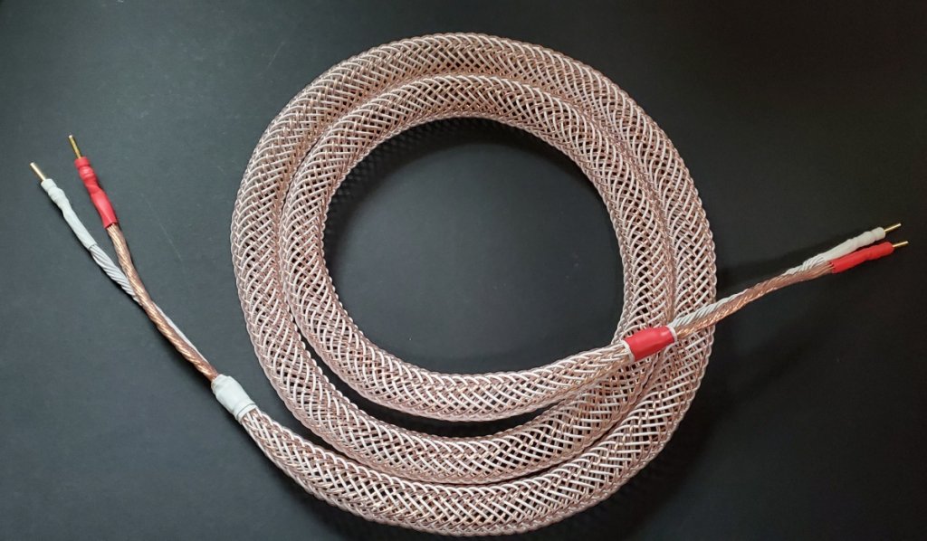

I finished the second set of speaker cables.  I did a few things differently so I wanted to mention them here.
I ended up not using rope because I liked the look of the wider diameter cable with nothing in the center.

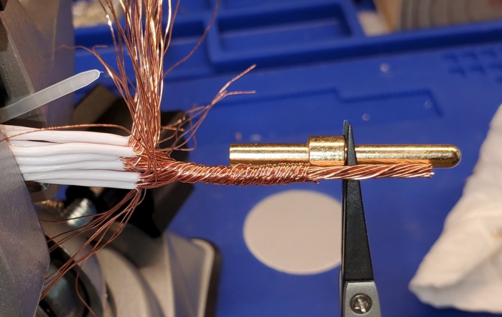

I bought a very nice wire stripper which made stripping all 96 wires much easier, neater, and faster.
Instead of using my soldering iron, I used my SMD/Rework Station.
It enabled me to heat the end of the tube connectors so that solder would flow completely to the ends, filling all air gaps.
(OCD note:  12 largest strands + 4 next largest strands fit inside end of tube.  Added more next larger strands as needed to fill the larger tube opening.)
The completed cable.
With the experience I gained from building the first set of cables, I was able to build these in much less time.
EDIT:  I failed to mention that I received my cable in one piece.  After I cut it in two, I marked the ends on both pieces to keep track of the 'direction' of the cable.  I added red heat shrink on the proper ends to indicate the original direction.  I'm not claiming that I can hear a difference in cable direction, but I just wanted to keep track of it.
