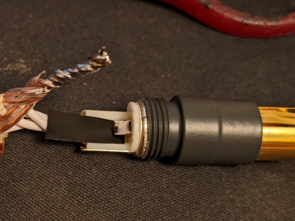

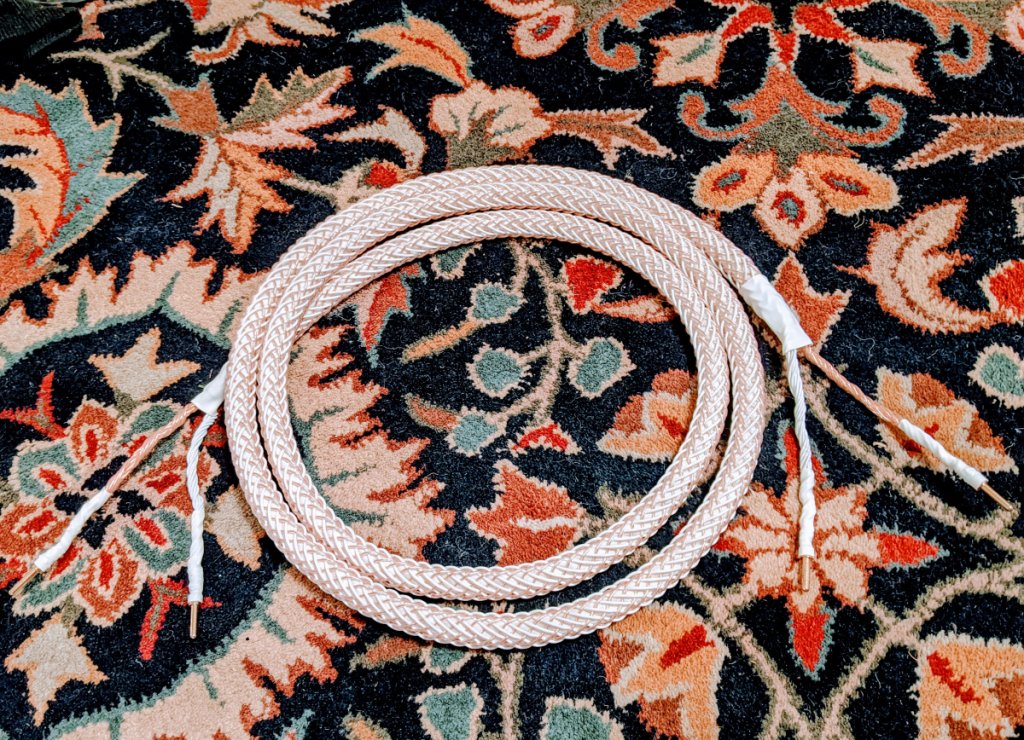

I made my original pair of 16 strand and it took me 6-8 hours To make them, nit including the time i needed to find some rope.
I made a new pair a few months ago & it took 4-ish hours to make them and they look much nicer.
Making prototype interconnects has been more annoying tbh.
I've just finished a 3rd pair and I'm burning them in now.
Here's a pair after feeding a 1/4" cotton rope through them:
And the tight space to install the wiring...
It's gotten easier, but it's still a pain, and the raw cable loses ~45% of it's length with the rope inserted. 7 feet of raw cable produced 2x 2' cables...
I've come up with an interesting tweak that we're really happy with. The trick now will be finding some good quality & affordable RCA ends to use in the final product. Currently I've been using the Neutrik "Pro-Fi" ends as they were pretty good quality without being expensive.
I have more cable on the way, and Danny has several sample ends on their way for us to try out in the coming weeks.  :scratch:
(They likely won't be offered as DIY due to the pain they can be to make)

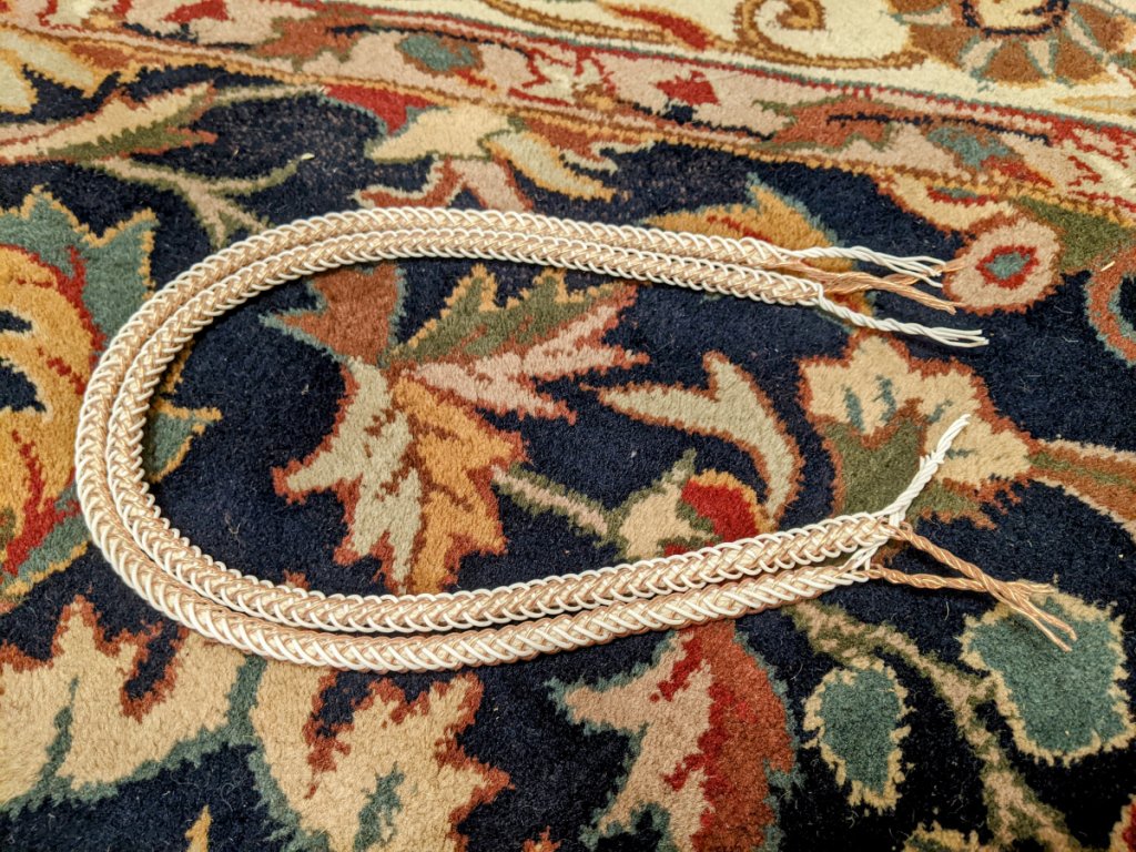

Hey y’all, I have some 12 strand GR research speaker cables I built. These were made with tube connectors and silver/copper banana plugs. They measure about 9 feet each after construction.
I had about 2 feet of leftover speaker cable that I didn’t use and wanted to see how much length is added to the cable with the braiding technique. Turned out 26.5” braided, unwound and straightened was 30.5”,
about 115% of the length.
This makes my 9 foot pair about 10.5’.
