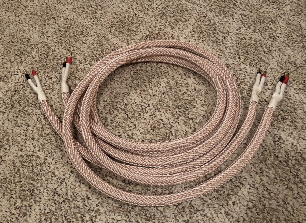

Just would like to say thanks to rock ball and Danny, plus everyone else for tips and tricks. This is the 24 strand, 21’ cut in half with rope and the secret sauce. Tube connectors on one end, banana on the other. I’m never making another pair again, I’ll pay Danny... 😂

Damn straight on the never making another pair again i had no idea id lose 12 plus hours doing this, and that was with an automatic wire stripper. But they are lovely sound great, i dont know how great yet mine aren’t even close to being broke in. Moved, and i decided it was time to repair the severely stripped screws in my speakers, so this is yet another awful project of taking my speakers apart and drilling inserting glueing drilling and inserting again,. Not to mention -unsoldering and soldering all the drivers back to the wiring.
Geese, it is worth it, but sometimes hard to see when you are stuck in the middle of one of these long projects. I forget what good hifi sounds like haven’t had my stereo in over a month.
