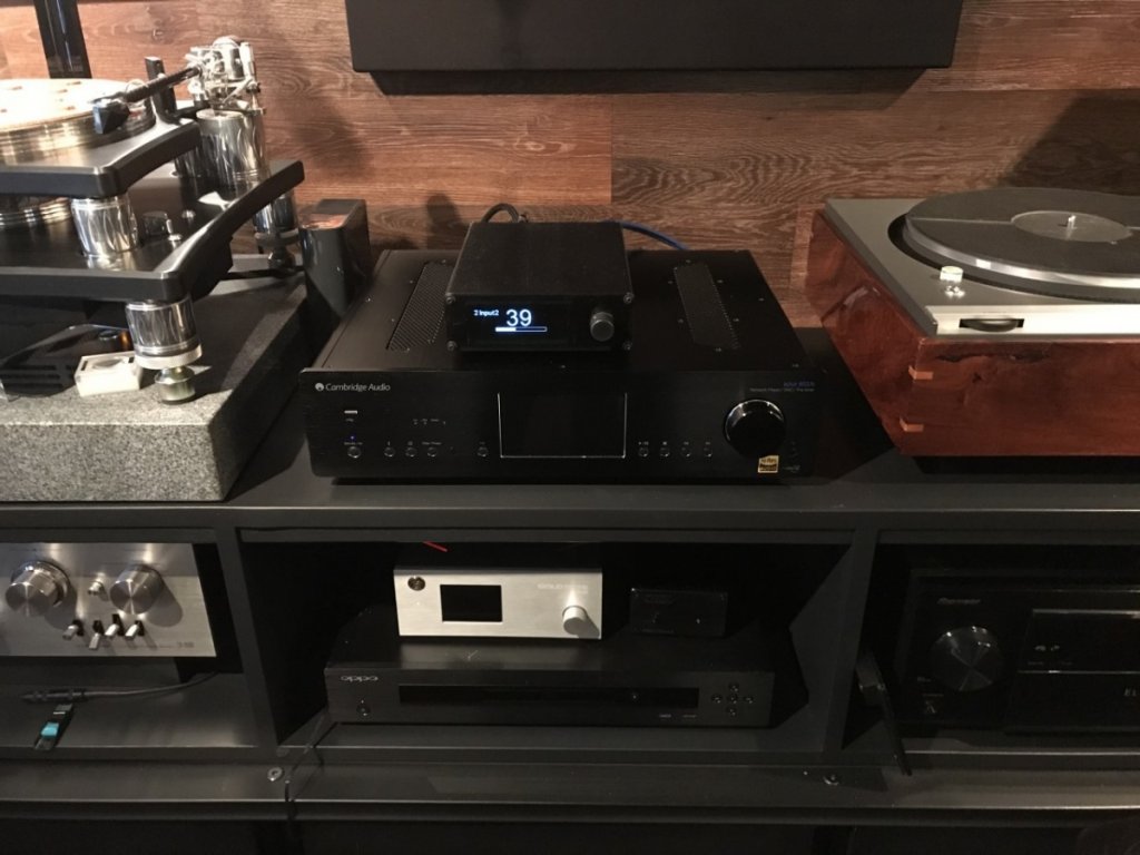

Hello all.  I had a pleasant surprise today when the pre-amp arrived earlier than expected.  I will be setting it up this weekend and will give a report within the next week.

krustykat
Re: LDR300x.V3 Preamp Tour
« Reply #98 on: 9 Feb 2021, 03:42 pm »
The LDR300x.v3 arrived this weekend and I had a chance to try it for a bit on Sun and Monday.  I'm using a VPI Classic w/ a Transfiguration Phoenix MC cartridge through a K&K Maxxed-Out phono preamp for my analog source and a Innuos Zenith MK3 to a Border Patrol DAC for my digital.  Output to a Pass XA30.8 amp and Selah Tempesta Extreme speakers.
The timing was fortuitous as my normal preamp developed a slight problem that required me to send it in for repair.  The appearance of the LDR300x.v3 is very subdued - it eschews bling for an appearance that just blends into the background.  The bamboo front on my LDR3.v25is a bit more stylish, which unfortunately is not available anymore.  The apple remote is a nice touch as they are easily obtainable just in case your dog decides to chew on it.
My initial tests with the turntable showed none of the problems earlier reported with crashing on needle drops.  The user interface is well laid out and very intuitive, much easier to use than the old non OLED interface on the LDR3.v25. The sound is clear, bass extension is tight and deep.   Treble extension is very good, with only the slightest touch of grain on some vocals.  Soundstaging is very wide too, it's not as deep front to back as I've heard, but it is still very good.  I do wonder if a good linear power supply might help, but unfortunately I don't have one of the right voltage to test.  In active mode, the gain is too low for me, I had to go up to 75 (out of 100) or higher to achieve my normal listening volume and it never pushed my amp out of class A mode.   Morten, is this adjustable?
I'll be listening more over the coming week and will post more detailed impressions, but I can say that my quibbles are minor and I am quite impressed by the quality of this unit!  It appears to be a steal for the price that Morten is asking for it!  I'll be testing it in passive mode and also comparing directly against my LDR3.v25.   Stay Tuned.
  :popcorn:
