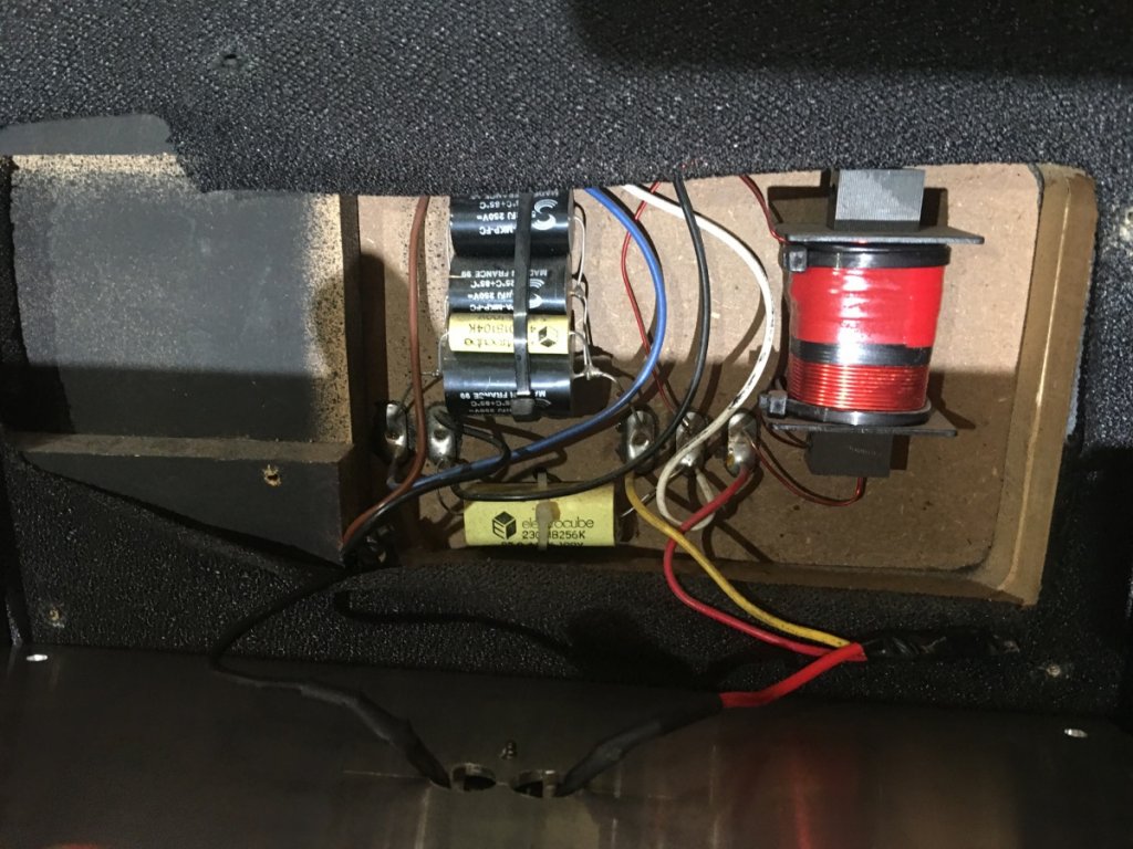

Hi.  I am new to Audio Circle. I recently bought a pair of used Magnepan 1.6 speakers.  Unclear how old they are but they appear to be in good condition and the panels look good when shining a flashlight through.  And the speakers sound good except they are almost completely lacking in that bright sparkly treble that I thought they were known for.  Something like  chimes or a triangle simply isn't in the music played through the 1.6's.  If you stand right next to the speaker you can hear those instruments very muted but not at any normal listening distance.  I've tried googling to see if this is a known problem with these old 1.6's but without any luck.
The speakers were modified to remove the fuse.  Attached are images of the back panel and what is behind it.  Could the capacitors have gone bad or is it more likely that there is a problem with the tweeter ribbons?
Does anybody know what might be causing this or if it is fixable?

Hopefully some Maggie owners will soon chime in, but your statement about the original fuse being eliminated/by-passed sounds a bit suspect. (this assuming the fuse protects the tweeter section) That coupled with the fact you're apparently not hearing any output from the tweeter section. I'd have a conversation with the seller.

I agree with Mick, it sounds like the ribbons are toast and yes that is what the fuse is for.  Might call Magnepan and see what the replacement ribbons cost and if you are handy do the labor yourself.  I have 3.6r's and it's fairly easy to replace the ribbons in them.  Judging from a few pics online it looks about like mine.

Were the speakers shipped? May want to check all the solder joints. Giggle the wires a bit and see if you hear a difference. That can be an easy fix.
If the quasi ribbon tweeter is burnt, that's not an easy fix like in the 3.6 or 3.7. That may require a trip back to Magnepan

Sorry to read about this.  I agree with everyone that it appears to be the QR tweeter.  That being said, the QR is virtually indestructible compared to a true ribbon.  However by bypassing the fuse, anything can happen.  Unfortunately it’s not an easy remove and replace as the true ribbon models.
As Emil states, check the solder joints and components of the crossover, but also check your speaker cables and connections.  I have silver spades on my speaker cables (amp end) and had muted volume as well.  Cleaning them with Deoxit cured that issue.
Hopefully you have an easy fix.  If not, I’d contact the seller.  It’s doubtful that Magnepan will repair a speaker with modified crossovers, but I’d contact them as a last resort.

  Both speakers ? If both it might be the revised crossover for tweeter section. I would talk to seller and ask if tweeters were attenuated. Removing the fuse section should not affect output of such. Both being blown does not make sense to me.

Since you have easy access to the back, you need to probe the blue and brown wires and see if you have continuity.

You can play some music and put your ear near the tweeter ribbon. If one is bad, it'll be noticeable. If there's no sound from a tweeter, check continuity, as Davey says. This will tell you whether the problem is with the ribbon, the wiring, or crossover.

Bypassing the fuse is fine but it's unfortunate the speakers were modified like this, because it precludes adding an attenuation resistor into the tweeter network.

My guess is the capacitors are wrong for the tweeter. It looks like the caps were also replaced. just tossing in a pile of capacitors will probably end up screwing up the crossover frequency and may also be responsible for cutting the highs off.
Buying modified stuff may become a nightmare, and you got the nightmare version.
What I would do is figure out the caps values. try to get an original schematic with the correct values. Which you might have to search for, I think Magnepan will not give it to you?
They may not be worth the bother. Uness you can find a skilled techie who is willing to help you for free. (or you can figure it out)
Anyway I think it is the caps that are messed up. wrong values dead cap,(particularly any for the tweeter)  wrong wiring hard to say. I suggest threatening to sue the jerk who sold them to you. Ask for a return and refund. they will cost you more than they are worth to fix.

I agree with Elizabeth that the crossovers are wrong.  You can contact Magnepan and see if you can purchase new crossovers for the 1.6's.
Another option is to contact GR Research.  Danny has a crossover mod for the 1.6's-

The crossovers here are a series configuration and you shouldn't be fooling around unless you know what you're doing.
You certainly shouldn't be sending a full range signal to the ribbon tweeters of a 3.X speaker.
