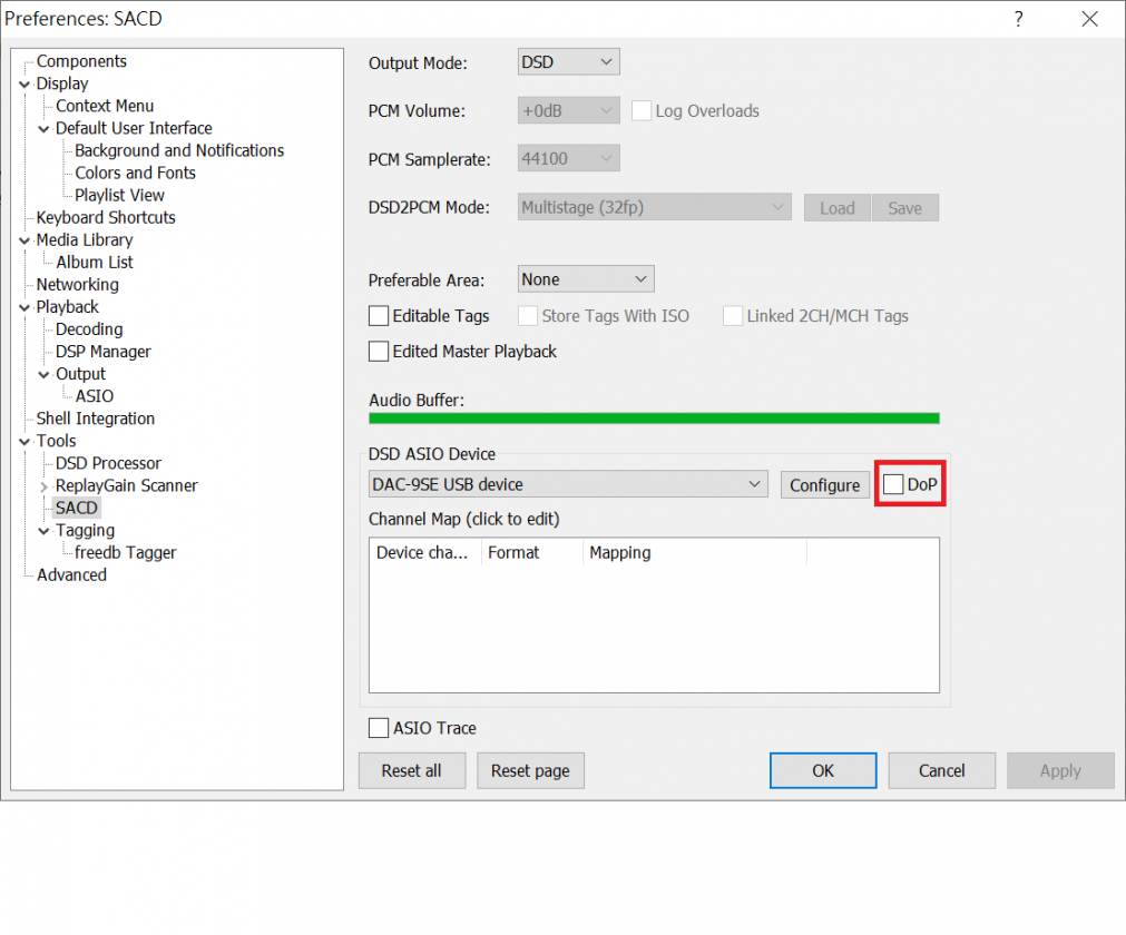

Can you try uncheck the DoP box as shown in the image?

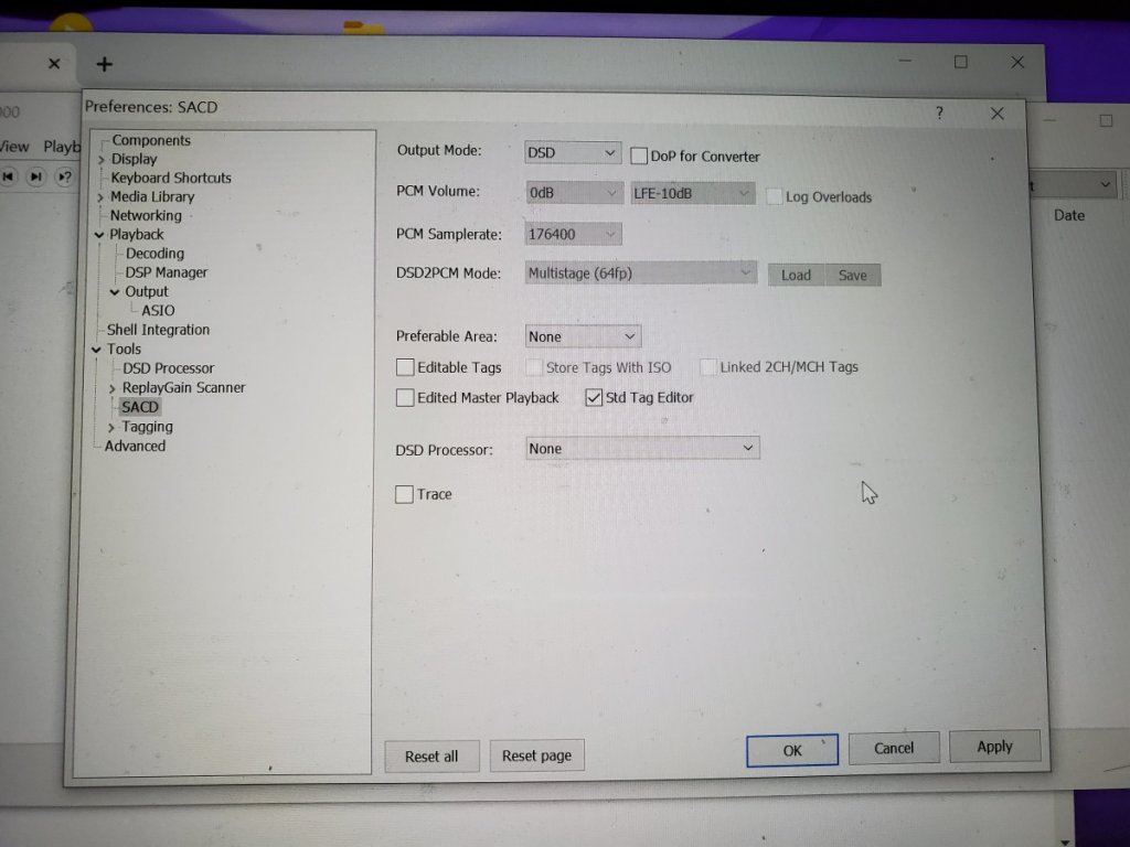

I think there are something wrong at ASIOfile..My foobar is ver.1.5.3..and SACD option shows "DSD processer" option only...I can not see DAC9SE page..
I will upload that image very soon..

Here's the page for SACD setting, As you may see, I can not see DAC9SE setting which was in your case..

I didn't give you the complete information. Just got this from support:
1. Download SACD plugin version 0.9.4 for Foobar here:
https://sourceforge.net/projects/sacddecoder/files/foo_input_sacd/
2. The the DoP checkbox will appear and you can uncheck it.
This will allow you to send native DSD to DAC-9SE.
Etiven

Thank you, Rusty!
It works very well!! Me and other DAC9SE users are very happy with this~
