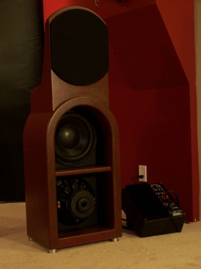

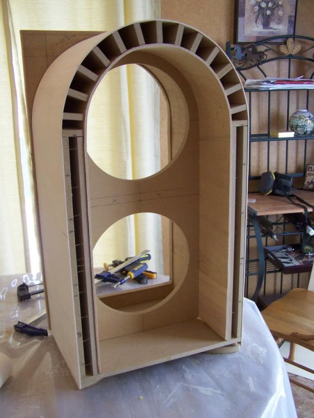

I made a set of GR  super V, the lower subs with a round top......this count ? 8)
They were made hollow and sand filled.....
Since this pic they have become topless and they serve as dual subs....still with the round top

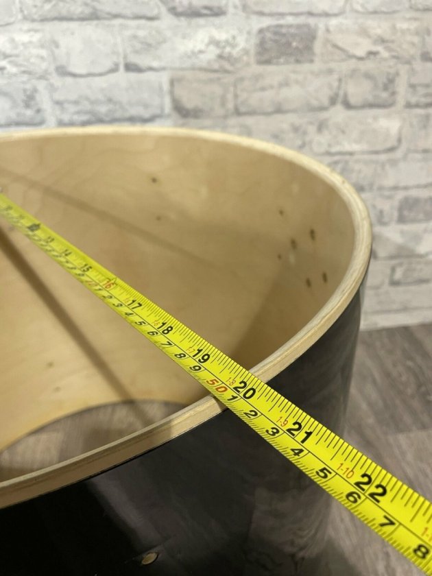

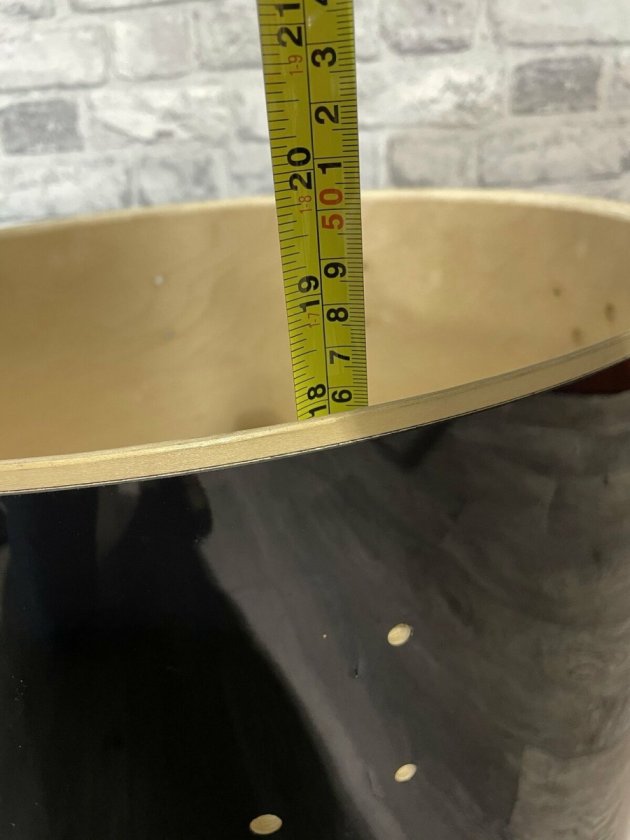

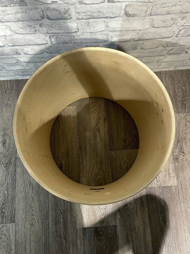

I am working on constructing the front section of a circular H frames to fit over the 15" drivers. To experiment I have bought a drum shell which is 18" tall and 20" diameter. The construction material was important to me and this is 8ply birch hot bonded under high pressure in a circular press so that the glue impregnates the ply and makes it very strong.
It is only 10mm thick which I hope will do the job for a number of reasons
1. It very strong and I never see the cones of my bass drivers move during normal listening so don't imagine the pressure waves to be too 'destructive'
2. Being derived from a musical instrument it will have a good sonic pedigree
3. A circle is much less liable to resonate than a flat sided box.
4. Being wood it can be cut and drilled for fitting
5. It is birch ply which is the same material as my main baffle
6. It wont add too much more weight to my speakers which are already very heavy.
To avoid quarter wave resonances each hoop will be 7.5" deep

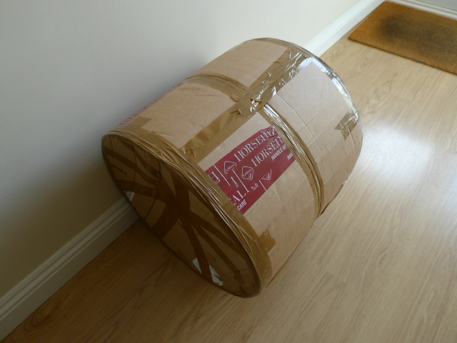

Drum shell just arrived. Its in Covid quarantine at present  :D

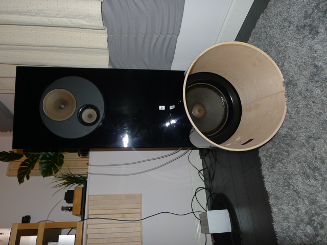

Very interesting. Being a bit impatient I propped the entire cylinder in front of one of my 15" drivers. Now I read the King equations which suggest a maximum length of structure ahead of the driver should be no more than 7-8 inches to avoid quarter wave reflections. Here I was with 18 inches of cylinder ahead of the driver and no evidence of distortion or echoes. Do those equation only apply to H frames which have parallel sides.
http://www.quarter-wave.com/OBs/U_and_H_Frames.pdf
