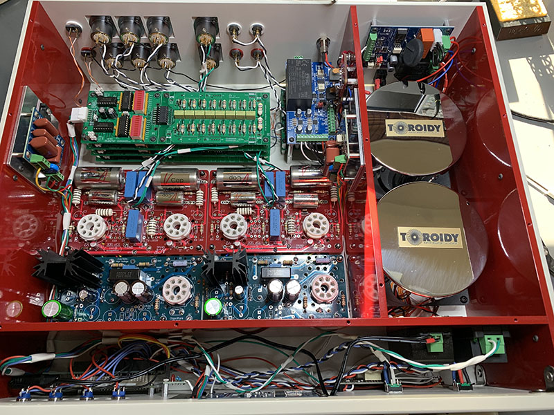

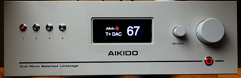

Here's my current work in progress (in case you need any inspiration  :)). Almost done (I hope  :icon_lol:). AMB delta 1&2 balanced attenuator and input selector PCBs using Z-foil and AN silver tantalum resistors. Balanced Glassware Aikido 6SN7 buffers with Neurochrome Maida regulators. AMB A24 for single ended outputs (for subs). Custom Arduino software for control.

You should consider selling your Arduino solution for the AMB attenuator or at least selling a how-to guide. The guys on the AMB forum have been clamoring for an LCDuino update for years. One of the reasons I went with Khozmo over the AMB was the display.
I have been following your Steve Hoffman thread so I know all about that preamp you are building.  :popcorn:
