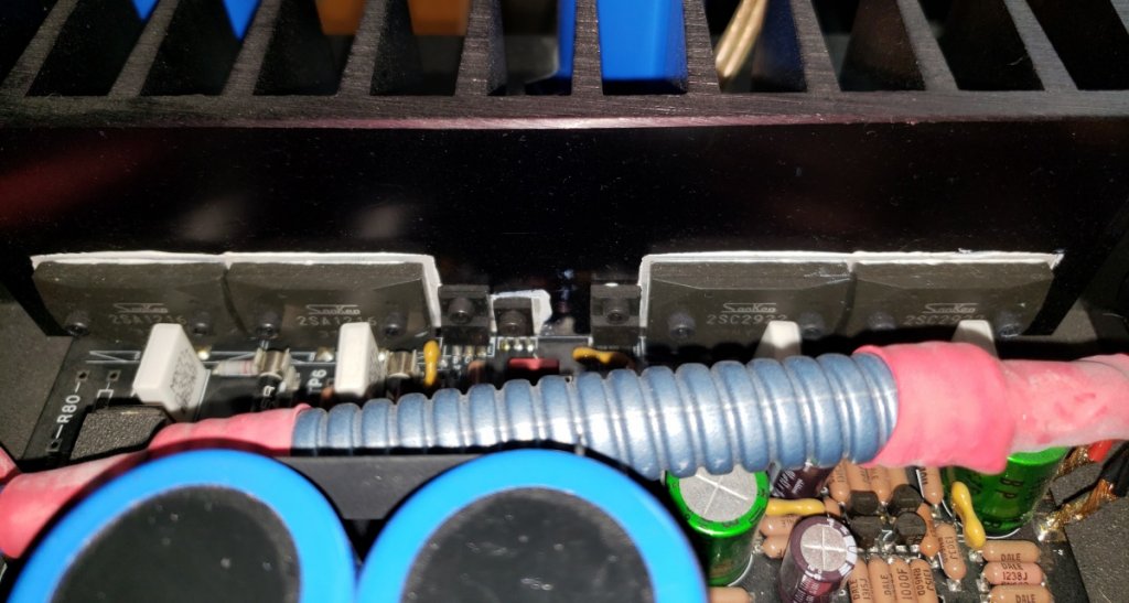

As an update, there are still issues with the heat of the Kismet in Khartago.  The case is currently 20 degrees F above ambient temperature (measured on sides and top of case with an IR thermometer), still hot to the touch.
Any advice would be welcome.  Does the thermal material touching the heat sink require periodic replacement?  Any other ideas?  The Odyssey audio sounds so good from that amp that I am loath to change anything!
I have not recently heard the low volume, high pitch sounds for a few seconds with the Khartago.
No tubes are in my playback chain.
I have opened up the Khartago to re-verify bias and offset which are correct.  Currently the line voltage is 109V and the bias is down to 16mv for this Kismet board (AC has ranged from 109V to 118V per recent measurements with a Kill A Watt meter.).  Seems like the bias varies as the line voltage changes.
What thermal interface material is used with the 2SA1216+2SC2922 transistors?  After about 10 years maybe it needs to be reapplied.
The inner heat sinks measured 120F, then went down to 108F after the top case was open for a while.
