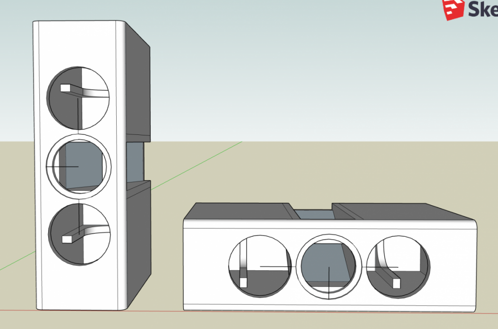

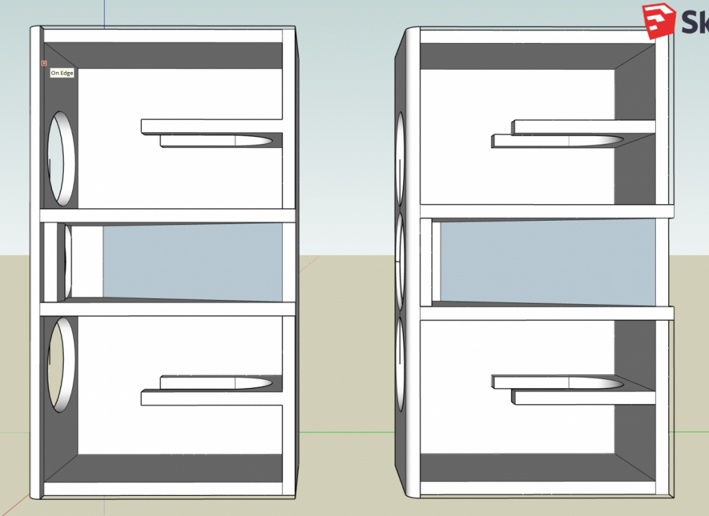

Okay, Update time!
On my Neo3 thread, I used my NX-Studio kit to get rough measurements, to produce a more accurate waveguide that will be easier for those that want a simpler installation that can also be re-oriented for vertical/horizontal use.
And with that, I moved forward on designing a cutout that should work in the Studio MTM design:
6" diameter circle with a 0.24" recess, leading to a 5" diameter hole on the inside.
I'm actually quite proud of this design... :green:
The outer rings around the woofer holes signify where the outer edge of the woofers mounting base sits. Enough to cover the bottom/top screws, but not the edge of the waveguide when in the vertical position. I also had to expand the overall size of the cabinets a little bit to better match the needed volume, and give a little extra space to the waveguide.

It might, but im just using the free version. I also haven't looked into that yet either. But it may still be possible? Tho it is the free online only version, so it might not be possible.. (yay for subscription services!)
The tricky part will definitely still be the rear slope. I still need to find a way to simplify the process it a little more, tho.
The idea behind the left/right vent is for a wider sound stage. It will probably loose some depth compared to the standard Studios, but it can still function as a center channel, which was it's design idea.

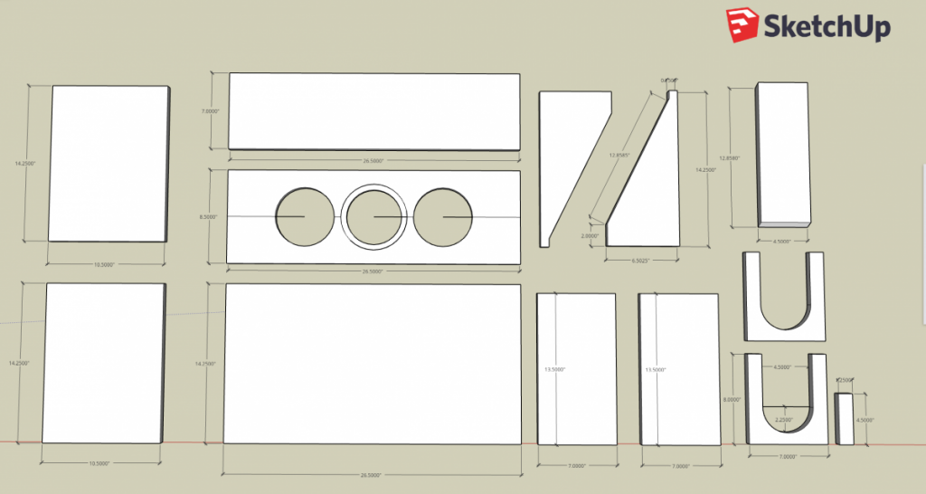

Okay, finally got around to making my own "cut sheet" for all the parts pieces required for the build of a center channel/bookshelf.
This is a simplified version, using a more "squared" slope and all using .75" MDF
Full dimensions are 8.5" x15" x 26.5"
Tweeter cut-out is intended for use with my 3D printed design in my Neo 3. A 6" outer radius with an inset of .25" and an inner radius of 5". Woofer holes are the standard 5.75"
The angle on the shelf is 26.5°, the sides of the slopes are designed to sit on top of the back panel. (I forgot to add it here, but a 4.5"x2" piece is needed at the front of the slope.) The small piece on the bottom right sits .75" below the outer edge, and allows a custom speaker grill to be added.

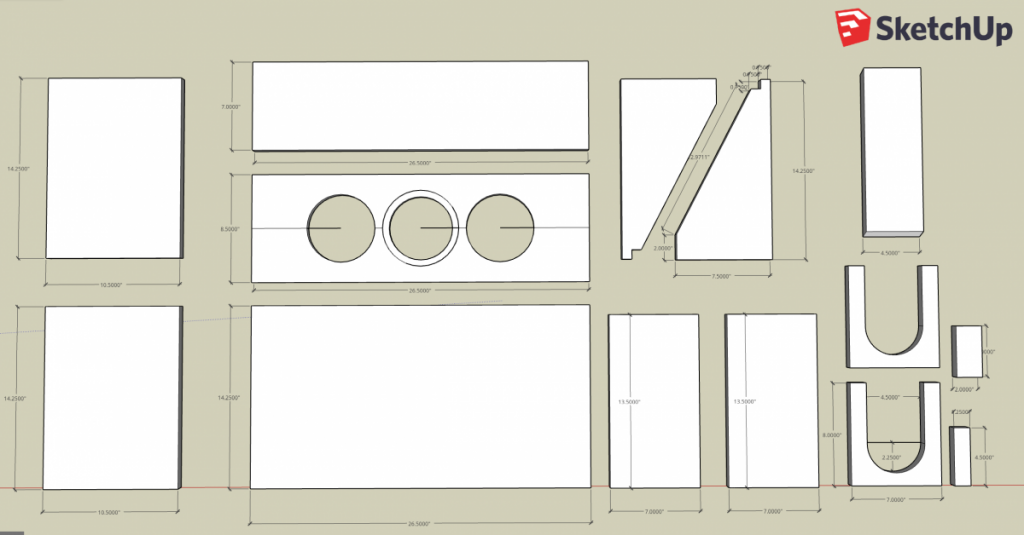

I missed a couple details, so here's an update of the cut sheet:
Here's the link to the full quality version:
http://puu.sh/Gm6mW/6f99210230.png

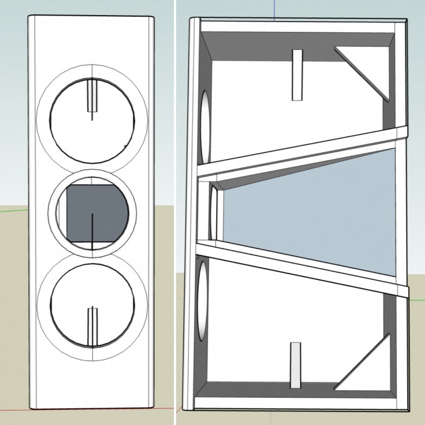

« Reply #49 on: 26 Aug 2020, 11:40 pm »
Made some more small adjustments, the slope is now 5" wide, but otherwise the same overall design. :P
This is how the cut list should appear once assembled:
Old design on the left, new on the right.
