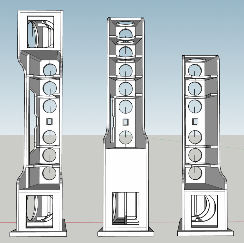

Ended up going to bed super early last night, so i never got around to finishing this design, so i got it finished early this morning instead. :P
Pretty happy with how it turned out, tbh.
mmm yes!

Is there a way to make the bottom section wider and cram a second woofer in there? I'm afraid that a single woofer won't be sufficient, and these floorstanders would require a set of dual servo subs to be exceptional which is costly and consumes a lot of real estate.
Not wider, but definitely Taller!  :thumb:
Specifically #2 or #5/6
#1 would be a separate, inverted Otica that sits sit on top of the Dual H-Frame.
The design of 5/6 would need to be independently powered and reinforced to support the upper sealed Sub.
#4 wont have enough room or volume to fit both Subs. A passive radiator? Maybe.
Aside from #1 none of these subs would work in an OB setup, the waves wouldn't cancel out properly since they're almost perpendicular in this setup.
Ill work on making these designs in SketchUp tomorrow.

Number 1 makes the most sense, in my opinion, for a lot of practical reasons, although #5/6 is badass if the weight could be distributed evenly.
Approximately how tall is #1?
Yeah from a practical sense, they'd definitely be the easiest to build and would maintain the full OB experience.
Maintaining the strength of the latter design would likely be be the most difficult, but i imagine it'll be doable with a little extra reinforcement at the backs of the side walls.
All these designs should be roughly the same height as the NX-Tremes at ~7 feet tall. With the smaller one being closer to 6 foot.
A pair of sealed servo 12's not enough?  You must have a great space, jealous.....
Would these then just use the NX-extreme crossover design?  I really like the single frame object; it has a dominance w/o clutter.  Any thoughts on how side firing subs would function vs. front firing?

The basic design is a fusion of the "OB-7 Plus" paired with the NX series design language/drivers etc.
The OB-7 plus used a side-firing woofer as have some other speaker designs I've seen, including PS Audio's AN3 concept speakers..
So long as the main woofers can play down low enough, most sound from fhem should be largely omnidirectional, and unaffected by orientation.
The idea is to create a full open baffle speaker. A single sealed servo sub will sound different and load the room differently than OB servo subs where you need two on each side for optimal sound.

Sadly these line-array designs don't allow for OB Subs. They would have to be sealed or an entirely separate H-frame & incerted Otica.
Plus with the perpendicular radiation patter, I doubt OB would be a particularly effective option, given the discussion in the original thread these sketches are originally from.
Otherwide you could turn an OB H-Frame on its side and put the line array on top of that. But i don't think there's a way to make it into a single unit that would look as good...

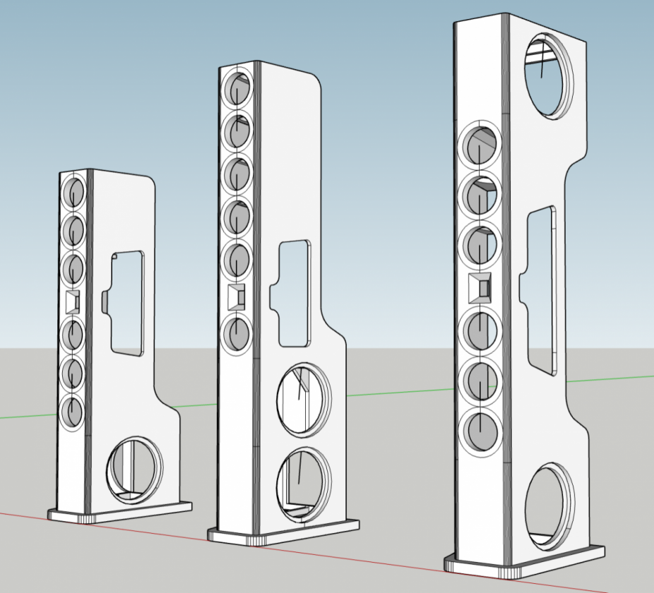

Only managed to finish the dual-sub tower yesterday. Still, they definitely have a more commanding presence, and should be roughly the same height as the NX-Tremes.
I wonder if i can design a version that is based around the Line-Force?  :P
Still a shame they cant really use OB subs in a more appealing way... Actually it might still be possible... But only for a line force model. (Dual OB+subs with a slightly smaller line-force integrated on top?)
I still need to work on the inverted Otica with dual Subs, namely the subs' baracing and connecting slope at the back. Tho I'm curious if it would be more beneficial to keep their spaces separated, or as a single volume?

A dominant presence for sure!  Getting power cable and input signal to the upper plate amp could be a challenge or result in an unsightly mess of spaghetti.  Could a single plate amp not drive both subs?
I imagine you could use cable clips along the rear brace of the open wing to help keep the wiring as tidy as possible.
Yes and no. In my inverted Otica+ dual sub design, both subs will be powered by a single plate amp.
In the tower, the amp is too far away from the top sub to drive it properly, so it needs its own plate amp.

Made progress on the Inverted Otica & dual subs & it's identical in height to the other dual sub tower,  roughly 77" or 7' 5"
The single sub design is closer to 6' 2"
