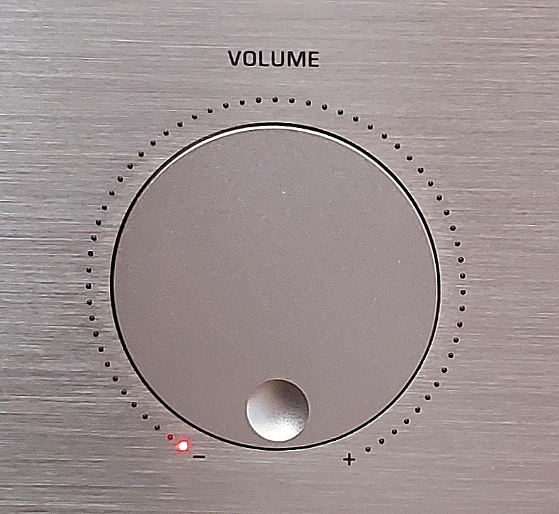

This will seem nit-picky at best, but I personally view the LEDs around the volume control as 80's boom box cheese. I love the industrial no-nonsence look of Bryston gear. This, in my opinion, spoils that look.
...that‘s what i thought when i first saw the BP18.
al.

Like to be able to see a volume control. Sounds like there is a dimmer and way to shut off
Looks like the Pi 4 is fully accessible from outside. Card reader is easy to access. Look into Sandisk Extreme flash cards very fast (gold and red) assuming reader used can support protocol.
I assume connection is internal using I²S protocol? As well as being accessible from outside? Be very interesting to hear a Pi 4b with low noise power by Bryston.
Would the analog inputs be accessible in Asio layer? I would love to record my albums.
Look into adding support for booting from USB instead of card reader for Pi...believe that's now doable would reduce taking cover off there are also companies that make card readers you can attach so card would be accessible from outside. Problem is ensuring nothing is writing to card (erases it).
Don't mind layout on front but would display info be accessible in web interface so if dimmed or off you could monitor from there? Pics are low res so hard to make out details on front.
Look into an Autodark feature so display and volume light up for 10 seconds when used then goes dark. I don't find the other smaller leds distracting but some might, believe you have covered that with off option. Could everything autodark or you choose which banks?

I’d appreciate the visual indication of volume, either through a single pinpoint LED on the volume knob, or with a ring of pinpoint LEDs around the volume knob. I have a Shanling A2.1 integrated amplifier that has the latter, and it’s quite successful. I’ve attached a poor phone-quality photo - it’s better looking in real life (no LED flare, etc.), as it’s functionally useful without being blinding at night (it’s in the bedroom.)
Having user-settable illumination levels, with the option for full-dark, and auto-dark after a defined interval would be great. It’d also be appreciated if the volume LED could optionally be left on (at a preferred illumination level) while the others were dimmed or off entirely. Probably separate illumination control of the volume LED(s) would be best.
The front panel of the BP-18 is very busy, and I’d prefer to see it cleaned up. I prefer a minimalistic aesthetic, while providing all the useful feedback a user needs. I’d like to see fewer rows of buttons & LEDs. Two rows, one for input selection, and one for other functions, grouped sensibly, to the right of the display, matched aesthetically to existing current gear (e.g. BP-17, BCD-3, BDA-3.) The display of sampling rate etc. could then be accommodated in the space to the left of the volume knob, using the “classic” layout as found on the BDA-3, optionally with smaller (pinpoint) LEDs. Choice of LED colour should respect existing Bryston conventions (ideally user selectable) and I’d prefer volume indication to use a distinctive colour - e.g. red for volume, with green for source/function indication.
I’m open to associating the mute button and power with the volume control, but not fully convinced. I’d need to see a revised layout, ideally with a higher quality photo to make a final assessment. It might make sense to have mute and bypass buttons/indicators be the ones associated with volume, and separate the power function. LEDs for mute & bypass (or power) might look better if they were beside the label (on the "outside" relative to the knob) and not between the label and the volume LEDs.
I don’t care for the detail around the headphone jack - there again I’d prefer a clean jack with minimal involvement of the front panel. I’d pair it with a visually similar IR sensor and pair them symmetrically below the display (cf the BP-17.)
I’d relocate the BP-18 PRE-AMPLIFIER silkscreen, as it’s awkward where it’s currently placed and initially looks to be associated with the headphone jack, but offset improperly. It might end up over the sampling rate LED group to the left of the volume knob.

BP-18 aesthetics:
Yes the BP18 has separate pin point LED’s surrounding the volume knob - so only one LED is illuminated at a time.
Yes the LED’s and the Display can have their intensity controlled – from light up my room so I can take pictures at midnight to fully Dark.
The cosmetics and button placement are really an outcome of the best placement of the internal components to optimize noise and distortion. Function before Form.
The headphone jack is like it is because we are thinking about offering a Balanced XLR connector as well at some point and wanted the larger hole available on the front panel.
