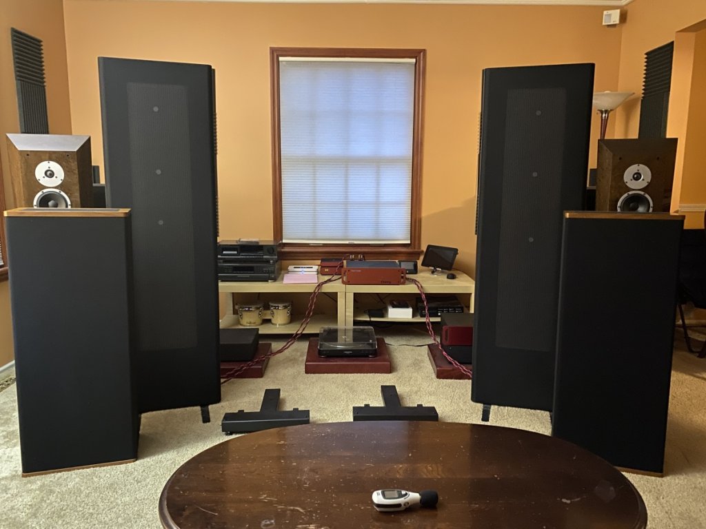

I see Dynaudio Sapphires along with the Vandies
Are the Maggie’s 1.6 or 1.7s?
opnly bafld
Re: Vandersteen 2Ce in the house 😎
« Reply #4 on: 28 Jul 2020, 02:09 am »
1.7i

Congratulations on the vandys. Do you have the bases for them? It’s very important you get the tilt correct in relation to your seating position. They also need very little toe in. You can go on vandersteens website go under 2ce signatures and you can find the chart that will show you how to set them up correctly. Yours may be older but will still apply to yours. I’ve owned the 2ce signature ii’s and now own 3a Signatures , vandys are excellent speakers and even better when setup correctly. One more thing , the more clean watts you give them the better they respond, they love power .

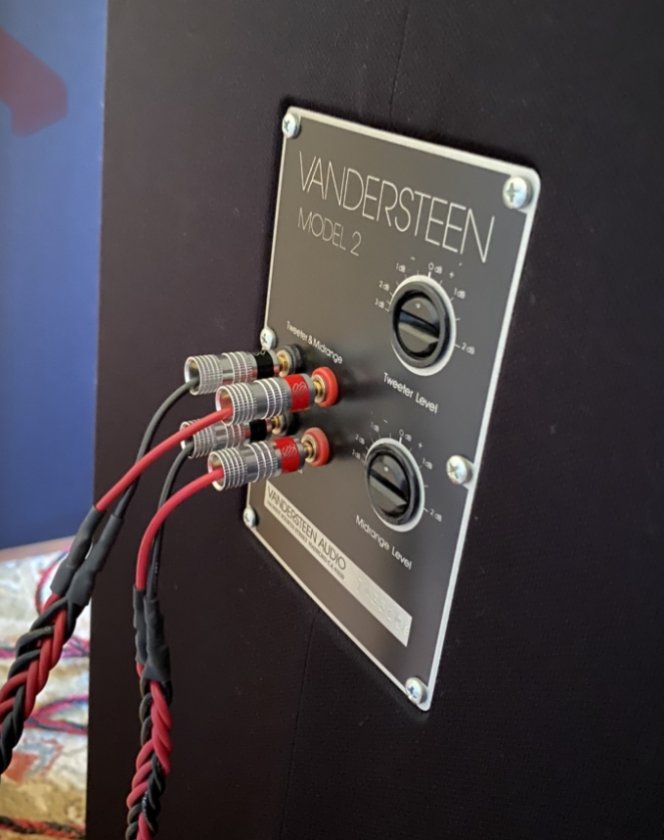

Thanks for the feedback.  I’m really enjoying them, despite a small issue (see above).  Lots of power to drive them here (Cherry MEGA MK2 Stereo currently).
Strangely, mine say just “2” on the back (see photo above), not 2Ce, but the boxes say 2Ce and so does the manual....

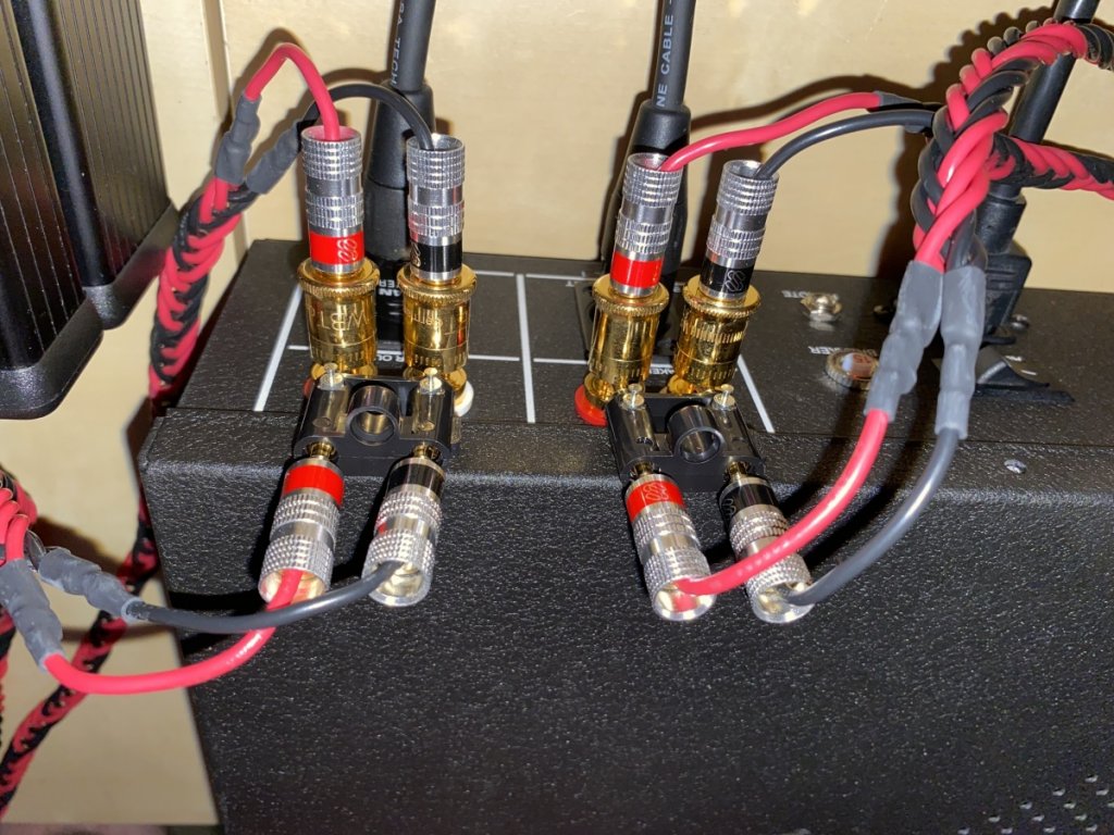

The real issue is getting the damn grill cloth off to take a look.  They should have made the grills removable, at least from the front!  Plus, the connector arrangement creates an additional issue with wiring, so I’m using two pairs of 8’ Cherry MEGA Snakes (9-gauge equivalent), but that’s another story.
