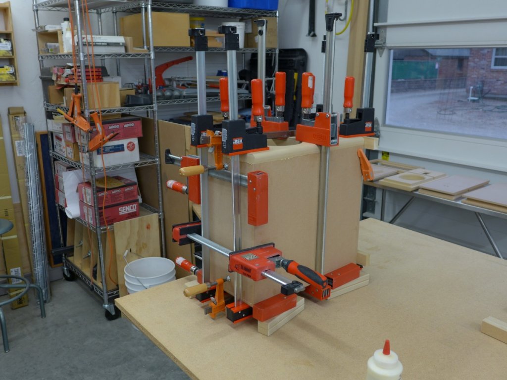

 I glued up first cabinet tonight. After puzzling over it for a while, I worked out a system to get it comfortably done in one go. This kit is really well thought out and deadly accurate. Assembled this way it makes for a highly integrated and strong structure.
 It's clamp intensive as you can see. It will raise your woodworking game!
 I think for video, I'll dry run it on camera, then take apart and final wet assemble, which I would absolutely recommend.

Wait... Is that 12 clamps???  :o

who that's buying a flat pack has 12 clamps though?   :duh:

I've got 12 clamps but I don't have a table saw or sophisticated enough wood tools to do a lot of the woodworking.  I sure can't do it as nice as the CNC cut flat packs!  I'm not sure that 12 (!) clamps would be essential though. (?)

« Reply #71 on: 20 Aug 2020, 03:27 pm »
Heck he didn't even use all of them!  :D
