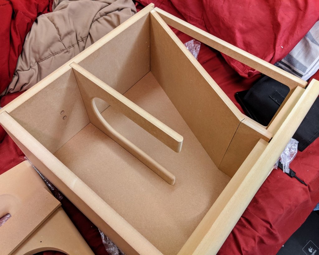

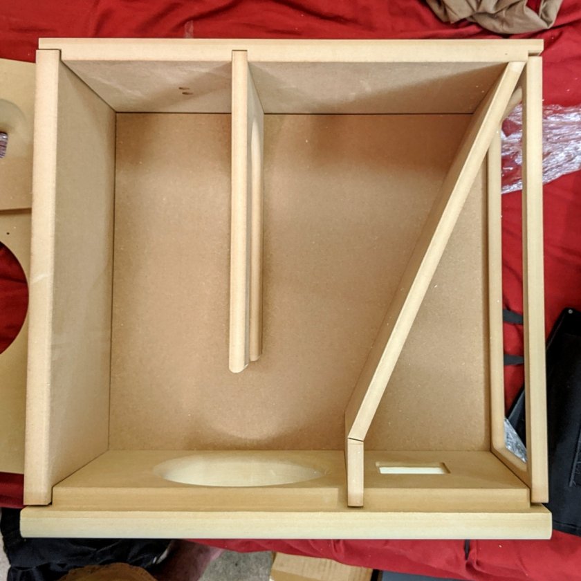

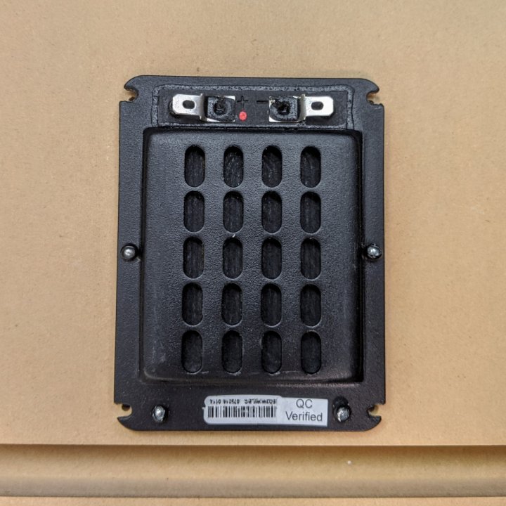

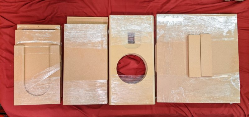

Okay! I'm home & have the flat pack out, its in perfect shape, plenty of soft foam on all sides to keep everything safe and in place.  Thr cuts are also super clean. :thumb:
I also test fit the BG Neo3 I have on hand, mostly To check the clearance and fitment. (Including the little 3D printed bars)
I also did a dry test fit for ideas on how best to assemble it.
Its probably a good idea once test fitment is done, to mark the bottom of the slope as well as each left and right panel to make sure I have their position and orientation correct when it comes time to properly glue them together. Cuz I put the slope in upside down & backwards the first time. :P
My next step will be to get some clamps, glue them together and seal them with shellac. (I assume its okay to put that on before i apply the veneer to the sides/back? Or only to the parts that will be painted?)
Thanks Jay for the flatpack! These are perfect! :thumb:

Yes, if you guys find the long, angled divider angles don't work, spin it around... only fits properly one way as the angle at the "bottom" is split with the angle on the rear of the  short brace (tweeter floor). Pretty hard to get the side panels backwards  :)
And, as I mentioned in an email, I did overlook something with these initial kits and will fix it in future runs....  you guys who got a pair of these will need to drill  a small hole in the short divider to pass the tweeter wires through... should not be a big deal.
jay

My flat pack arrived also, looks very well made. Did a quick dry fit of one speaker, this going to be very easy to put together. Nice work Jay and Don, but what I was really impressed with is the packing you guy must have spent more time figuring it out than you did on the speaker.

Ye, for my own sanity I still marked the slope & sides & it's directions, cuz I'd rather get it right the first time, esp once I'm ready to glue/clamp. :P
Not too worried about the missing wire holes, cuz I've got my own drill & bits. But it's definitely a good thing to point out to anyone who got this initial run.
Hoping to get the clamps & glue tomorrow & start getting them mostly assembled aside from a side panel so I can install the norez easily once it arrives, then focus on sealing the MDF and doing some research & practice passes for veneer, staining, sealing etc before I move onto apply those skills to the side & rear panels.

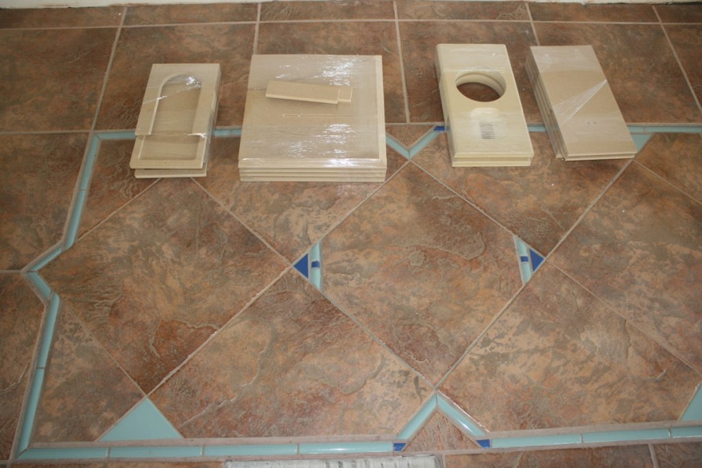

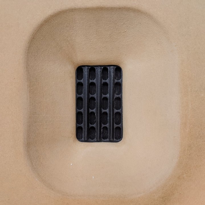

Ok,  we finally  cut the initial  run of these  ( 8 pairs remaining as I type this).   We'll cut more if  there is interest.  These came out really nice.. Rabbets for all outer panel joints,  dados for  internal bracing/divider  and a full rabbet around the top for the included grill frame.  Driver mounting screw pilot holes pre-drilled,   .5"   vertical  roundover on  front baffle edges and a nice  radius on rear  side of woofer cutout.A .125"  pilot hole  is pre-drilled in the grill frame for easy istallation of a small cabinet knob  if desired.
Baffles with waveguides and backside operations take considerable  time to cut, they are cut from   solid 1.5" MDF , same material as our  sub kits use.  Not  your typical box store  MDF
Remaining outer panels are  .75"  Medex  and  internal bracing/dividers and grill frame are .5" Medex.
Boxes   were ordered this am so no final shipping  weight yet.
Price    is  $369/pair +  shjipping.
