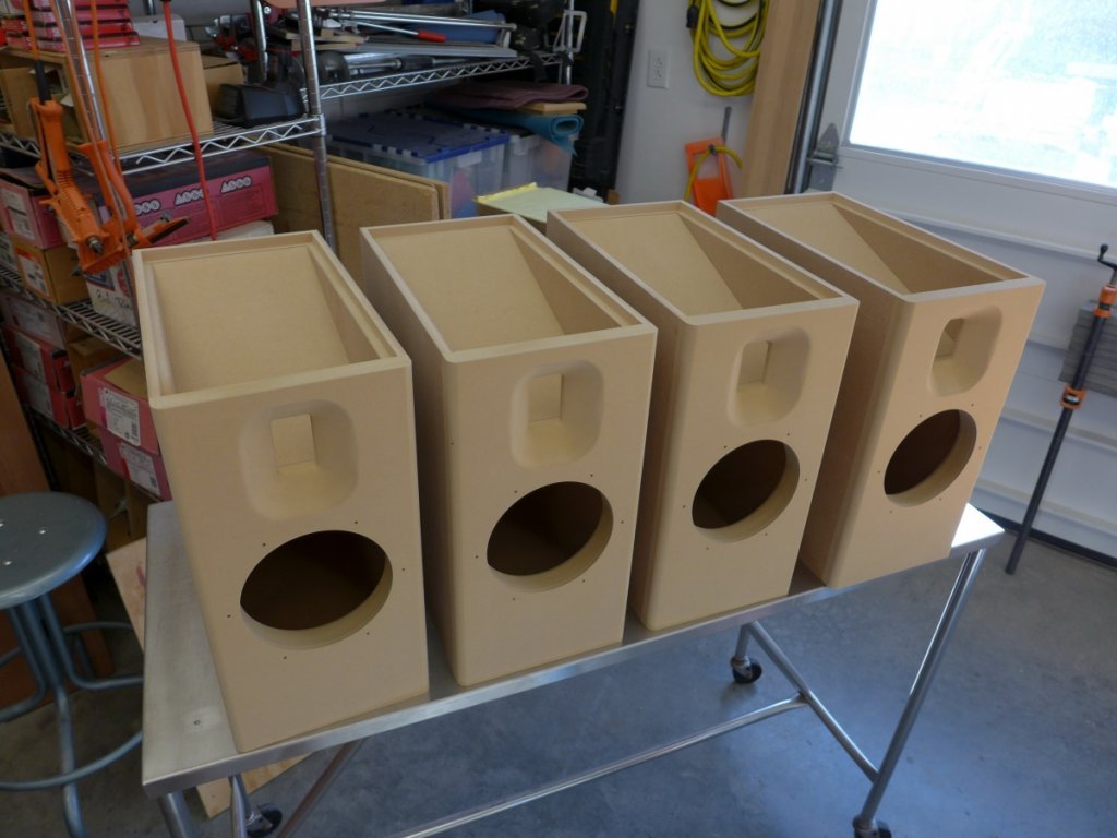

Here's a quad of Jay's NX Studio flat packs I'm assembling for two different people. I installed machine screw inserts which I mentioned earlier in this thread, although these differ from my original post about the worthwhile mod where I installed screw-in inserts. I believe fltguy did these same inserts after I mentioned they looked even better for the job. I like these better for what they'll be tasked to do.
Which screws / bolts did you go with?

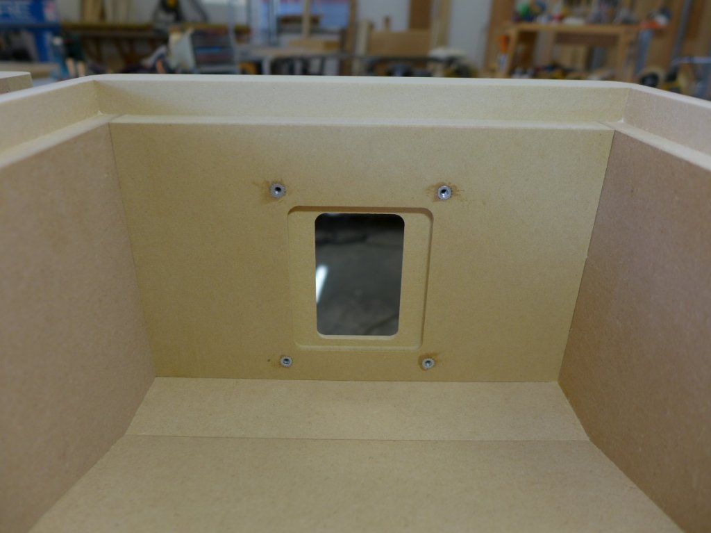

Peter,
I took your advice and installed these press-fit inserts from McMaster-Carr. These are zinc-plated steel inserts, 4-40 thread size, were originally designed for soft metal.
Using a 7/32" drill bit, I drilled a 7/16" deep hole. Some epoxy and gentle coercion I got eight of these installed without a volcano.
And a bump to post I made reference too. After doing it myself, I do think it's a good way to go, and fairly easy with the pilots already there.

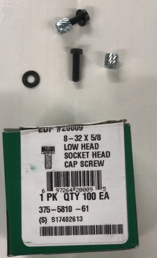

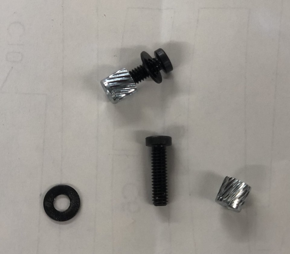

Last week I sealed up my NX Studios. I affixed the woofer drivers with 8-32 press fit inserts with low head (low profile) cap screws with black oxide thin washers. A small amount of medium (blue) thread lock on each screw made me feel better too.
It's a simple and elegant solution for this application.
My thanks to Peter for planting the seed for this idea. It worked out great.
