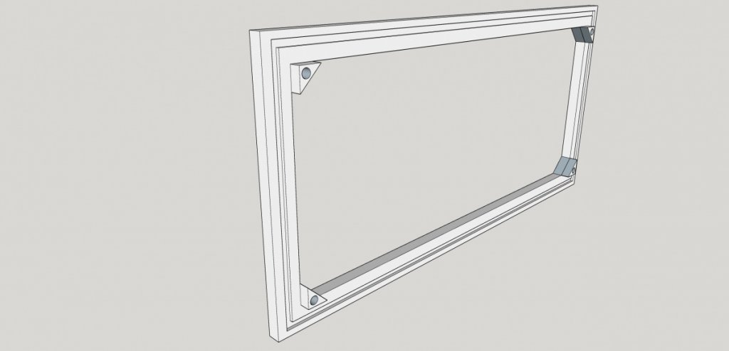

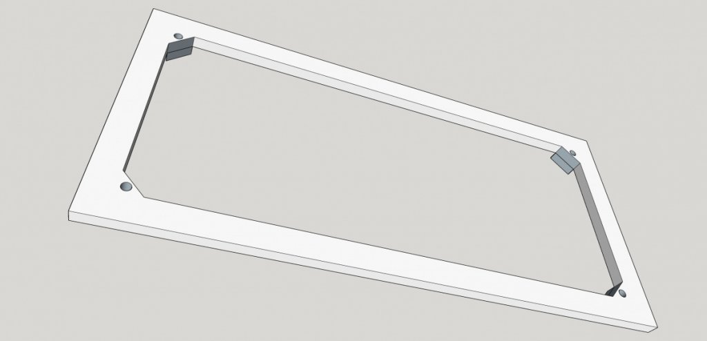

The protruding woofer frame presents a problem. My solution is to stand the grill frame off baffle enough to clear said frame. I cut basic frame from 1/4" MDF but ended up laminating another 1/8" ply to stiffen it up.  1/4 x 1/4" Neo 52 magnets imbedded in baffle and glued into frame. Thin felt pads on "legs" of frame so as not to scratch baffle.
I attached cloth with staples in the  groove you see on back. Outer dimensions were 7 5/8" x 16 1/4" with a 3/4" frame width. Sized to fit a rounded over top and square bottom. They will certainly interfere with tweeter dispersion and were intended as static protection only.
Client paid $200 additional for them, and if I'm honest I have difficulty seeing the value proposition. WAF has never been a concern for me, even when I had one, but your situation may be different.
You may want to reference my X-Otica thread for photos of a similar installation.
https://www.audiocircle.com/index.php?topic=139529.0
I quickly drew these so you can get a visual on what I'm talking about.
