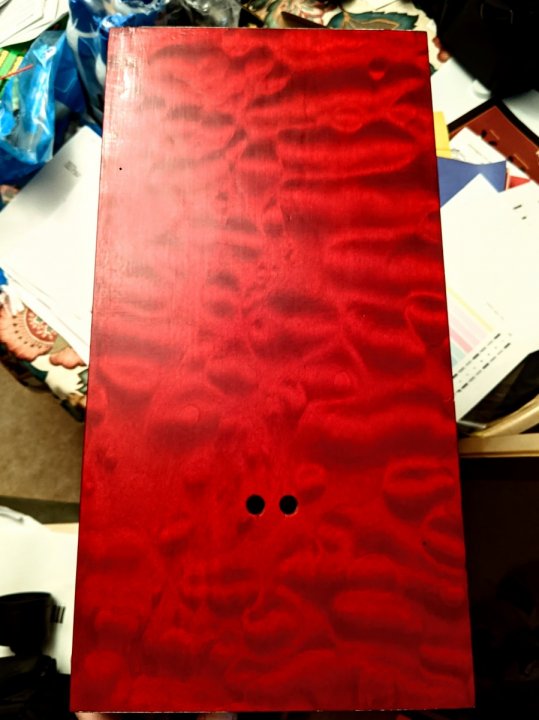

I didn't, but you can do whatever you want. I just painted the backs black. I veneered the side panels before assembly. The back will have to be done after the boxes are put together.

I veneered the backs of mine.
