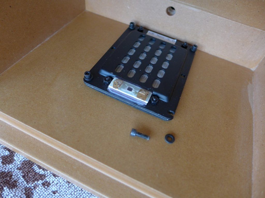

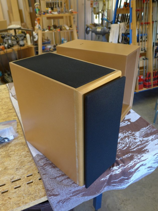

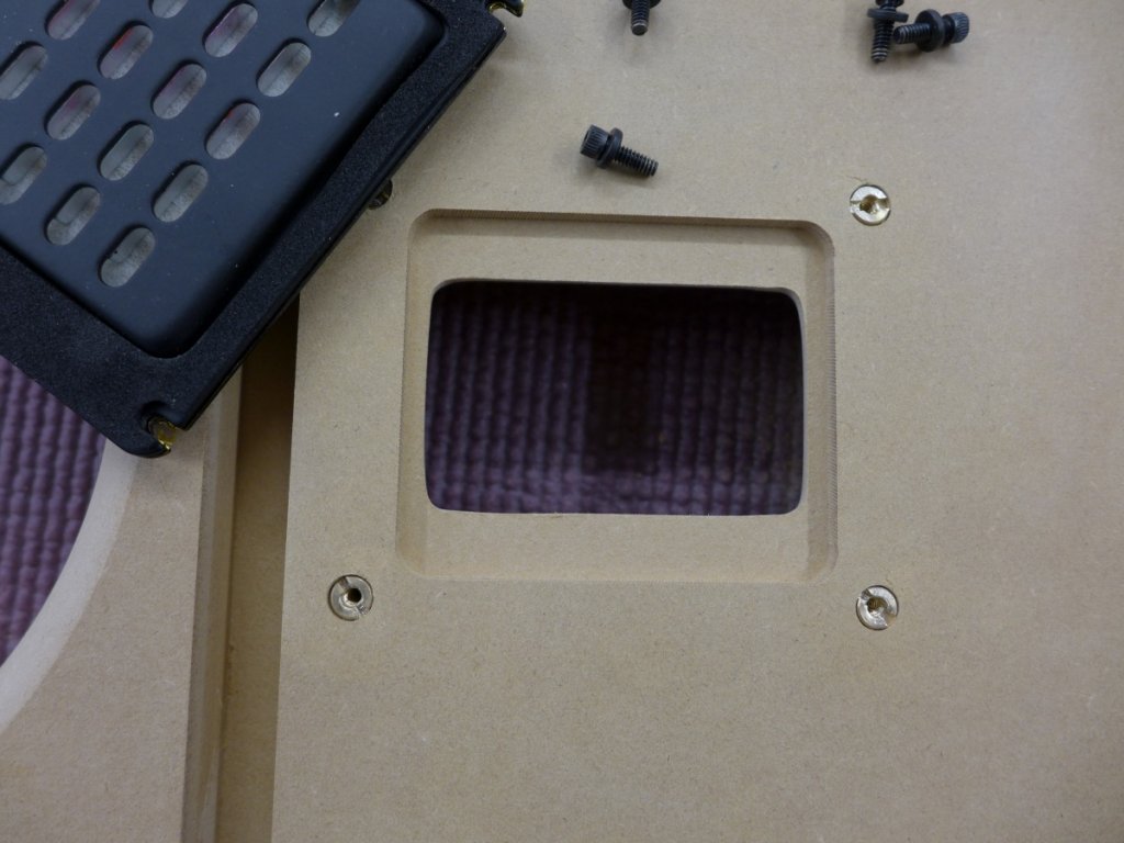

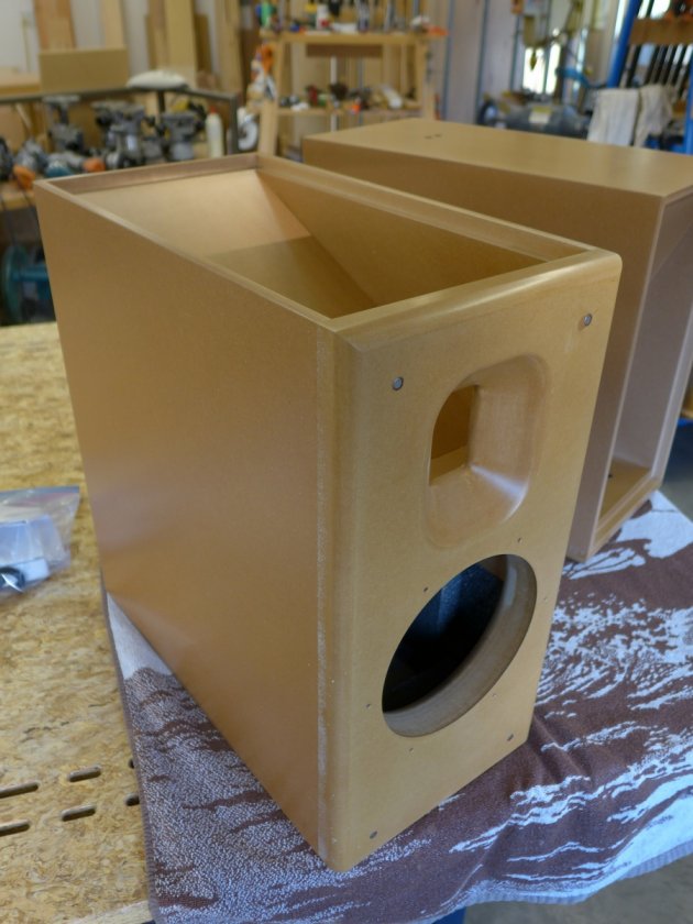

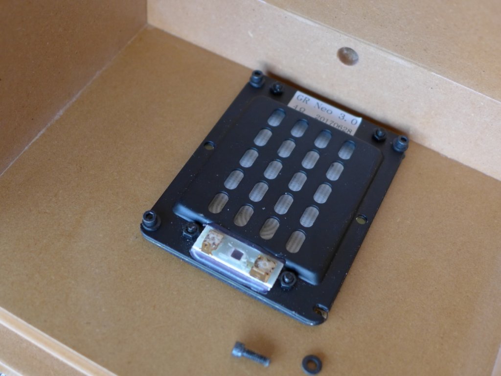

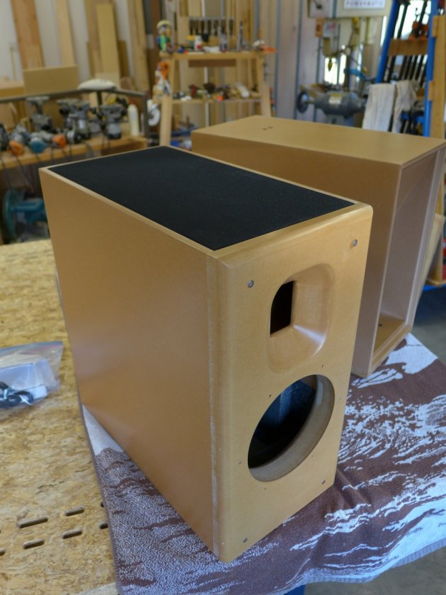

Here's some (I think) interesting stuff.  I'm assembling and prepping these for wrapping. Not being keen on using tapping screws to mount tweeters and questioning if I can thread a #4 machine screw into MDF effectively, I used screw-in inserts. I'm jazzed about the way that worked out. Also made some magnetic grills for fronts. Cabinets are clear sealed in preparation for wrapping.
Before cabinet assembly:
After assembly and sealing:
With and without grill:

Can you elaborate on the wrapping?

I'm curious why most tweeters I've seen for these are mounted with the connectors at the top.  Is that the only way the tweeter fits?
I like the threaded inserts, btw!

Concerning wrapping. The same material cars are wrapped with. Some is patterned off the roll, some can be printed on...photos, graphics etc. These are heading to Florida as you see them. I'm don't know what end look will be. I left a baffle at local shop for them to experiment with. The waveguide being the main concern. As far as I know it's kinda uncharted water for speakers.
Digi, conceivably one could mount with connectors at bottom, but the entry point I chose for wiring would make for some pretty awkward hookups to tweeter, so this is the path of least resistance. I imagine wiring sprouting out of  hole and going around tweeter to top.

I like the the screw-in insert with socket cap machine screw. Did you use EZ Knife threaded stainless inserts for hardwood?
Thank you for your detailed posts, I am taking notes as I await my flat pack for the Studio Monitors.
