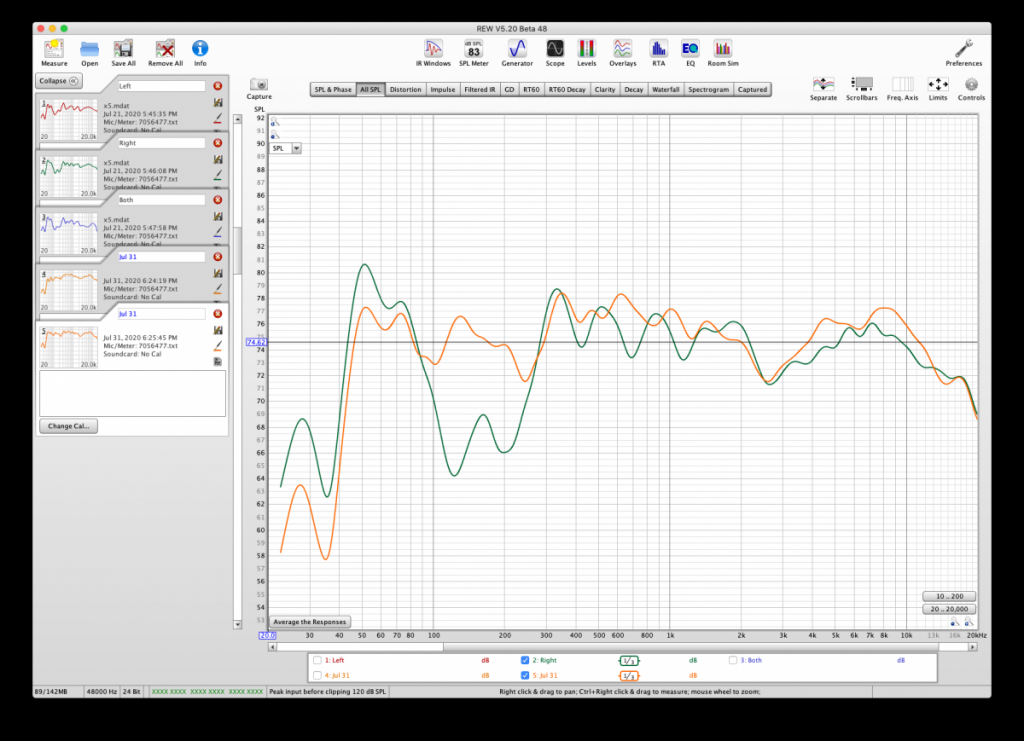

I'm finding bass traps to be beneficial. I had a huge hole between 100-200hz and the low bass is lacking with my X5s. The room is a little challenging, the main area is a little less than 13' x 22', but it's open on one side and in the back to another room. After discussing with Clayton, and with GIK, and after some research, I tried a few things. Clayton and GIK cited my rooms modal response as playing a role, and suggested bass traps as the first step.

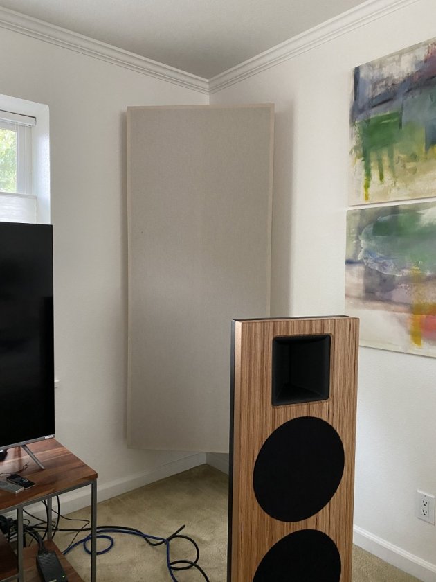

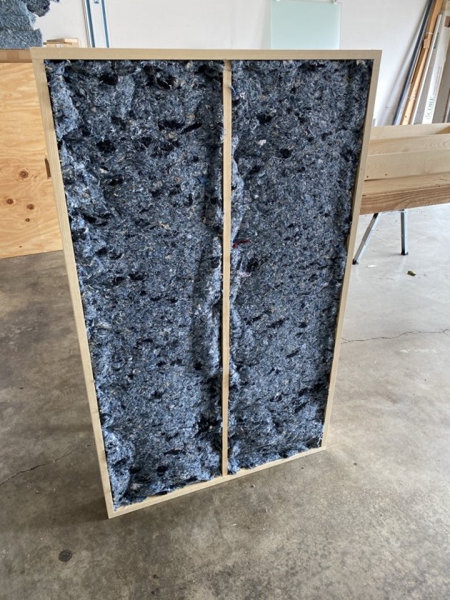

So I built some traps and tested them out on the front wall, and I'm happy with the results so far. Below is a photo of the traps (excuse the fabric, it's temporary), they are 30 x 72 x 6 in, filled with R19 UltraTouch recycled blue jean insulation. Then on the back I attached a 2x4ft piece of rigid fiberglass, centered on the lower part of the trap.
You can see in the REW graph below, measured at the listening position, the response smoothed out a bit, notably filling in some of that 100-200 crater. I plan to build two more for the rear of the room and test again. Edit: I also note I turned down the subs a bit for the measurement with the traps, so it's not exactly apples to apples. I didn't save the other measurements, but it followed along pretty close with the green line below 50hz before I turned it down.
Here's one of the traps installed.
Here's the graph, green is before, orange with traps.

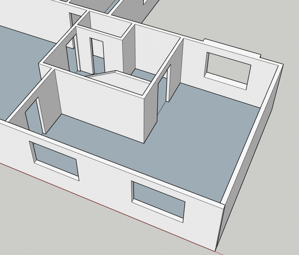

Here's a sketchup model of the room for reference.
Very interesting thanks. What were the theories as to why you had that big black hole in the frequencies?

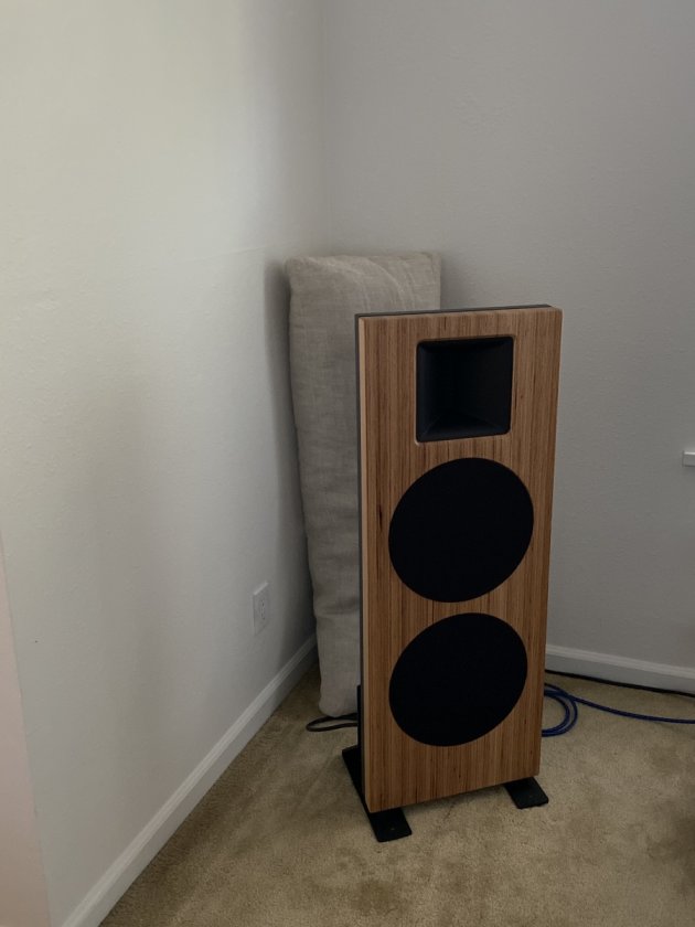

Room modes, boundary reflections and speaker position. FWIW, the first thing I did was move the speakers around, I tried everything short of moving the whole system over to the long wall. I even put them up against the wall to try and minimize the front wall reflections. That did help the response and actually I got the best results by corner loading the speakers with more extreme toe in, crossing in front of the listener. The sweep looked similar to the orange line in the graph I posted, the 100-200hz null was smoothed out.
Getting a time out in the corner. If you're wondering, placing the sofa cushion there was worthless.

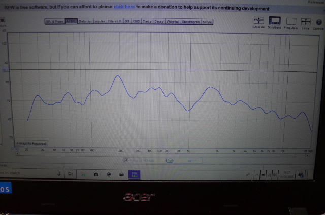

Attached is a picture of the REW scan at my seating position (3 way OB). I am very happy with the sound at present but will be tweaking the room, seat, and speaker positions to try and flatten this a bit.
What I find difficult is knowing whether its the peaks or the troughs that are the anomalies.
Out of interest I know my mid ranger is measured by the manufacturers as flat from 100 Hz to 10 KHz, almost certainly in an anechoic chamber. So everything I measure is down to something I have created in the OB or room.

Your measurement is not bad.
Mine ... with and without a basic EQ.
Start with 20dB swing to 10dB swing
I can do +-2dB with Acourate
The position of the speakers is to have the best image ... not the best frequency response in your room.
With 3 pts of EQ, you can have something pretty sweet.
What matter the most is your room resonnance.
Do the waterfall with my param to see how your room resonance is actually.
My room have basstraps and panels but it's a small bedroom.
I have a mode at 60hz probably because I have nothing on the ceiling.

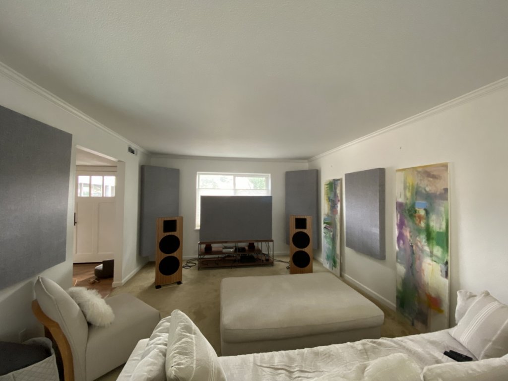

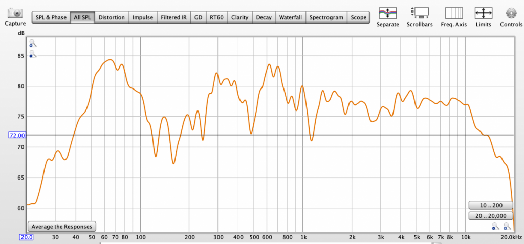

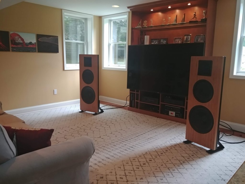

JTF - your room is my room's doppelgänger. I have the X3s in a basement room that is 14.5x22 (7'7" ceilings); has an opening to the back and to two sides. Perhaps unsurprisingly I have the same null and I'm exploring room treatments with GIK. You didn't end up purchasing treatments from GIK? Can you describe what put you on the DIY path? Also, how far off the front wall (wall to front baffle) and side wall (wall to side of speaker) are your X5s?
Thanks!
Thanks!
Mike

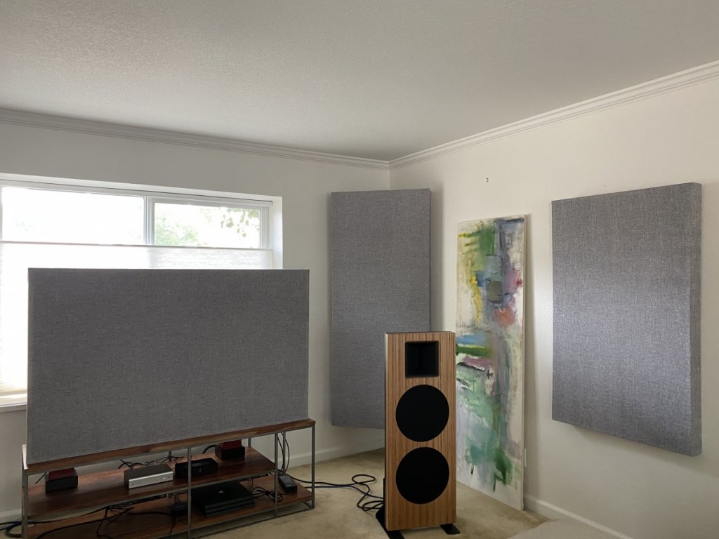

Mike, I looked at the GIK panels, but ultimately decided to build my own for a few reasons: I wanted custom sizes. Variety of fabric and the ability to change the fabric easily. Also these panels may be temporary, I'm planning to gut this room down to the studs and build the absorption into the walls and ceiling. Cost wasn't really a factor but it is cheaper as well, the material cost for 4 bass traps, the TV panel and the 2 side panels was less than $250. I also enjoy DIY.
Right now the speakers are 55 in. from the front wall, measured to the center of the baffle, and 22 in. from the side walls to the edge of the speakers. The speakers are 78 in. apart edge to edge.
Since my earlier post in this thread I've built and installed 5 additional panels. 2 bass traps in the rear of the room (not shown), same size as the front 30 x 72 x 6. A free standing panel to place in front of the TV, 60 x 36 x 4in, and the side panels which are 30 x 48 x 4. I also rewrapped with a different fabric, and I stuffed more of the recycled cotton insulation into the bass traps. My main takeaway so far is that surface area and the depth of the bass traps needs to be significant to improve the low bass.
Here's the room right now:

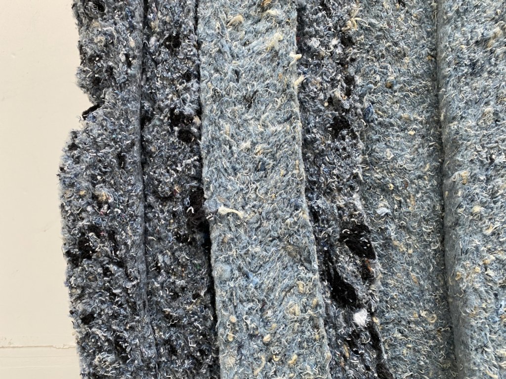

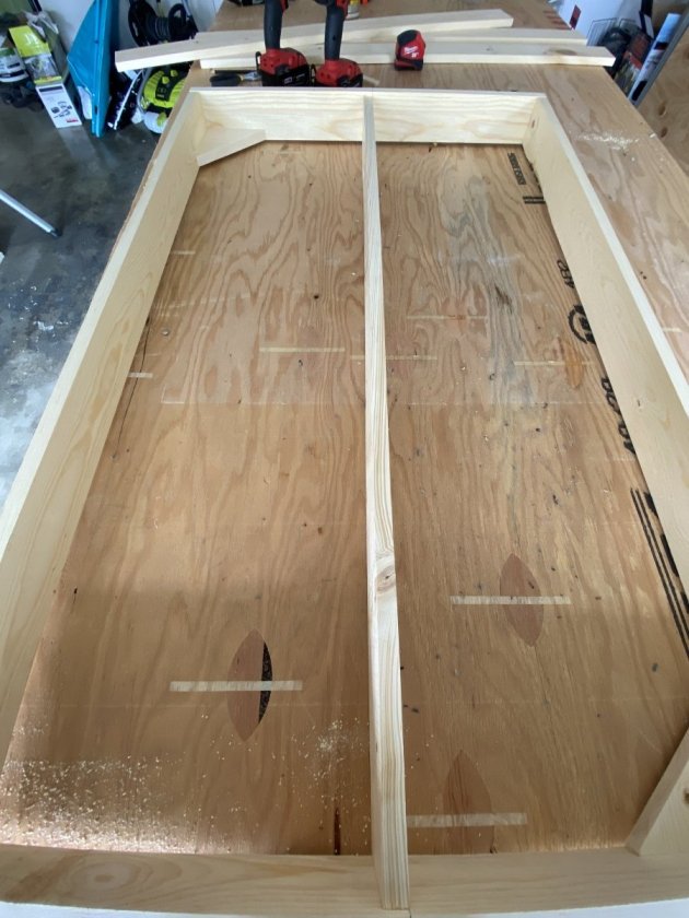

Here's some pics of how the panels are constructed, it's very simple. I used cheap 1x pine boards, recycled denim insulation batts, R13 for the 4in and R19 for the 6in deep panels. I covered the backs with landscape fabric, then wrapped the fronts. The batts are sized to fit inside typical 16in oc wall studs, so I added the central supports. This is also why I used a 30in width for most of the panels:
The R19 is only slightly thicker than the R13 but much denser, the lighter blue batts in the photo are the R19. If you compress it slightly or leave the backing off the R19 will fit in the 4in deep panels. I may swap it out in the future. I did remove the backing from the bass traps and they now have a layer of R19 and a layer of the thinner stuff.
