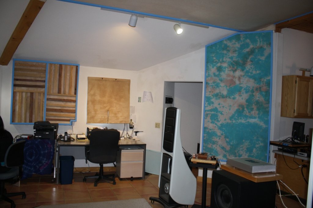

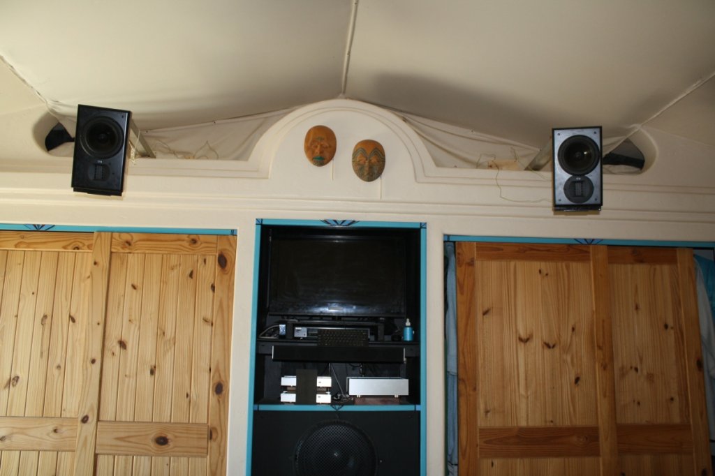

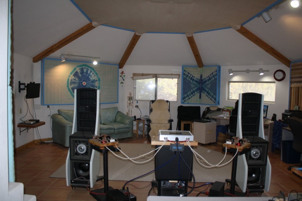

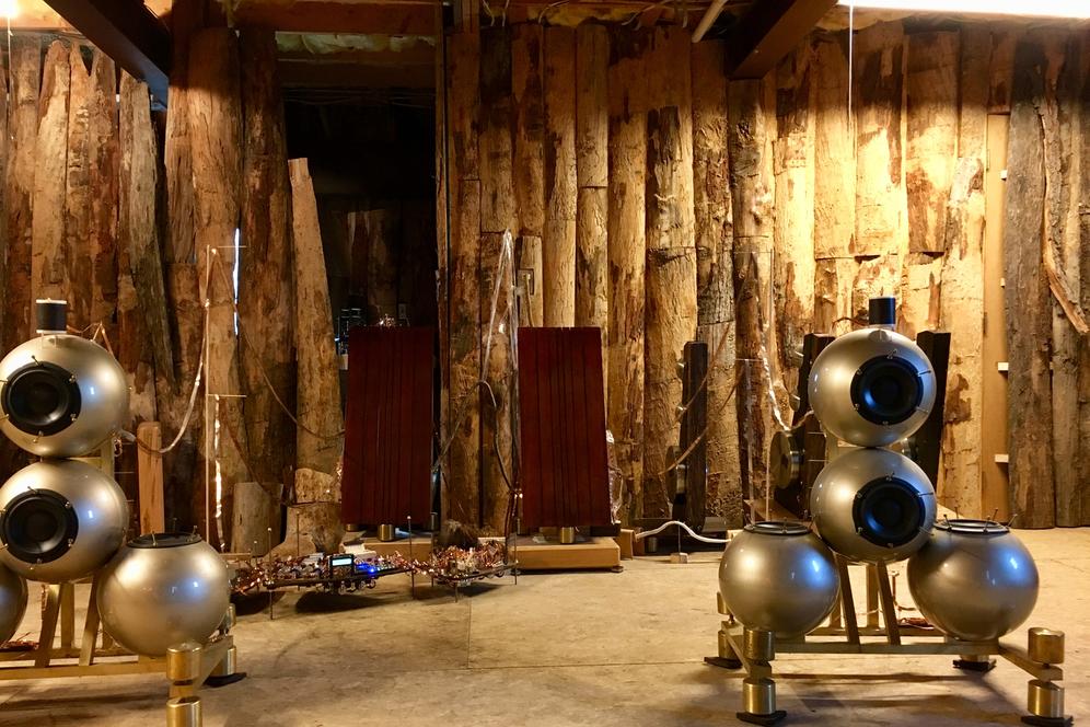

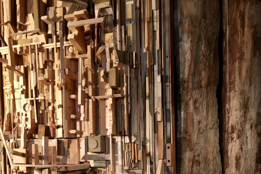

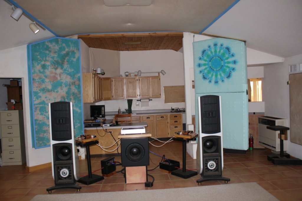

Here a some pic of my treated room  with my OB super 7s. the panel on right is P I audio the rest are a Jeff Hedback design panels with DYI ceiling cloud and bass trap in upper back left corner. Also all windows have heavy insulated window coverings.
Made a big difference in the sound stage

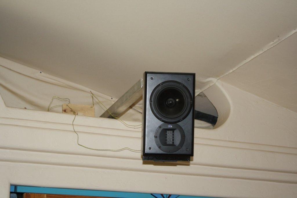

I’m about to change speakers in my bedroom system. Right now I have GR Research N2Xs and I upgrading to GR Research Studio Monitors, which have an OB tweeter.
I have only one place for the speakers to go (see pics ). With the N2Xs at Dannys suggestion I mounted the speakers upside down, which has worked well, sound stage is high but other than that sounds good.
Now with the new Monitors I will have 18”-20” from the ceiling to top of speaker. Should I hang the new speakers upside down or mount them right side up and put some acoustical treatment on the ceiling.
The trouble with trying both is I have to have a special bracket made for each way and don’t what to that if I don’t have to.
