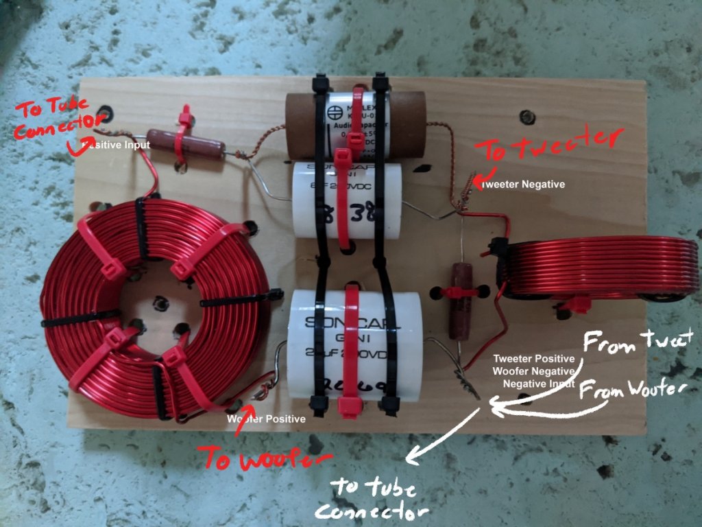

Here is the crossover with labels for the wiring. Danny confirmed this is good.
This is awesome, thank you!

When Building the Crossover you need to be concerned about orientation of the coils.
Danny sent this:

@daveshear
In your picture of your crossover, what gets connected to the positive input in the upper left?
daveshear
  • Posts: 28
Re: NX-Studio Build *** No Clamps or Shop **** Shear
« Reply #49 on: 1 Aug 2020, 02:02 pm »
@daveshear
Tomy2Tone, the "Inputs" are connected to your "Tube Connectors" which are connected to your amplifier
I see, so the positive input in upper left is for the positive speaker binding post  and lower right is for negative speaker binding post along with tweeter negative and woofer positive. Thanks!
Not quite, the input in the upper left feeds both the woofer and tweeter circuit, which breaks out to independent positives for each driver. Then the negative leads from the drivers connect to the negative ends of both the Woofer and tweeter circuit, and continues down to the tube connector or binding post.
So the upper left should be labeled tube connector/binding post positive input along with woofer positive and tweeter positive?
Tomy2Tone, Danny CONFIRMED my labeling. I think you are getting confused by the last comment.
No, the upper left connection is the input from the tube connection, which feeds the signal to both halves of the crossover circuit.
Upper right is the crossover output to the tweeter.
Bottom center between the large inductor & bottom sonic cap is the output to the woofer. Then the two connections in the lower right are connected to the negative leads of both drivers and then to the negative/return tube connector.

Hopefully this will make more sense :thumb:

@Hobbsmeerkat
Thanks, I think that’s what I was trying to say originally. Then I probably misunderstood what you were trying to explain.

« Reply #59 on: 2 Aug 2020, 12:18 am »
