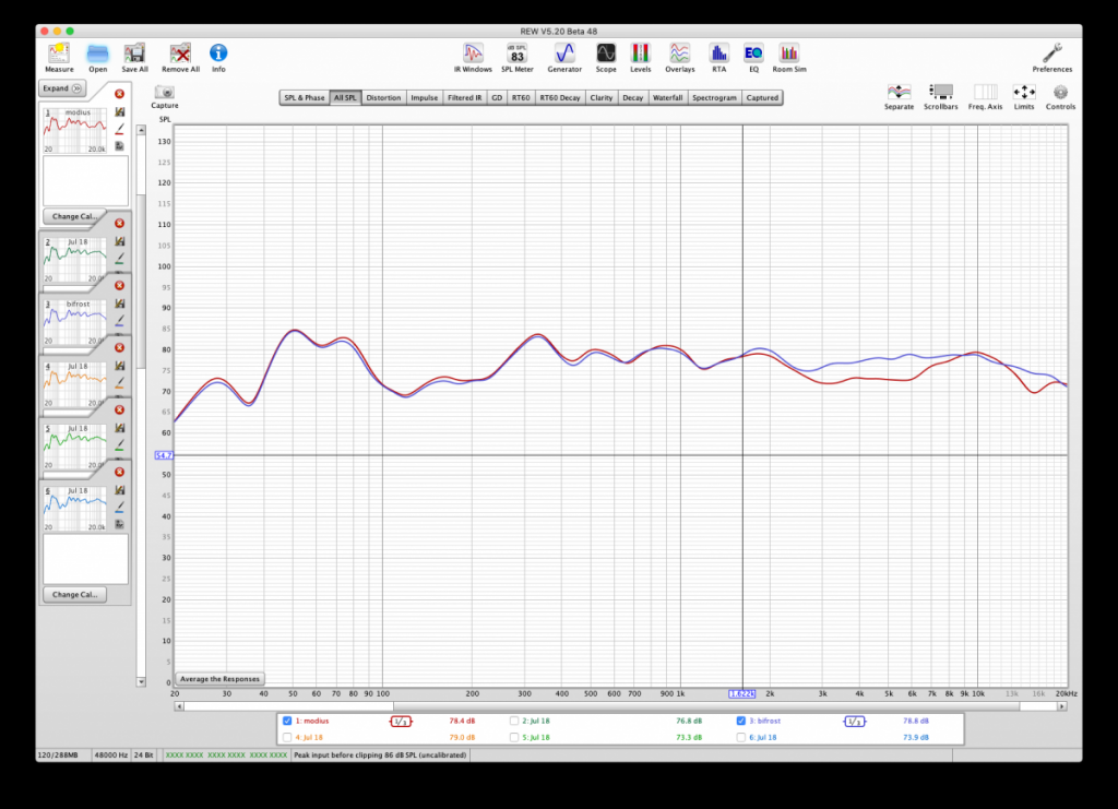

As for the measurements, you can see below that they are different above 2k. The red line is the Modius, the blue is the Bifrost.
I took measurements using REW, at the listening position. I repeated it multiple times to make sure the results were the same. The only difference was the dac in use. My room is 13 x 22 and the chain for this was mbp > Schiit DAC > Jotunheim as pre > Cherry monoblocks > Spatial X5s. The Spatials are ~4.5ft from the front wall and the listening position is 10ft from the speakers. The measurements should be taken with a few grains as I'm a REW noob.

And the fact that your vertical range is 130dB and 1/6th octave smoothing on the horizontal which makes the graph look overly smooth. I wouldn’t use in room measurements generally to illustrate differences between dacs, as there are too many variables. Sometimes small disturbances in how room reflections are captured by the mic can make things look worse than they are. But your measurements do make me pause a little. If you changed the vertical range to just 50dB (ie 40-90dB) the differences between the dacs would look more alarming not less (in the area above 2khz). *The other thing is if you measured BOTH speakers at the same time then your measurement is distorted due to comb filtering issues between each speaker, and between each speaker and the respective boundaries that particular speaker is surrounded by*.
Unless there is something functionally wrong with one of the dacs there shouldn’t be an FR difference between the two whatsoever (especially in that frequency range).
Schiit has been known to not have the best QC, and units have been sent back only to find out it was defective in the first place. See the Schiit Freya review on ASR to see an example. I am not making this up...Once fixed, the unit performed as spec’d.
Actually, if I were you, I would ship both back (or at least email/call them) and ask them if they truly do have identical or nearly identical FR curves. There shouldn’t even be a 1dB difference in the range of 20-20khz. They should have measurements of your particular dac units on file. They do have an Audio Precision analyzer.
If they do have identical FR measurements per Schiit then I would think small disturbances and comb filtering issues are the reason for the differences in the in room measurements particularly above 1khz. The way to mitigate that is to measure each speaker individually and then compare the dacs. Like Modius/RCH, Modius/LCH, compared to Bifrost/RCH and Bifrost/LCH.

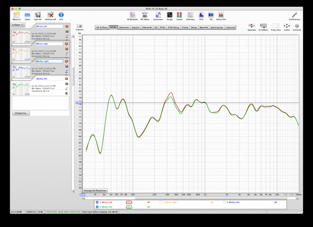

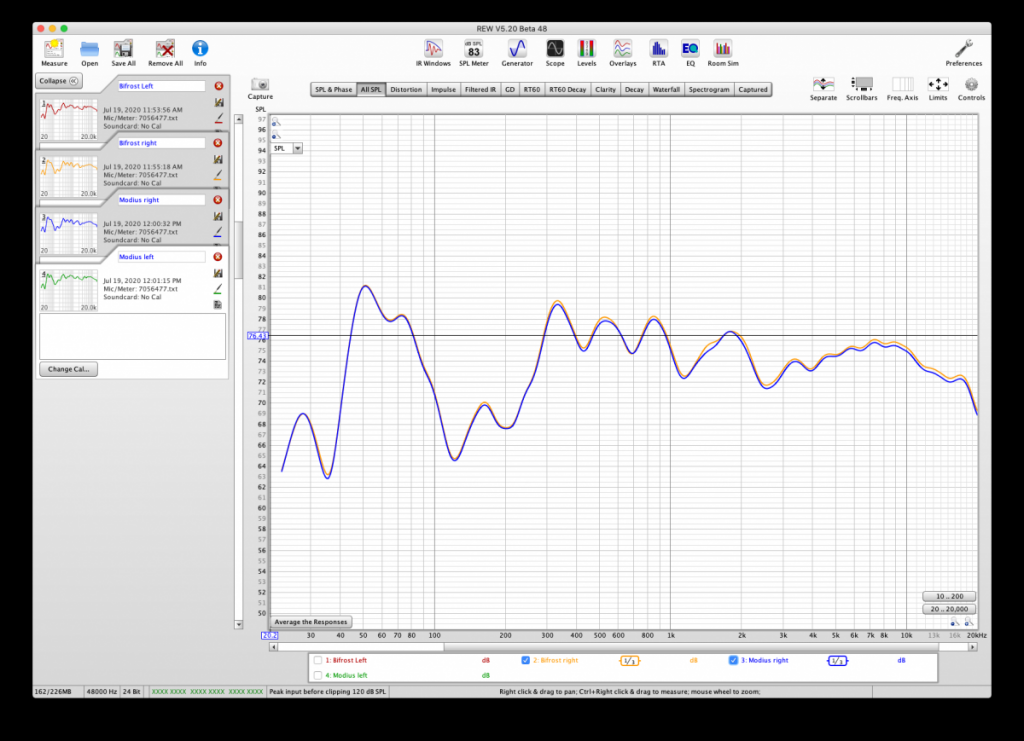

Thanks for your input Anand. Yes, it appears that measuring both speakers at the same time was the problem. I measured again just now, L and R separately. I measured each multiple times and threw out the duplicates.
All together
Right channel, Bifrost orange, Modius blue
Left channel, Bifrost red, Modius green
