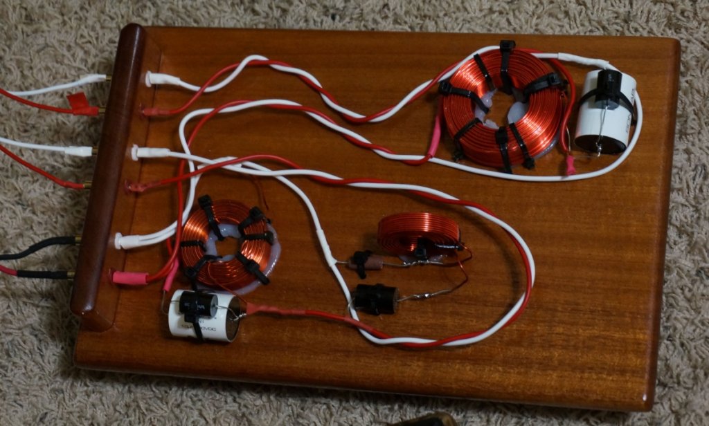

It's time to upgrade the crossover for my NX-Otica MTMs. The current crossovers are no slouches, Sonicaps with Sonicap Platinum by-pass caps, Mills resistors, and Erse XQ- air core inductors.

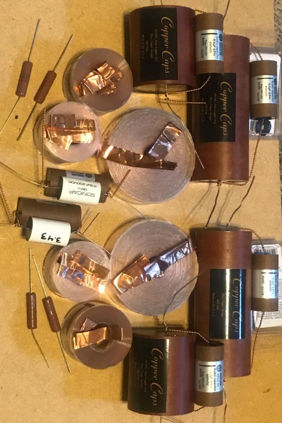

The new crossovers are going all out, Copper Caps with Miflex KPCU by-pass caps, Sonicap with Miflex KPCU by-pass cap in the notch filter, Mills resistors, and foil inductors. Here are the new parts
