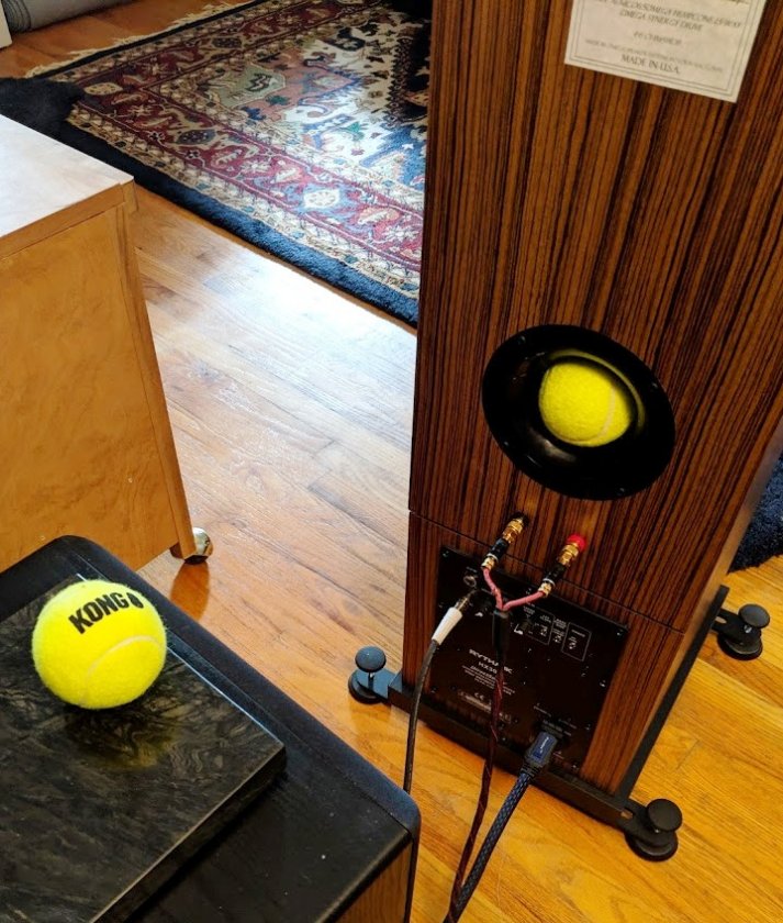

I simply stuff the ports with large tennis balls I found in a pet store.  The simple conclusion is that bass (mid-bass) is tighter and more defined while unstuffed is looser bass.  As I use Rythmik powered woofers and subs, both servo, the bass below the omegas is very tight and defined.  Stuffing the ports makes for a good match and much better sound in the low end to my ears.  It has also seemed easier to blend the bass units with the mains than when ports are open.
.......Pete (who is about to pack up my system this week for a move to WA  :o)
This was exactly my conclusion with my B&W 805's.  With the port open I got a bit deeper bass, but it was loose and I could hear it.  With the port stuffed the bass is tighter and sounds more controlled.  The 805s offer a foam plug to use, so it's not necessarily going against the designers intent.  Mine are paired with an SVS subwoofer, so squeezing those lower frequencies from my main speakers didn't mean much.
And like others have said, it's easy to try, reversible and doesn't cost much.  In my case it was an improvement.  YMMV.
