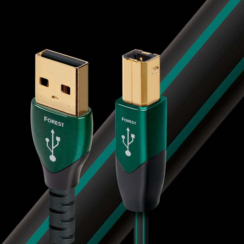

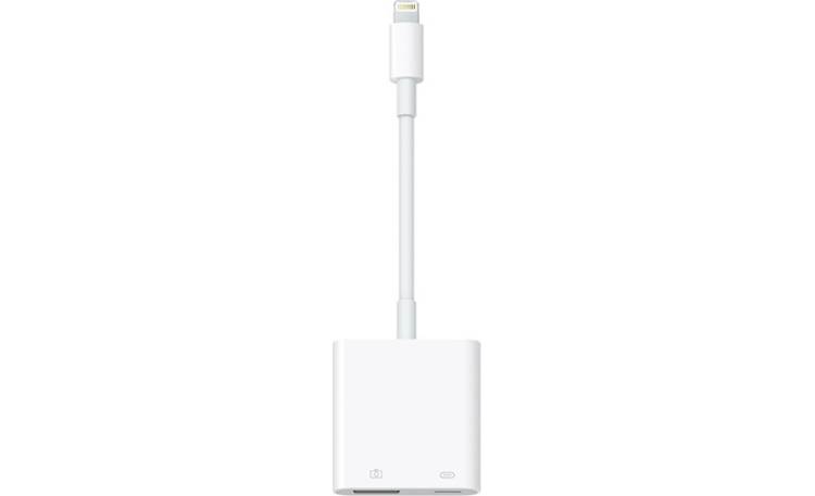

The way I do it is use an Apple USB camera adapter (basically a lightning port -->USB A)  to connect to a USB A -->USB B terminated cable -->DAC.  IOS knows its going digital out.

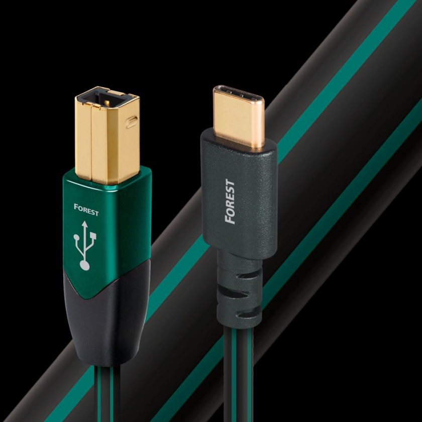

The new iPad Air 4 doesn’t have a Lightning port anymore but a USB-C port. What is a good adapter for the connection to a DAC?
WillyP
jobiwon
  • Posts: 181
Re: Bryston Manic Moose Interface
« Reply #235 on: 27 Oct 2021, 02:42 pm »
AudioQuest makes a C to B cable as well.

Being an iPad Air 4 you will want to ensure the https://mfi.apple.com/ is supported or it might be frustrating experience.
Personally I use the AudioQuest cinnamon type a to type b cable with the apple adapter. Less chance of trouble, feels like its heading back to the BlackBerry days when only a companies cable supported headsets, charging, etc.

The other advantage to the Apple Adapter is that some of them have a lightning port on the "A" terminator that provides power.  I have a little audioengine D1 headphone DAC that will not run off the battery of the iPAD.  I been thinking about trying one out to see if it will power the DAC.
This perked my interest so I called AudioQuest.  The Lightning port/Adapter was proprietary (chipped).  The USB C on the Air is not and no longer requires that adapter.  I just realized I have a buddy who just last week purchased a brand new Air and a AudioQuest C to B cable.  I just reached out to him to see where he is at with it.

..........so does that mean you can buy the Audioquest cable and hook directly without using the camera connection kit?
jobiwon
  • Posts: 181
« Reply #239 on: 27 Oct 2021, 08:29 pm »
Yes for any Apple products with USB C (e.g. iPAD Air etc)
