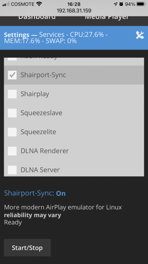

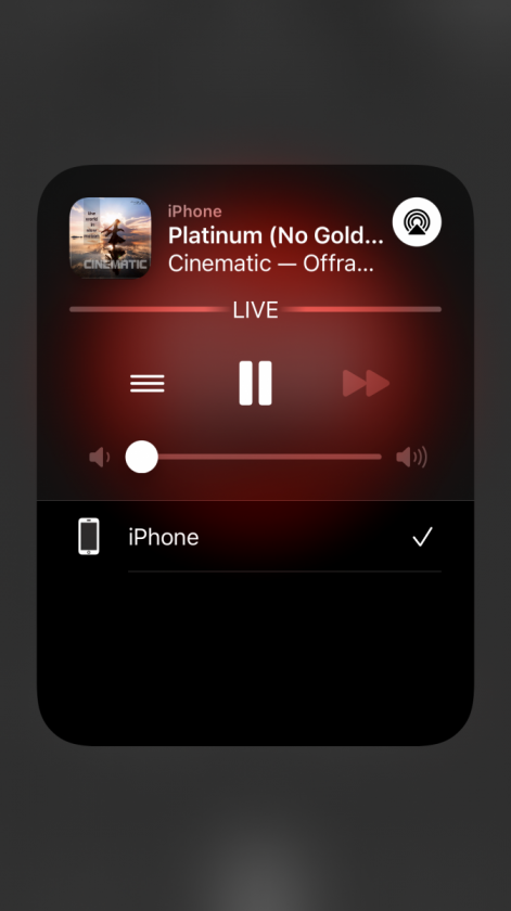

It seems that I'm having a problem with the Shairport-Sync service.
There is no possible way to connect from 2 different iPhones, BDP doesn't appear on the list as it normally did in the past.
I have tried to put a fixed IP and hard reset the devices many times.
Do you have any idea on what else Should I try ?
Spyros

I certainly would avoid using a static ip address.
Two things to check, make sure your iOS devices are connected to the same network as the BDP, the first three octets of the ip address should match (ie if the BDP is assigned 192.168.0.12, your iphone would be assigned an address beginning with 192.168.0.).  The other thing to check is to make sure the service is running after turning it on, you can check its state on the services settings page.

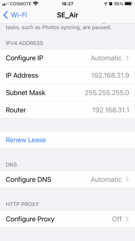

Hello Chris, thanks for your help.
I have the same first ip octets:
Router is 192.168.31.1
iPhone is 192.168.31.9
BDP is 192.168.31.159
The services are double checked:
Is there something that I'm missing, or any other ideas?
Thanks

I'm not sure if you've maybe setup some IP address reservation? Usually DHCP servers handout IP's in order (not always, so perhaps this is normal for your device), but there appears to be a large jump between your iPhone and the BDP, 9 vs 159.  What I'm trying to get at is some routers will semi isolate traffic between wired and wireless devices (i guess its a security feature).  I could be totally wrong, but you might want to go into your routers settings and check for any kind of feature that isolates wired devices from your wireless devices.  Its not a feature I see very frequently, but i have come across it a handful of times.  Im also assuming the BDP is wired to your home network and the iPhone is wireless.

Hello Chris,
I didn't reply earlier because I was waiting for a new router to check the lan to wifi isolation thing...
I have new devices all around and nothing has changed. I have proper connection through ip or the "my.bryston.com" page but it's impossible to see the device on my iPhones list
Chris
Dear Chris hello,
After many days of experimentation and many changes on my network devices and topology I found out that the problem of not having Airplay was due to some sort of security option on the Vodafone Greece supplied router.
When using internal wireless or when a wifi router is  connected directly to a port of the vf router, services like shout cast or airplay are not allowed. There was nothing in the menu of 3 different routers that they sent me that could be altered in order ti allow these services.
The way it worked for me was from Isp's router with cable to a switch then with cable to a wifi router and to bdp.
Thanks for the support,
Hope this will work for others as well.
Spyros

that's good, sounds like the BDP was double nat'd; both routers using the same IP address scheme through me off.
