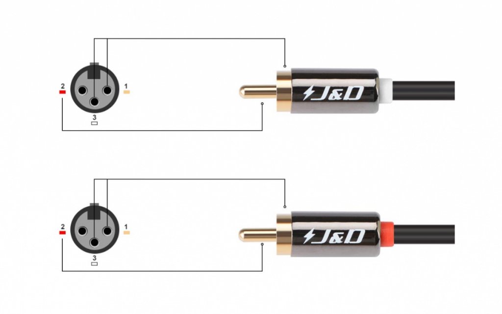

My main system has a Klark Teknik DN360 EQ sitting between a BHA-1 and a 3B SST using balanced interconnects all the way. I'm thinking of switching the EQ to a single ended EQ but I'm uncertain about using XLR to RCA adapters on the BHA-1 output.
A while back I was using the DN360 between a 0.4B and my older 3B, and for this I needed the XLR to RCA adapters for both the inputs and outputs on the DN360, and this worked with no problems for the DN360. I tested the adapters and found that both the male and female XLR adapters short pin3 to pin1.
In order to connect the BHA-1 to an unbalanced EQ or amp, I will need to use such adapters on the BHA-1 rear outputs. Will this be okay for the BHA-1? Or should should I make custom cables that would leave pin3 not connected instead?

Hi James, I received a response from Mike, thanks.  I'm glad I asked, and posting this response for anyone else who may be interested in knowing this.
From Mike...
Pin 3 on the XLR outputs is an active high current amplifier output, and should not be grounded.  Many adaptors will short pins 1 and 3 together to maintain compatibility with transformer balanced sources, and in most cases, as with our preamps, this won’t cause an issues.  However, with the BHA1 it is important to float pin 3 instead.  Assuming the XLR can be unscrewed, it should be simple to do this on an already assembled adaptor.

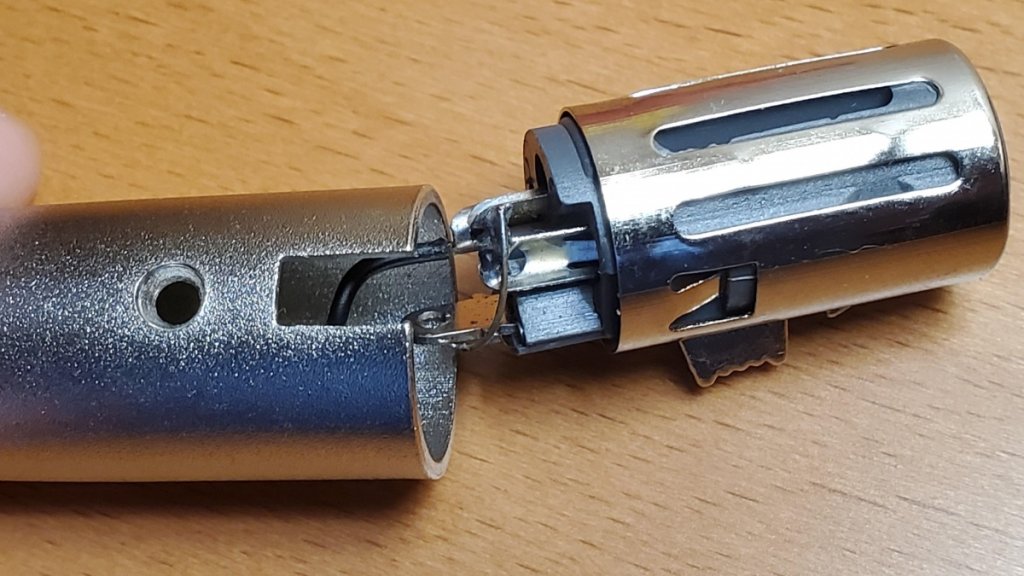

... and most (all?) XLR-RCA adapters out there cannot be opened to float pin 3.
These adapters from Amazon open easily.
https://www.amazon.ca/KIRLIN-3127-X2P-Female-2-Piece/dp/B00M0LLJ2U/ref=sr_1_6?crid=3MVE7FOMVZRF6&dchild=1&keywords=xlr+to+rca+female&qid=1594080264&sprefix=xlr+to+RCA%2Caps%2C152&sr=8-6
There is a black wire connecting the RCA hot to pin 2, and a short bare wire connecting the housing to pins 1 and 3. Just cut the short wire between pins 1 and 3, and test with a meter before using.
Alternatively, order some Nuetrik connectors and make your own cables. less connections.
