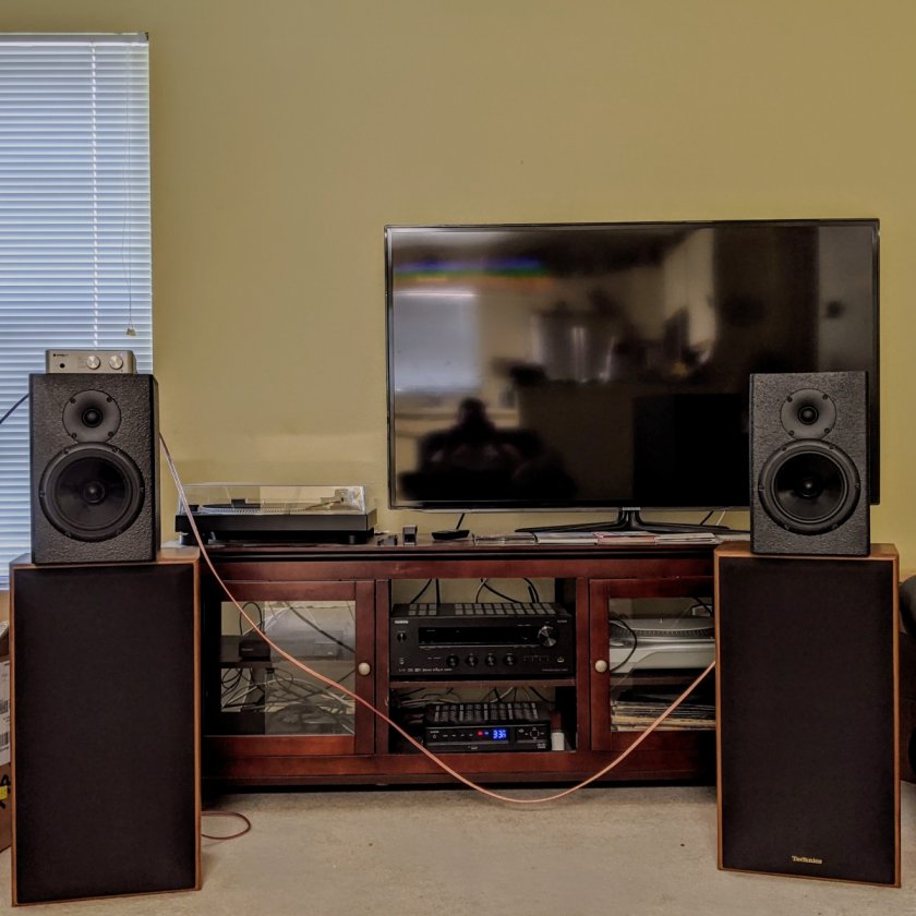

Don’t throw in the towel. This was the first crossover I’ve built, and it wasn’t bad at all. In hindsight it was fairly easy. The crossover sticky was really helpful, as were a couple of Danny’s videos in upgrading some of the Klipsch 600’s. I would also recommend a Kirby Meets Audio vid where he walks through the process of taking a crossover diagram and converting to the actual build. Here is a pic of one of my crossovers.  I connected the woofer and tweeter negative together which is not in this pic.

My X-LS Encore are finally complete! Got my sheet of Norez today & installed it while also spraying the tops of the screws gold, since I couldn't find any usable brass screws, but I'm digging the look!
I haven't had a chance to fire them up again, but Norez is not joke. I thought the stock cabinets were already pretty dead, but Norez does an amazing job taking that even further.. I'm excited to get them hooked up again!  :thumb:
