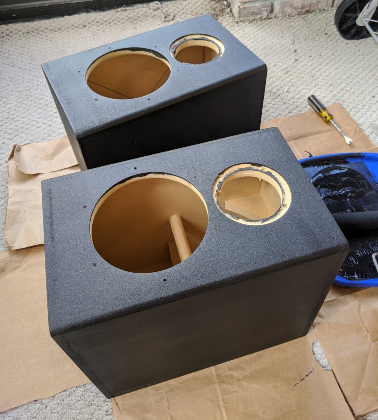

My kit and cabinets just arrived this afternoon! And the painting has begun!  :D
Hobbsmeerkat
  • Posts: 2741
Re: Hobbs X-LS build
« Reply #4 on: 25 Jun 2020, 12:24 am »
Gave them a good sanding to soften any height differences after the first coat. Ill give them another coat of duratex in the morning and sand them down again after work. Then, for the last couple coats add a little water to make for a smoother texture/finish.
I'll begin working on the crossovers tomorrow night.
Really happy with how they're looking already!  :thumb:

Does anyone have any tips for how to best thin out Duratex? Most of the time I've tried, its ended up foamy mess at best. Should i mix it ahead of time in a separate container and stir it slowly?
Going directly from a foam roller, its got a tight texture, but shows roll edges too readily..
Thanks!

I put the first coat on kinda thick then keep going back over it very lightly in opposing directions as it dries. Subsequent coats can be thinned with water but not too much. To get a smoother texture I use a smooth foam roller normally used for epoxy at least on the second and/or third coat.

It's water based so that's its solvent as well. I haven't used it all that much so I'm drawing on my knowledge of acrylic paint. There are some foam rollers that have rounded ends...that may help. Does it have a thinning percentage max? Typically says on the can.
 If it's hot and drying too fast to flow out, FloeTrol might help. It's designed to keep a wet edge with acrylic paints and I suspect would have similar effect, but again no experience with putting it in Duratex.
As Mike suggests, I suspect the absorptive nature of raw MDF is part of what's happening. It would tend to pull moisture out quickly. Ideally moisture would evaporate rather than be absorbed into substrate.

Thanks for the tip! I'll see if I can find a way to get thicker coats on.
I've been trying to use a foam roller, but subsequent coats have had issues with lots of surface bubbles, or the roller streaks instead of rolling. But ill see what i can manage.  :thumb:

Thinning max is about 10% some have mentioned 10-20% but that seems to be those using spray guns.
The foam roller im using has rounded edges, but leaves streaks at the edge, even with light texture

Thanks! Im still struggling to get the texture the way Id like it, but might not be a bad idea to sand it down smooth and use spray paint to finish them off. With a more consistent texture, using the duratex as a protective under coating.
I have a feeling the current 90°+ weather is curing the duratex before it gets a good chance to settle down to a smoother finish..
That issue aside, i have no doubt that these will be killer speakers. They're roughly the same size as my current active monitors, but should smoke them in every way!  :thumb:

Having recently attempted to get a smooth and consistent flat black finish using a rattle can, I can say it's no easy task either. Make sure you have a very consistent surface from your sanding, and are spraying thin coats in a calm, wind free environment.

Here's another thing to consider about Duratex or any other water based product. It will swell wood fibers and likely kinda lock those fibers in their swelled state. It's the nature of all finishes to some extent, but water is especially so. Duratex doesn't sand well because it's sorta rubbery in nature.
One way to deal with the issue is to seal the surface before applying the D-Tex. Mike suggested epoxy, but other things could work also. Shellac is a favorite of mine because it's easy, inexpensive and dries fast.  I rarely use it as a finish topcoat, but rather a sealer and barrier coat. Another single component sealer I use is Zinsser oil based Cover Stain. Dries fast, powders when sanded and can be had in spray cans.
Any of these base coats should make Duratex move even in sheen, easier to apply and require fewer coats.

Peter's points about shellac are good ones. Just be sure you use a dewaxed shellac. If you buy it off the shelf it usually comes in a 2 pound cut. Dilute it 50% with denatured alcohol. It is a lot easier to apply two thin coats than one thick one.
