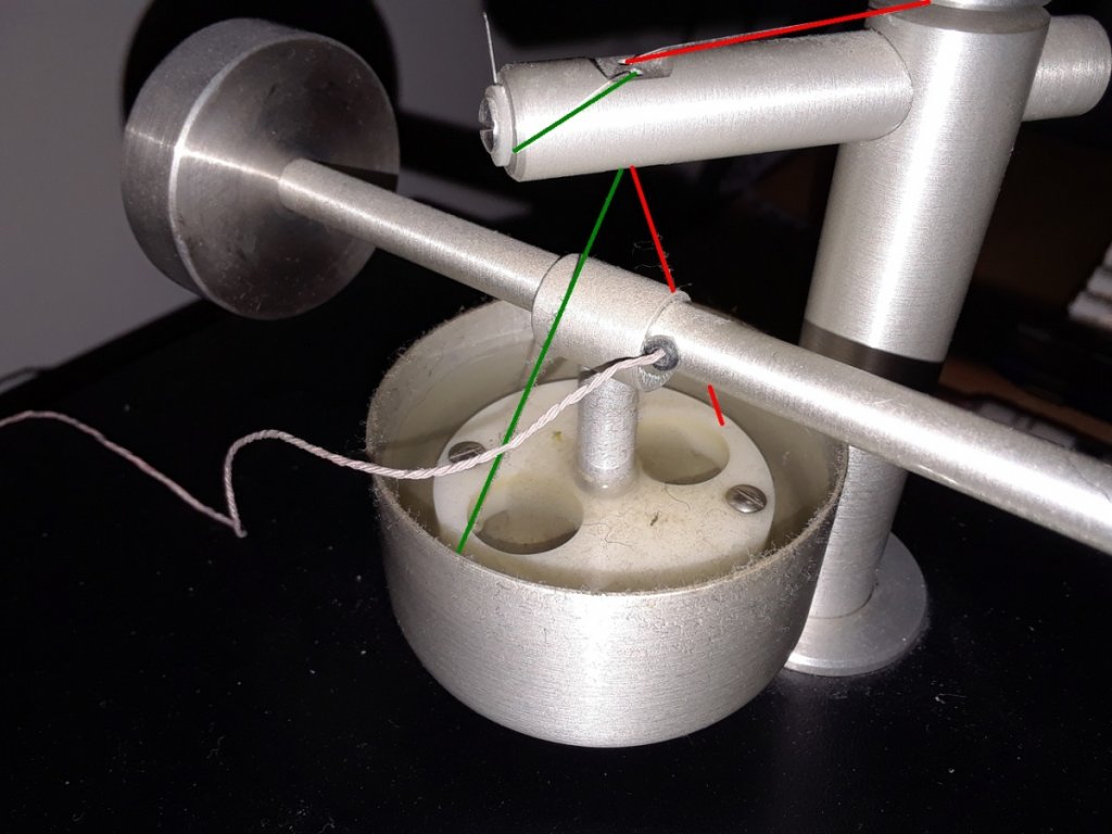

I have linked to a few photos that I hope will help.  The cup fluid covers my paddle by about 1/16", but as others have mentioned this is somewhat dependent on the choice of cartridge.  The fishing line is not twisted, but note that the front line goes to the inside attachment point on the paddle.  This provides correct anti-skate.
https://i.imgur.com/nQfaqPA.jpg
https://i.imgur.com/WfMyg6N.jpg
(Forgive the dust!)

Apesbrain are those 2 photos the same set up, one picture does not look like line cross but the other does. I can see how one end of line is held in place with a screw but do not understand how the other end is held as it goes into the post with the knob. My line does not cross like that in second picture. I would like to give it a try but do not understand how fishing line connection works. I ordered some more silicone my paddle is only a little over 50% submerged. Will more silicone stop arm pulling back to the right so much, thanks for everyone's help.

Yes, same setup.  The lines do not cross: the front line goes to the left side of the paddle and the rear line goes to the right.  Hopefully this photo will make it more clear:
I have never taken the knob assembly at the top of the post apart, so I'm not certain what happens in there.  When the knob is turned, it causes the line attached to it to change length thus adjusting cartridge azimuth.  My guess is that the knob has a threaded shaft with an eyelet thru-hole through which the line is passed and tied off.
The paddle at rest is about midway down the cup.  The two lines do not touch the arm in any way; there is about 1/8" clearance between the lines and either side of the arm.  There is a small bolt (not visible in the photo) holding the cup to the arm post and the fluid comes to just below this bolt.
