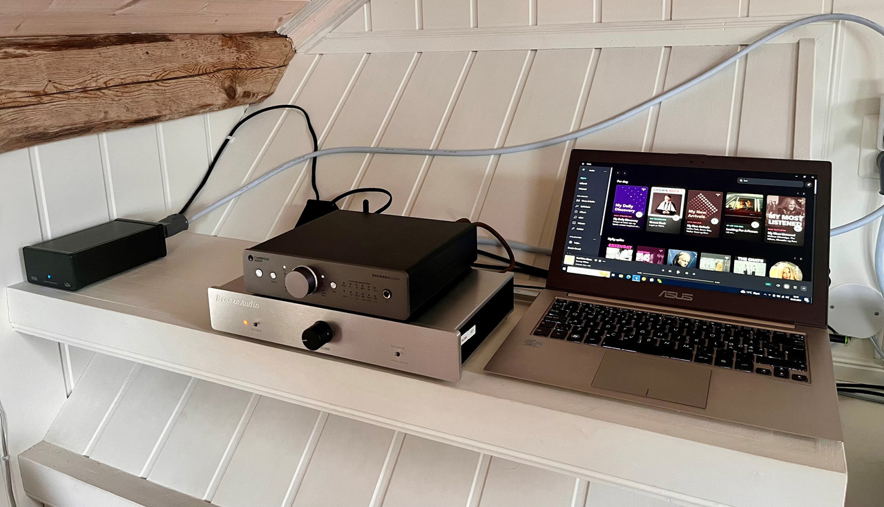

wonder whether the upgraded op amps version is worth it.  or, hunting down your own opamps like bursons.
  Good question!  I found mine to be annoyingly forward in the midrange. Mine came with 10xOPA627 and 4xMUSE8020
It was strikingly hard and shouty in the midrange with original op amps fitted. I was about to replace it but a friend reminded me to try some op-amp rolling before I gave it up.
As the OPA627 is known for being musical components, I was only left with the option of replacing the four MUSE's. I had four LME49720 lying around so I put them in place in the sockets without any further hopes. The preamp is unrecognizable. It no longer shouts, female vocals no longer have any harshness but sound very clean and realistic.
Possibly the most dynamic preamp I've heard. Reference level.
