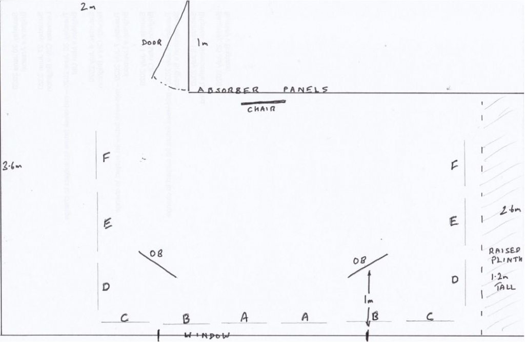

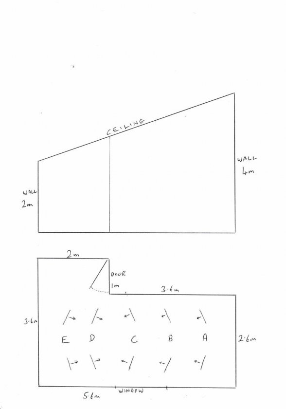

Also consider the position of the listening chair in the previous room. Was there a wall directly behind the chair or was it out in the middle of the room? Can you approximate its position in the new room?

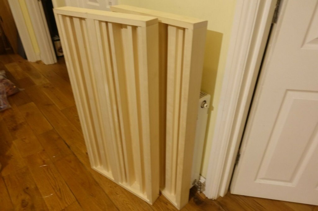

Also you might try a heavily upholstered chair with a very high back that comes up well above your head. That could provide as much, or even more, sound deadening as a panel on the wall behind you.
Keep trying. I don’t know what ob sound you are missing. I would try position D but moved more towards C. If you chair is backed up to a wall try a pillow behind your head to stop reflections. Do your speakers disappear, they should in those positions. I would also try going as wide as possible. Something like this.https://www.youtube.com/watch?v=BqzB6JkDBA8Rocket Ronny
he seems to use EQ to reduce what are probably room effects.
Sorry RR I didn't realise that was your video. Had I known I would have clarified things before posting.
