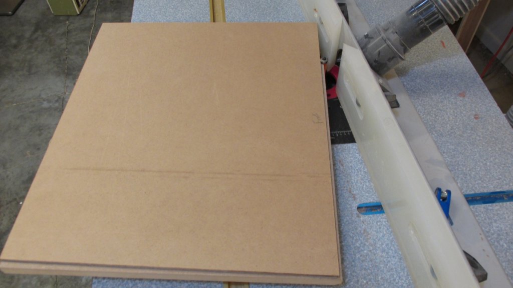

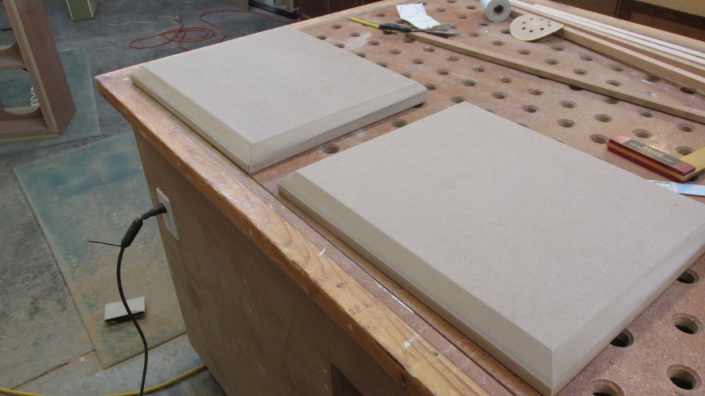

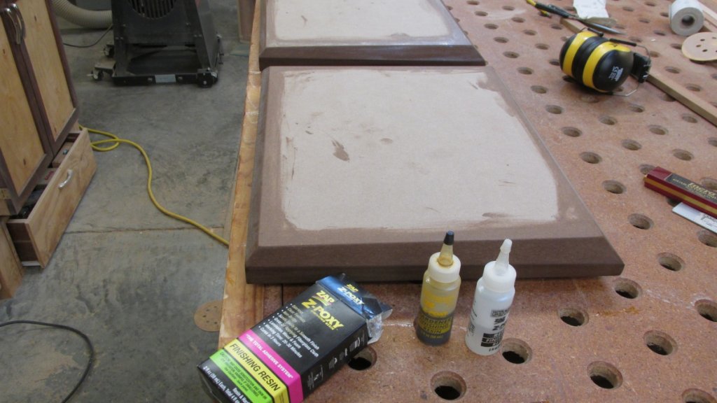

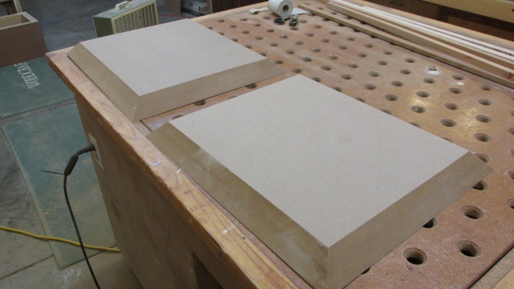

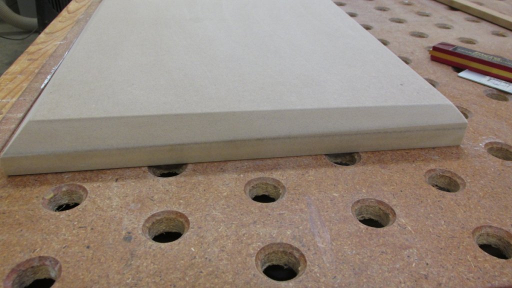

Got started on the bases for these today. Its is a good day because it means the MDF cutting has come to an end.
The last pic shows the edges being sealed with Z-poxy. This where I really missed using Medex MDF. Medex is so much nicer to use if you are going to paint IMHO.

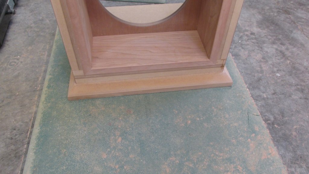

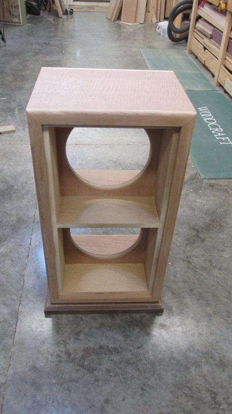

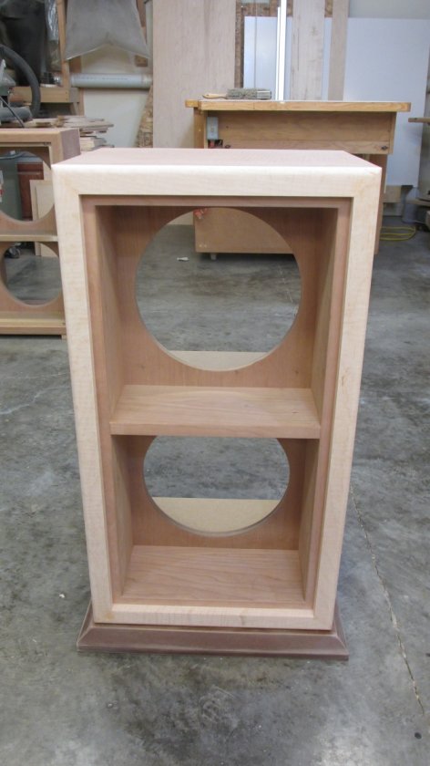

A little more progress today. Curly Maple trim on the front and Cherry on the back.

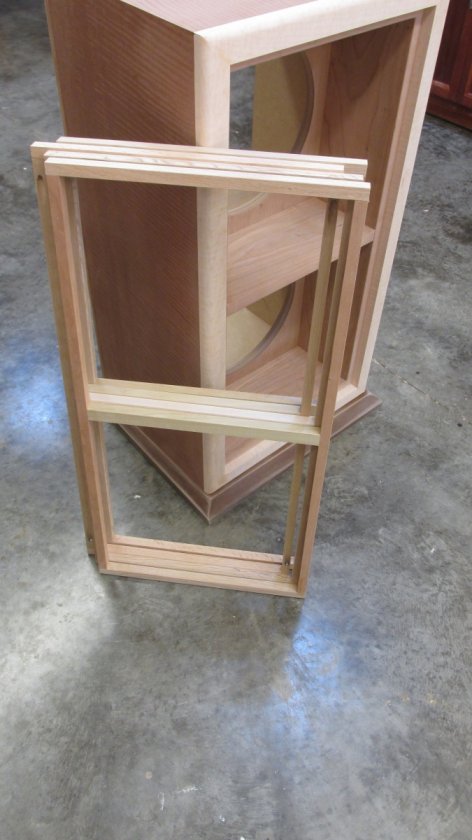

And started to make grills...I hate making these things. But I have a 2 year old nephew who always make a beeline for my speakers when ever he comes over. Lucky for my speakers that is not very often.

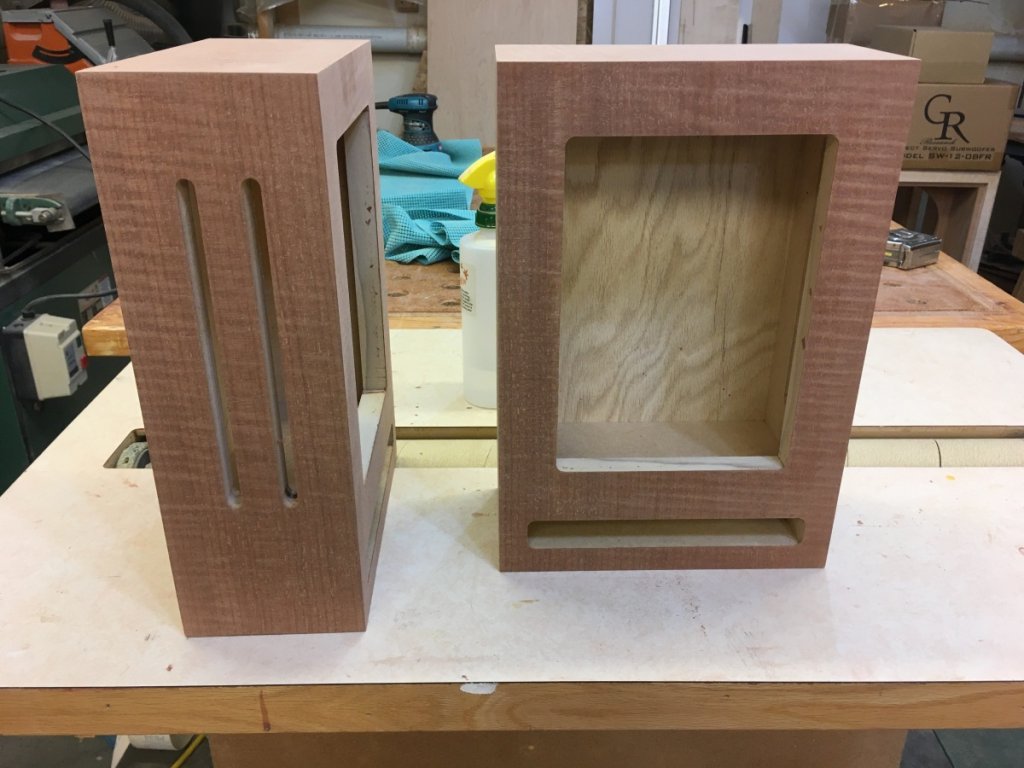

Amp boxes made and veneered. These  will house the HX300 amp. They will have magnetic grills covering the amp once set  up. The slot in the bottom will allow me to run my cable from the backside and up to the input jack. So when done  it should look like a small speaker.
If you don't mind sharing, what is your technique to get the veneer trimmed so perfectly, especially along the slots?
AlexH
Re: Sandbox OB H Frame Build
« Reply #36 on: 26 Jun 2020, 05:15 pm »
I use a down spiral router bit.
And then a little sanding.
