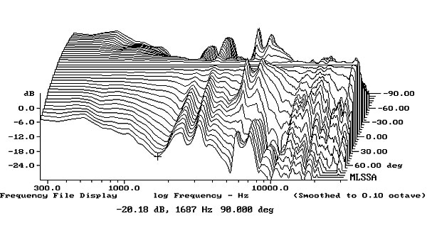

Here are measurements of a very popular speaker from a Stereophile review. You can see that the frequency response is all over the place except directly on-axis, and this is with 1/10th octave smoothing!

« Reply #21 on: 21 Aug 2020, 01:32 am »
Name names!

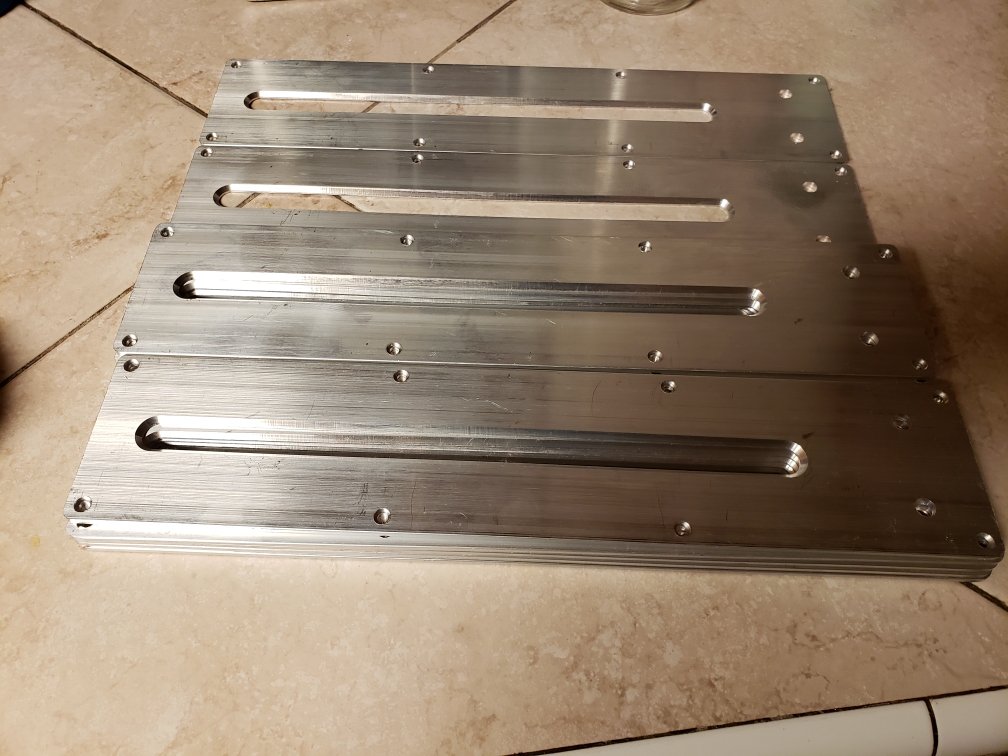

« Reply #24 on: 30 Aug 2020, 06:40 am »
lenses for the aperiodic vents were machined today  :)

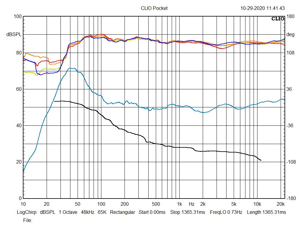

Below are some quick measurements from a pre-production prototype a3.
Frequency response:
Purple= On axis (0 degrees)
Green= 15 degrees off axis
Orange= 30 degrees off axis
Red= 45 degrees off axis
Light Blue=Phase
Black=THD
It's rare to have flat/consistent response to beyond 20k from 0-45 degrees off axis.
Notice how all 4 FR measurements are near identical, this provides amazing imaging with a much larger sweet spot.

« Reply #30 on: 30 Oct 2020, 04:26 pm »
That's a pretty impressive graph!  Man I wish I could hear these things.  Will you be sending any out for reviews?

« Reply #32 on: 31 Oct 2020, 05:29 am »
Of course you can't see what the response is on axis because the on-axis response is always normalized in Stereophile's measurements. All we see is pretty nasty off-axis curves.
Earlier in the thread you speak as if the matching off axis response of your design allows for speaker placement with less or no toe-in. I would have thought the advantage of good off-axis performance (and what is shown is extraordinarily good) would be that this enabled aiming the speakers inward, thus reducing wall bounce generated by speakers firing forward but close to the side walls, as I so often see in photos of listening rooms. If the 15, 30 and 45º curves are not level matched it looks like there is no potential to exploit the BBC technique of crossing the axes in front of the listener to widen the sweet spot, since this depends on falling levels off axis, not to speak of requiring high quality curves like yours, off axis.
Big fan of aperiodic boxes, not so much of 1st order crossovers.

« Reply #33 on: 31 Oct 2020, 01:45 pm »
The waveguide controls directivity, limiting dispersion to 145 degrees. This makes the 1st reflection further away than with conventional designs. You can still toe-in if placement is near a wall but is not required to have good imaging.

« Reply #34 on: 31 Oct 2020, 02:48 pm »
Frequency response:
Light Blue=Phase
Black=THD
I realize you are trying to fit an FR measurement, along with a phase measurement and THD measurement all on one vertical axis. The vertical axis is now poor in resolution as such and is a 100dB scale. It appears on your horizontal scale that the smoothing is ~?1 octave? Is that right, I am squinting a bit!?
Is there a way you can just post the FR measurements with as little as smoothing as possible to visualize the differences between the 3-4 curves? Do you have polar plot or contour plot measurements?
Anand.
CIAudio
Re: The 1st CIAudio Loudspeaker!
« Reply #35 on: 31 Oct 2020, 03:15 pm »
These are just quick measurements of a prototype under development to give you an idea of their off axis performance.
As you mentioned, the scale is to show many measurements on a single graph.
We will have a variety of performance measurements once we finalize and test actual production units.

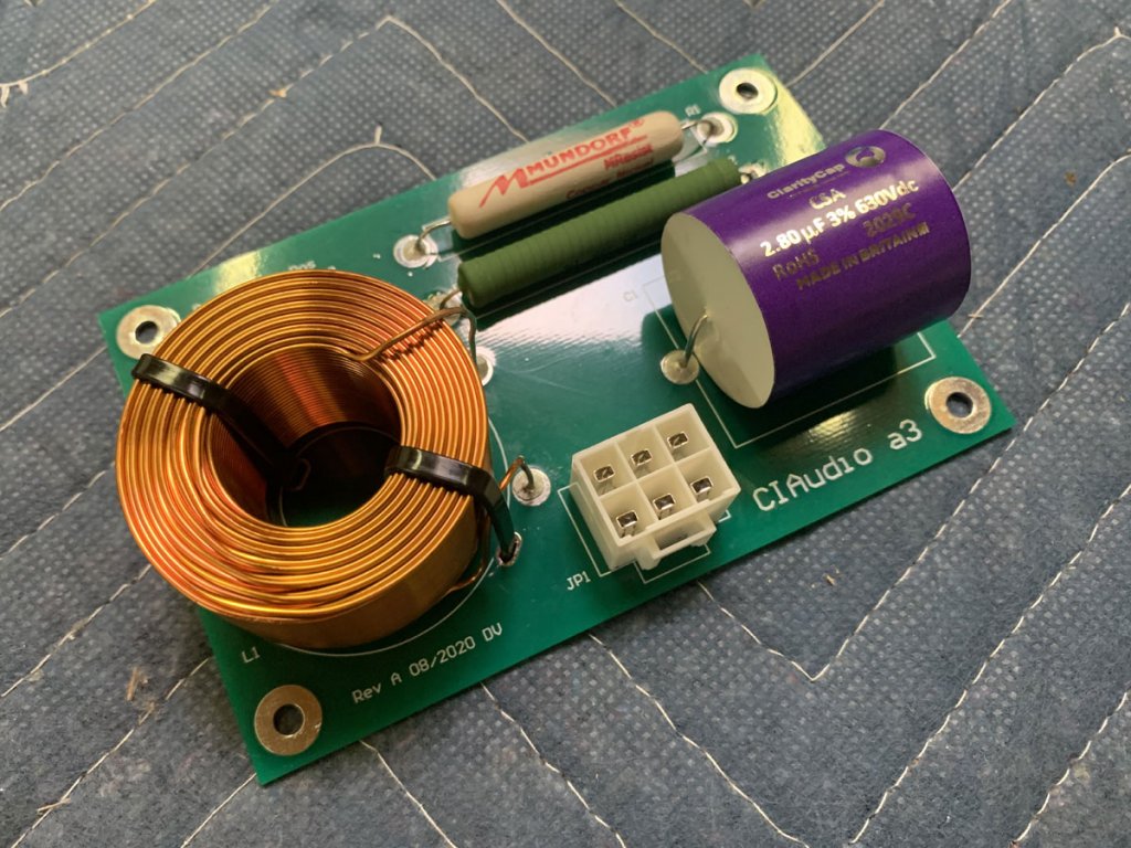

The final design has now been completed.
After testing various driver alignments and configurations, the passive radiator wins out over aperiodic.
I’m still a fan of aperiodic designs, but the tuned radiator works best in our design.
All parts are now in production... custom capacitors being made by Clarity Cap, Jantzen inductors coming from Poland, and cabinets being fabricated here in California.
If things stay on track, we’ll be shipping in late December!

« Reply #38 on: 19 Nov 2020, 10:22 pm »
Frequency response:
Light Blue=Phase
Black=THD
I've never seen a chart even remotely close to this for off-axis HF behaviour—and you appear to be using a conical waveguide for the tweeter which isn't all that unusual. I admit to being puzzled. What are other designers missing?
