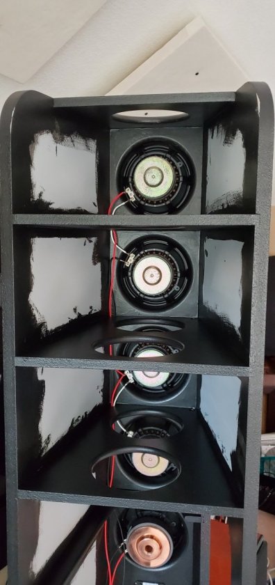

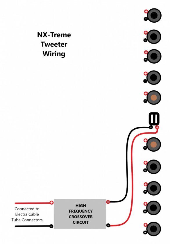

Pay attention  ,  the  tweeter and   8 M165's   are wired out of phase... just  a heads up.

Rock Ball

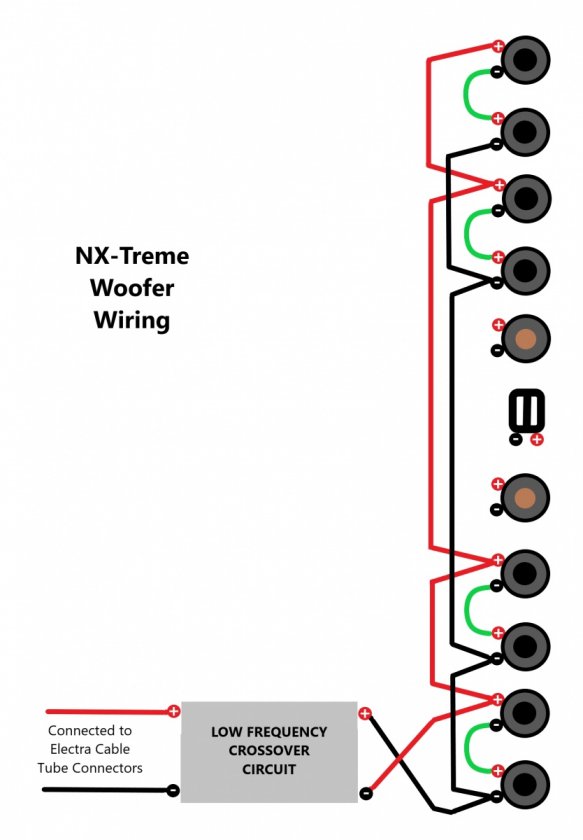

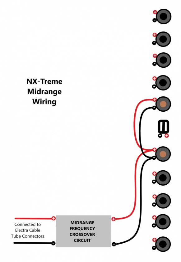

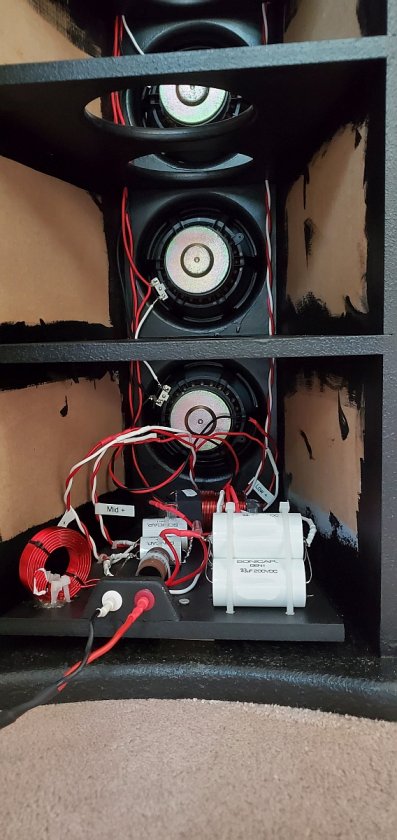

I built the crossovers about a month ago.
The tweeter circuit leads are correctly color-matched to the tweeter terminal, but the low end circuit leads are not.  I misinterpreted the schematic at first, but connected it correctly in the speaker.
I used the solid core wire on my subs and had only enough for my tweeters after building the crossovers.  The additional wire I bought from Danny was the 14-gauge multi-strand.  I had trouble figuring out how to connect it to the driver terminals at first, but finally got everything wired last night.

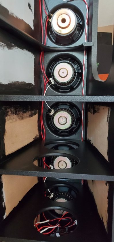

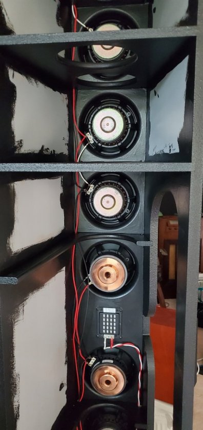

Routing the wire and cable management can be a challenge in any build.  Can you take a few pictures of the columns from the rear and tell us what to do and what not to do based on your build.
Re: Rock Ball's NX-Tremes build
« Reply #33 on: 30 Apr 2020, 06:13 pm »
We've added holes to both sides of the bracing  so, in the  lower section, you can run the  woofer wiring up the outside of the cabinet  while running the  tweeter and mid circuit up the inside.  Once you  get above the   first  "J" brace,  , you can cross them all over to the inside so you  don't   cross the outer  tweeter opening.

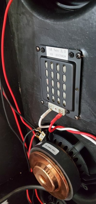

I'm certainly no expert, so all I can tell you is what I did.  Good or bad.  Take it or leave it.

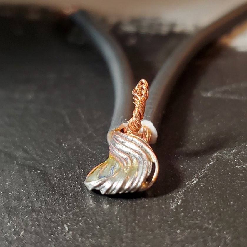

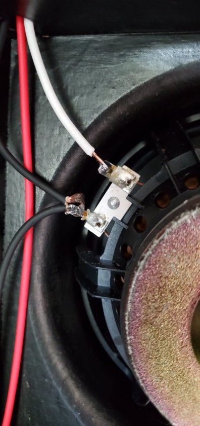

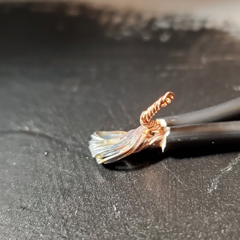

I didn't want to splice wire, so I had to figure out a way to connect the 14-gauge stranded wire securely to the speaker terminals.  Here's what I came up with.
I separate 3 strands and doubled them, then twisted them.  Doesn't look great but it is secure.  I'd like to hear suggestions about other ways to do it.
The white wire is what I had left over from the 16-gauge solid core wire.  (represented by green in the schematic above)
I was happy with how the tweeter wiring came out, using the solid core wire.

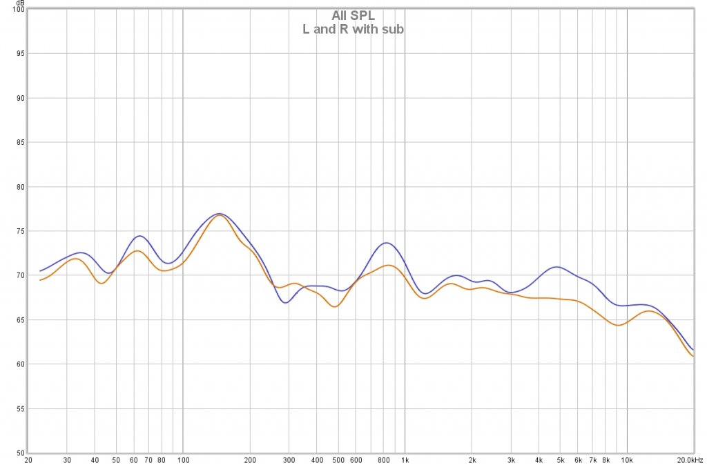

I finished the speakers tonight.  I made some measurements with REW.  Here's the L and R speakers with the subs.
I'm not sure what to make of the graph, but the speakers sound fantastic.

I wonder how much that'll settle in after, say, 50 hrs of playback. It'd be interesting to see those measurements again later.
Hobbsmeerkat
  • Posts: 2741
« Reply #38 on: 5 May 2020, 02:55 pm »
I wonder if that peak at 150 is caused by room resonance or surface reflections? That said, the bass as a whole seems boosted a bit too?
But I don't know the layout of your room or how you measured them. could account for the differences between the left and right towers?
  • Posts: 11603
« Reply #39 on: 5 May 2020, 03:14 pm »
150hz is almost certainly a room mode. I have to deal with a similar issue in my upstairs system.
Run the sweeps again but with the subs off.
