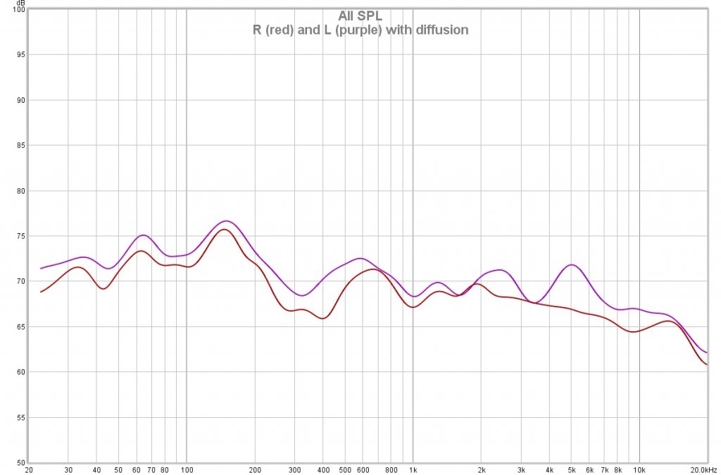

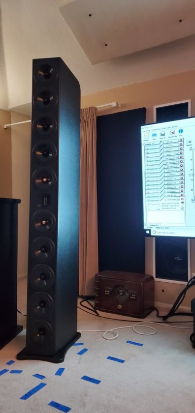

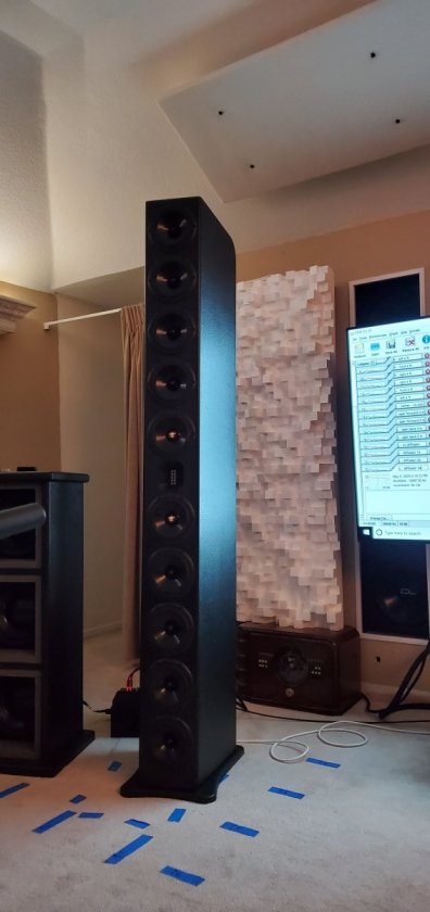

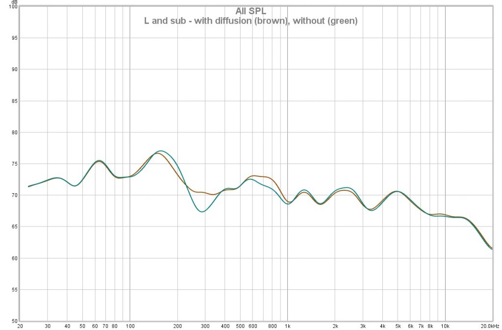

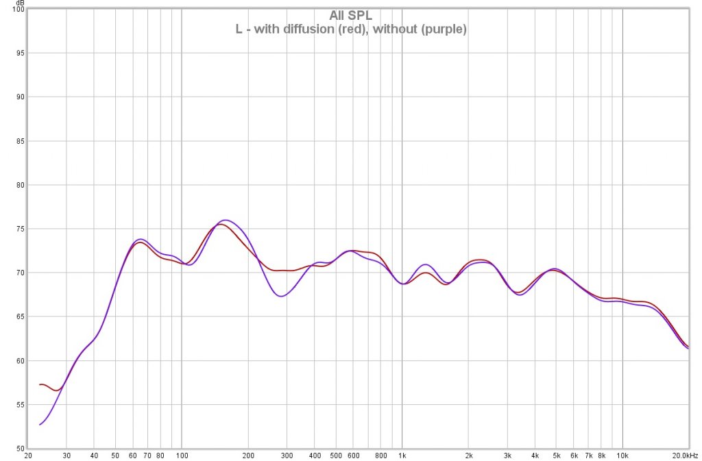

Took some measurements tonight.  Here are a few of the more interesting ones.
Here's the original configuration with absorption panels, no diffusion.
Here's with diffusion panels stacked behind the speaker.
Here's the measurements of both configurations.
With the sub added.
L and R with subs and diffusion behind both speakers.
The right speaker has the equipment rack directly behind it.  It is not as open as the left speaker.
« Last Edit: 7 May 2020, 11:56 am by Rock Ball »

I'd move the equipment so it's directly below the TV and as close to the wall as possible, and then add diffusion behind the right speaker.

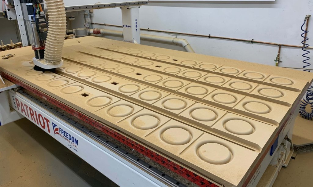

More  NX-Treme baffles being cut... backside operations.
For those interested,  13  tools involved in  cutting these including   4  custom   made   bits.
jay

« Reply #67 on: 12 May 2020, 02:53 am »
Now that's an amazing sight to see!

« Reply #69 on: 12 May 2020, 12:35 pm »
WOW! That's a big CNC machine! Very cool! Thanks for sharing.
