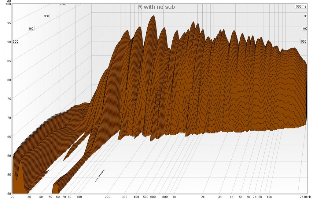

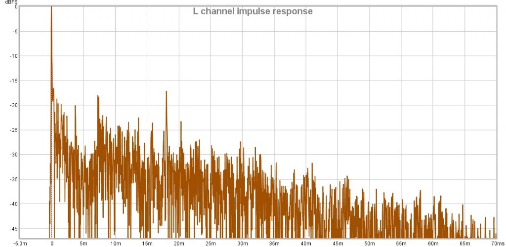

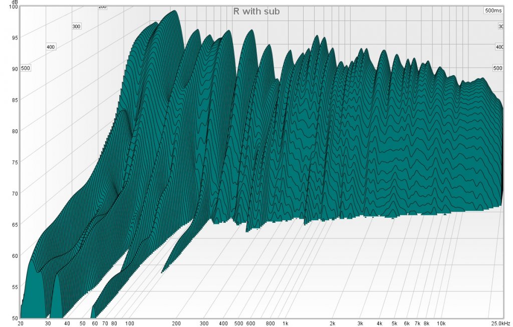

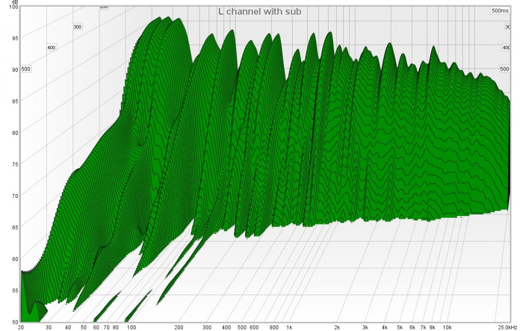

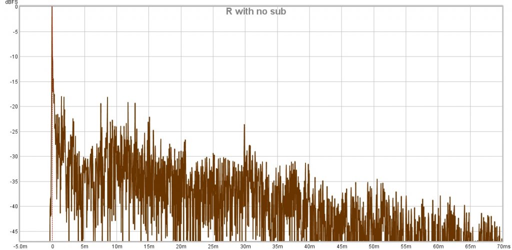

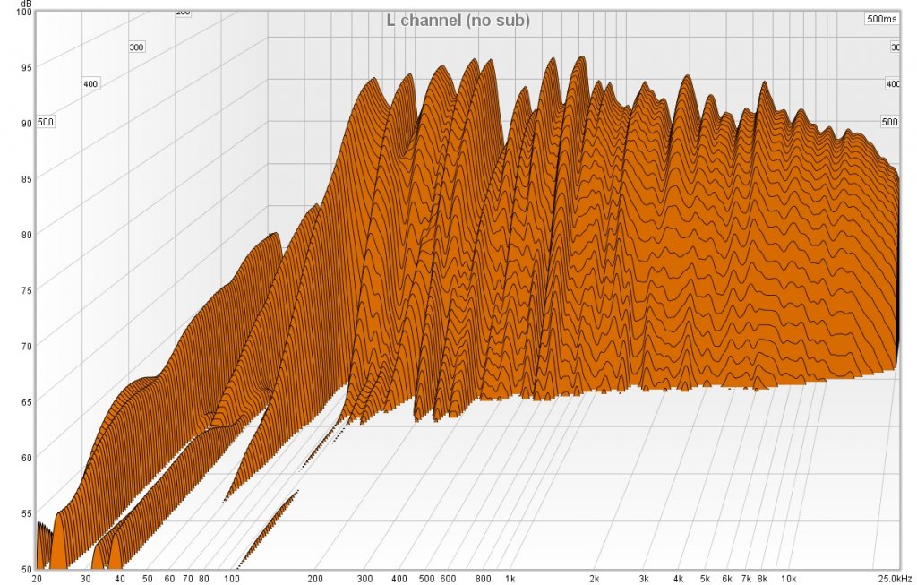

Here are more charts from my measurements.
I believe that the low frequency information in the waterfall charts is from road noise, A/C, PC fan, and other ambient noise.
Left channel without sub.
Left channel with sub.
Right channel without sub.
Right channel with sub.
Left channel impulse chart.
Right channel impulse chart.
You can view the charts in my gallery to see them more clearly.

Rock,
There is some work to be done but you are off to a good start. Where you place treatments and what kinds of treatments you use in your room as it pertains to the dispersion of your speaker can be interpreted through REW, provided you measure properly!
Recommend you read this:
http://www.acousticfrontiers.com/wp-content/uploads/2011/10/acoustic_measurement_standards.pdf
If you use a laptop on battery, you can eliminate what you feel are “sources of noise” in your measurement. And of course you can measure with the HVAC off as well.
There are specific sections on interpretation of spectrograms, impulse data for reflection points etc…, in the latest guide, download is here:
https://www.dropbox.com/s/51jpnxet3bvew2k/REW%20101%20HTS%20Current%20Version.pdf?dl=1
Good luck!
Best,
Anand.

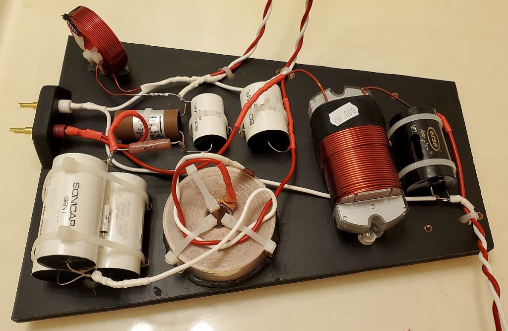

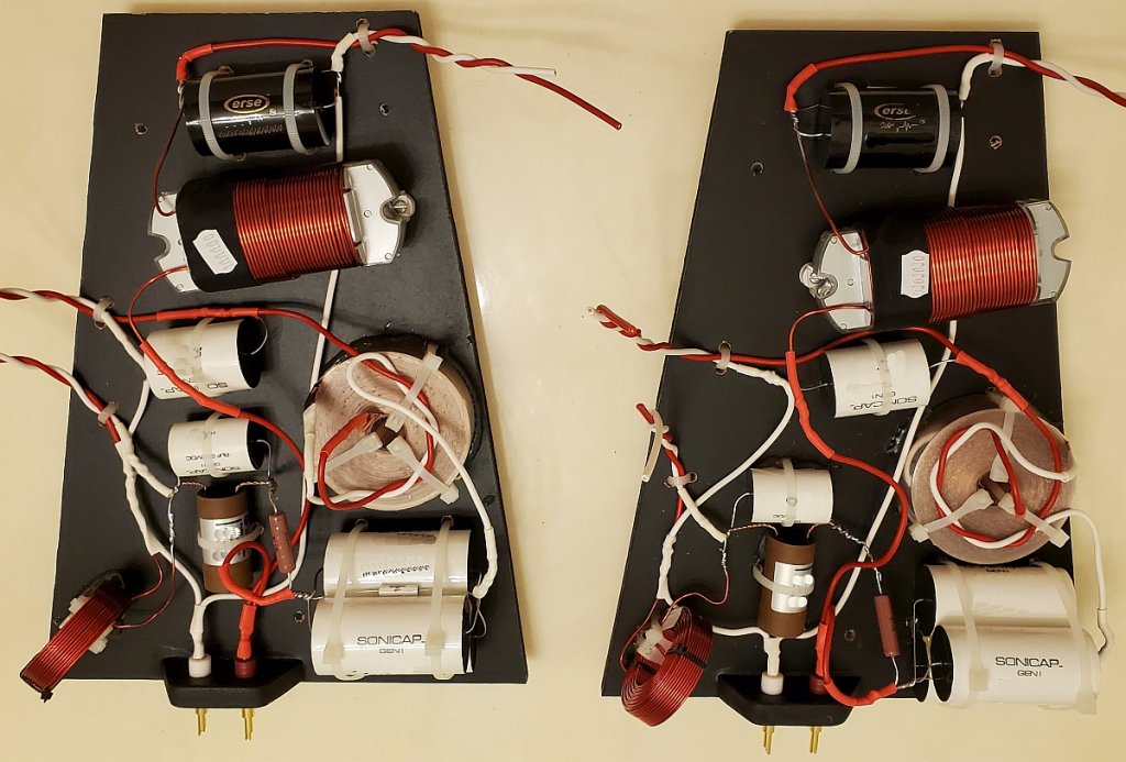

I built the crossovers about a month ago.
The tweeter circuit leads are correctly color-matched to the tweeter terminal, but the low end circuit leads are not.  I misinterpreted the schematic at first, but connected it correctly in the speaker.
I used the solid core wire on my subs and had only enough for my tweeters after building the crossovers.  The additional wire I bought from Danny was the 14-gauge multi-strand.  I had trouble figuring out how to connect it to the driver terminals at first, but finally got everything wired last night.
I've been listening to them without the No Rez.  I will install that by this weekend.
EDIT:  See this thread for how I connected the crossover wire to the copper foil inductor.
https://www.audiocircle.com/index.php?topic=177128.msg1864764#msg1864764
Hi,
Thanks for posting your build thread.  Just curious why your crossover only has 3 inductors instead of 4?

Hi,
A notch filter was added to a later revisions of the kit, this kit was before that change was made.
