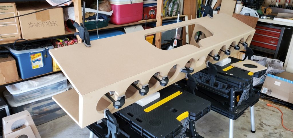

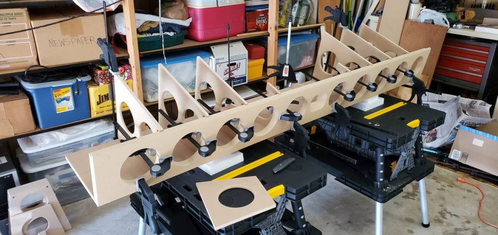

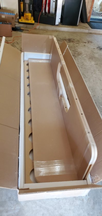

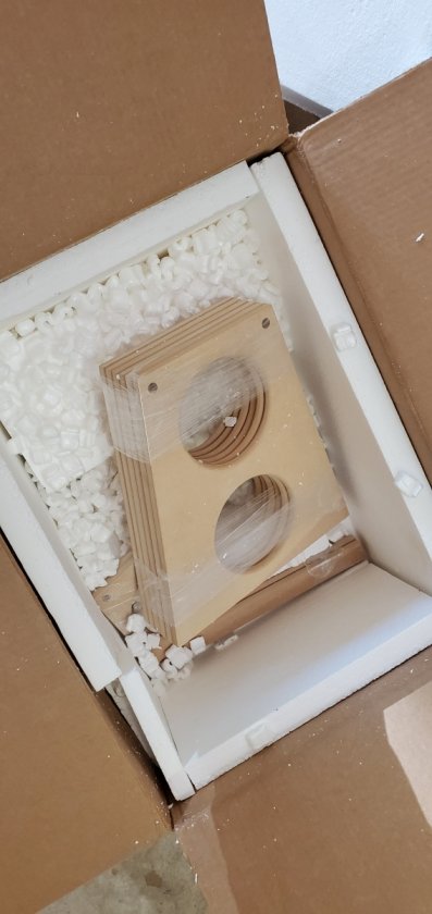

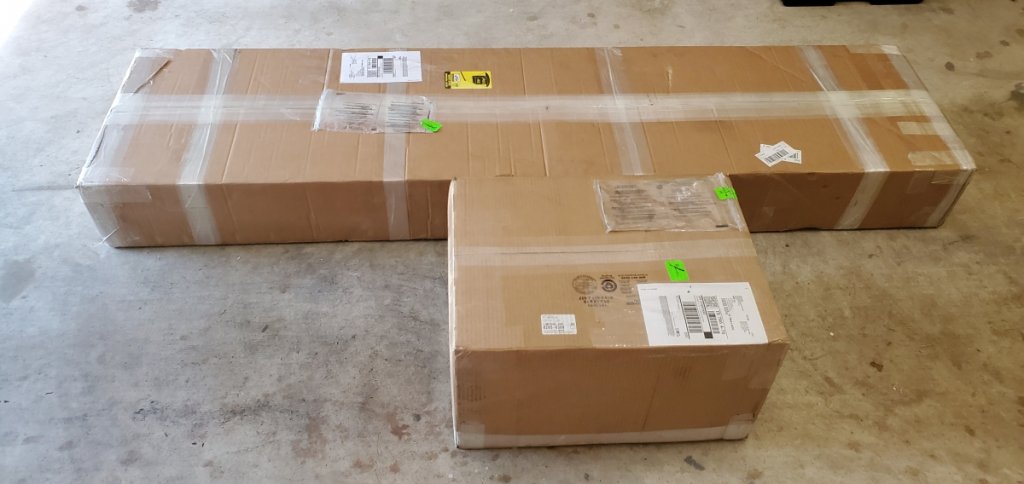

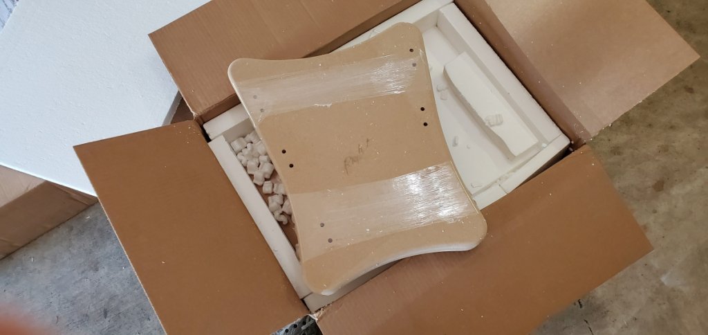

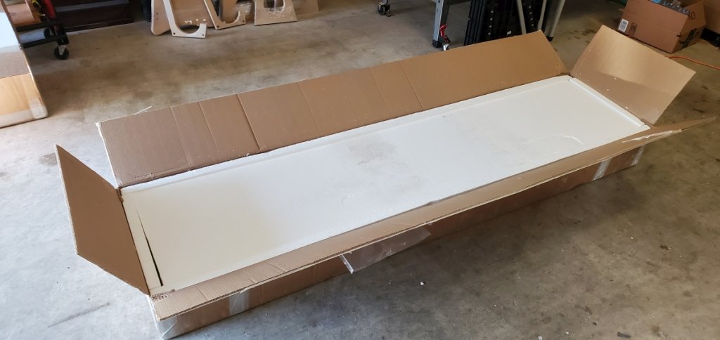

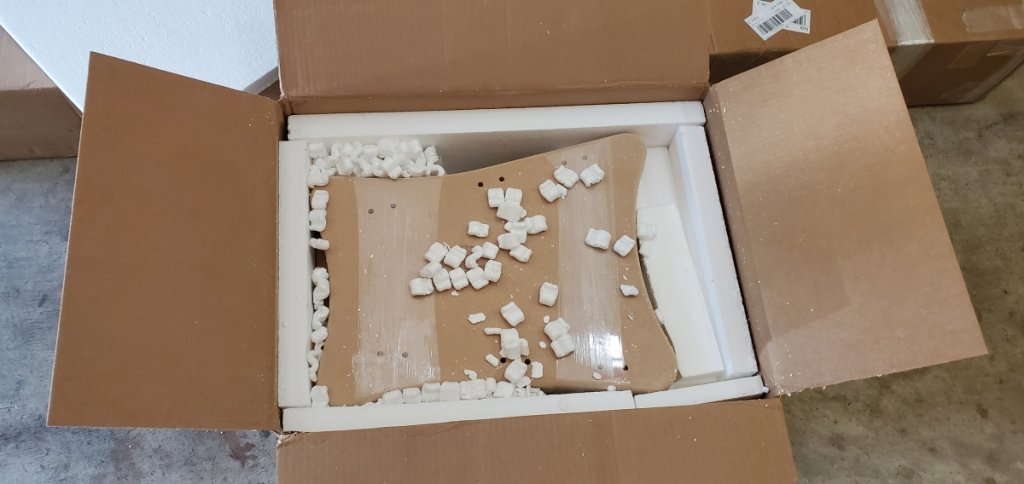

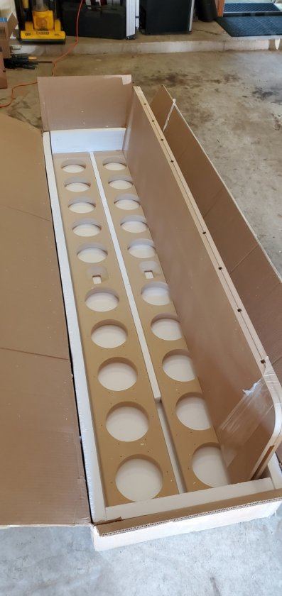

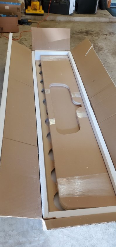

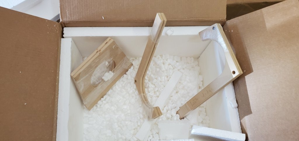

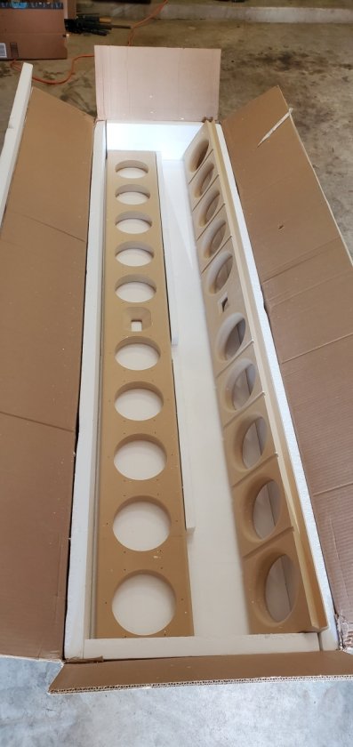

I received my NX-Tremes flat pack from Captainhemo (Jay) today.
Started working on the dry fit.
The weight is more manageable that I was expecting.
More to come.

Are you sure you have enough clamps?  :lol:

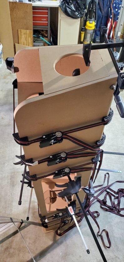

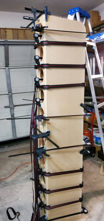

Rock Ball
Re: Rock Ball's NX-Tremes build
« Reply #4 on: 24 Apr 2020, 04:08 am »

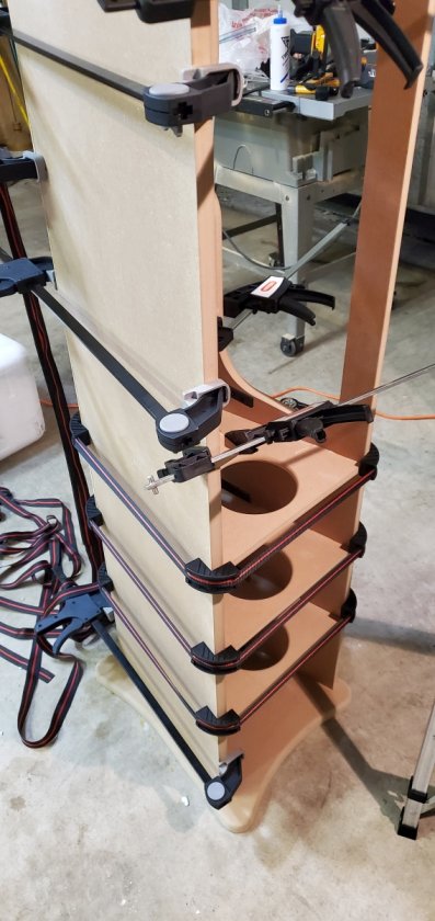

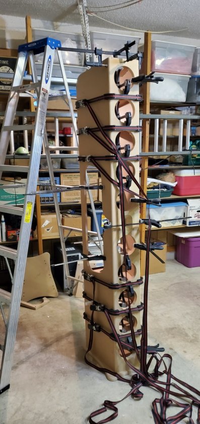

Got the first one glued tonight.  I decided to glue the base and the top while I was at it.
Actually, no.  I could have used a few more!
It took almost 40 minutes from start to finish.  I used Titebond Extend glue so I had a little more time to work with it before it set.
EDIT:  I used a total of 8 oz. of glue on both cabinets.

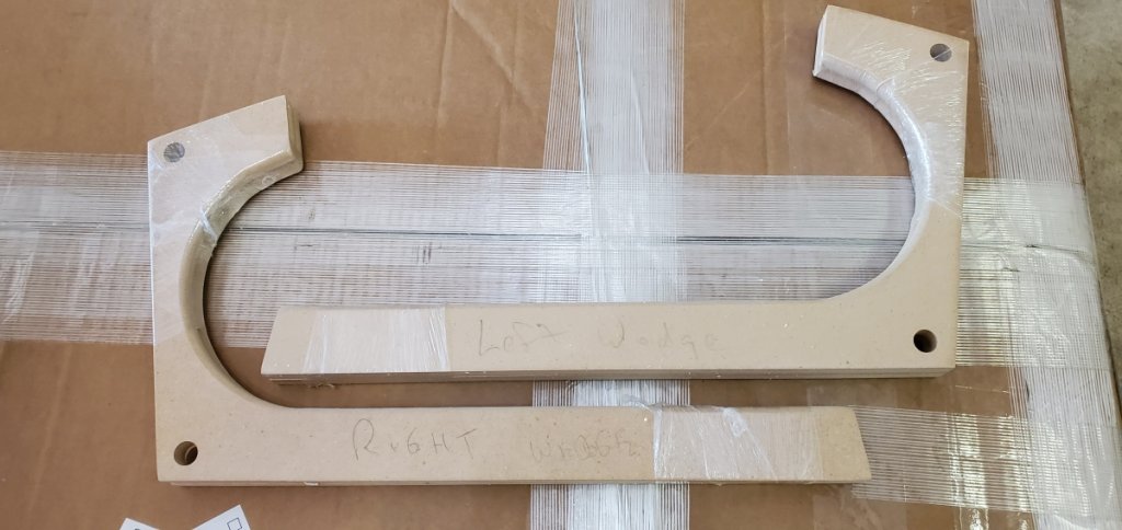

I would imagine these are mirror-image pairs; so is this accomplished by the parts being keyed or is a right simply and upside-down left due to symmetry?
Jay marked all the parts clearly to show left/right, front/back, or top/bottom.

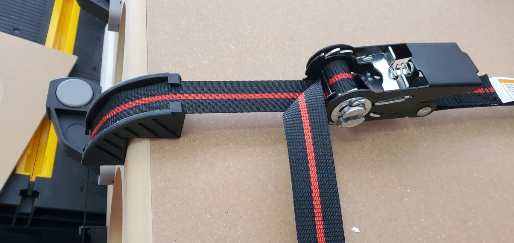

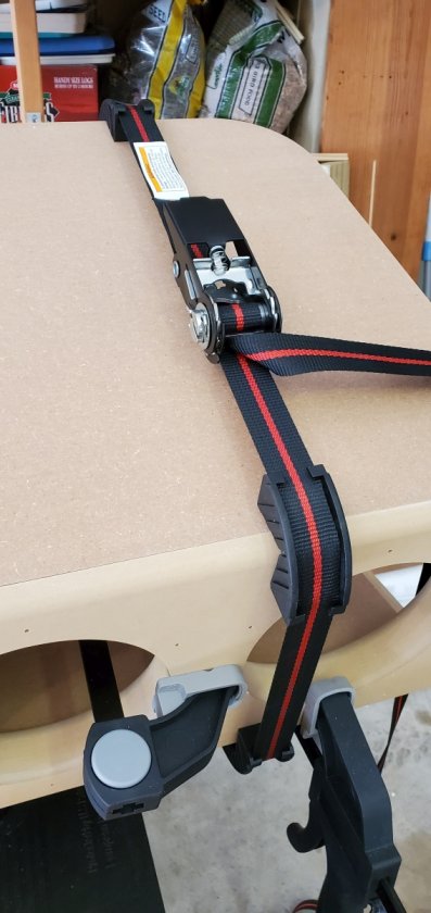

Where did you get the ratchet clamps with the corner braces?
Rock Ball
« Reply #16 on: 25 Apr 2020, 05:23 pm »
I got the ratcheting band clamps at Harbor Freight, along with most of the other clamps:
https://www.harborfreight.com/1-inch-x-15-ft-ratcheting-band-clamp-66220.html

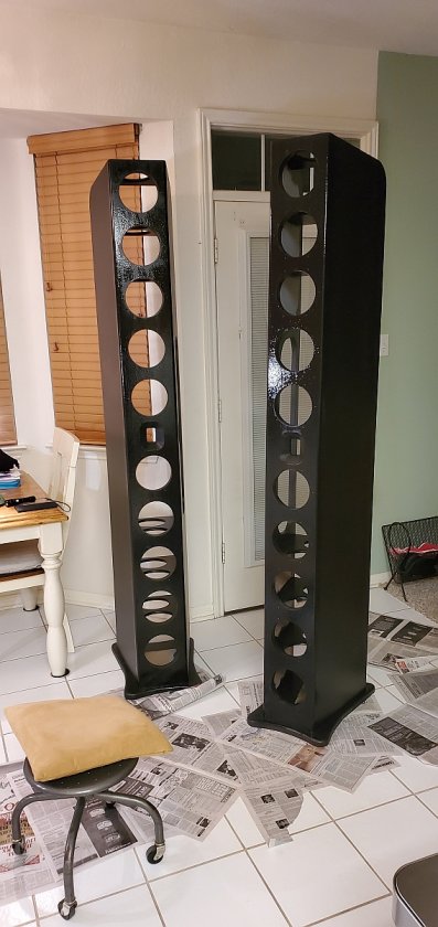

Primer coat applied.
I'm not doing anything fancy with the finish.  Front baffle will be matte black and sides will be coated with Duratex.

Allen, have not had a chance to open up the boxes.  I would imagine these are mirror-image pairs; so is this accomplished by the parts being keyed or is a right simply and upside-down left due to symmetry?
PS, to others who do a build this complex; there is another glue option I have used on every build I have ever done; including furniture with complex joinery.  It is Liquid Hide glue.  It has an open time up to 90 minutes (cool environment) and is VERY strong when cured.  Makes things less panicked then 10 or 15-minute open times on glue.  The only downside with hide-glues is that moisture can soften the joint temporarily until it evaporates.  But that much moisture would destroy an MDF construct so not a practical concern anyways.  Also, it cleans up (both cabinets and clothing) with a slightly moist rag much easier than an aliphatic compound (yellow glues).
There is a left  and right, mirror images of  each other.... we  mark all the parts   when we're dry fitting prior to packing them up.

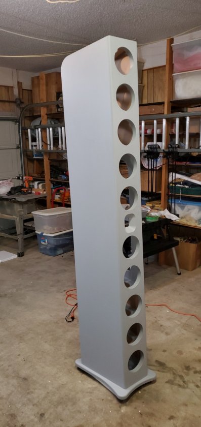

Rock Ball
« Reply #19 on: 27 Apr 2020, 04:33 pm »
It was a long weekend.
Painted.
Drivers installed.  Ready to wire.
