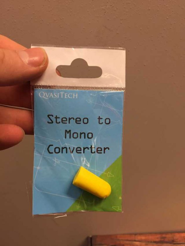

Stereo to mono adapter internet search.
hilde45
Re: How connect single subwoofer with 2 monoblocks
« Reply #14 on: 13 Apr 2020, 06:20 pm »
Thanks. Need to be sure that such a cable doesn't collapse the stereo field to mono.
opnly bafld
« Reply #15 on: 13 Apr 2020, 06:25 pm »
Not a cable; a box with 2 rca in 1 rca out.
hilde45
opnly bafld
« Reply #17 on: 13 Apr 2020, 06:36 pm »
Yes, something like that.
