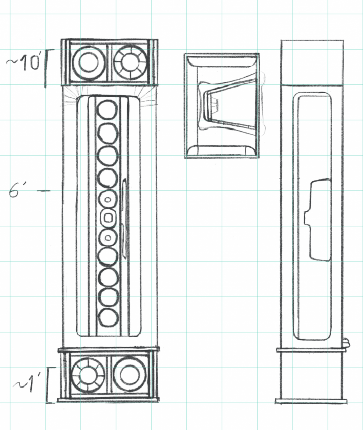

Opps... took the design a step further.. something a little more clean and just as over the top... :lol:
