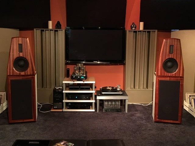

I built these for a customer back in 2016 and Folsom's comment sparked my memory a bit. I think I did use my bandsaw to cut my no-rez using the rip fence. When cutting soft things like this I've found the bandsaw is a lot safer than the table saw, because of its lower blade speed it tends to grab a lot less. gguy, sorry for giving you conflicting info. I do think you could get good results with a jig saw as long as you worked out a decent straight edge system to keep your cuts straight.
Yes very nice set up and room Woodsage! Are those Acoustic Fields brand QD diffuser's and bases? I really would like some of those myself. Did you build them yourself?
Thanks Sonicjoy. I was lucky enough to enjoy that listening room for 12 years but it is no longer mine. Lots of life changes since then, the bulk of them really good.
The floor, wall behind the speakers and wall to the right were all concrete. Additionally there was light weight concrete in the ceiling for hydronic heating above so it was a real solid room. The room treatments were built by my buddy and ex-business partner and were built from Decware plans. There are bass traps in the corners as well as diffusers on the side walls and they made a huge difference.

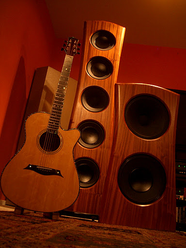

My buddy who built the room treatments took up guitar building in his retirement and is now an accomplished luthier. Here's a shot of one of his guitars next to a couple of my builds.
