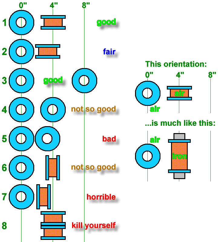

You're going to want to flip one of those inductors vertically to lessen interactions between the two.

Peter J
  • Posts: 1964
  • Hmmmm
Re: Just ordered A/V-1RS
« Reply #5 on: 30 Mar 2020, 01:56 pm »
I have trouble remembering the "rules of the road" when it comes to inductors This and others like it are handy.

It looks like you should have just enough wiggle room with the leads on that top inductor to just rotate it in the zip-tie to have it stand up. And optimally, it could stand to be about another inch or so away from the other inductor, but that would require un-soldering and resoldering and such. If that's not an option, at least the first option is better than its current state. ;-)
Exactly what I was able to do. Also had some looseness in the wire and spread them apart a bit more. All good. Thanks!
