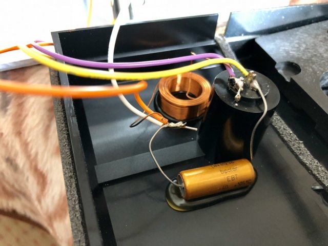

The inside of this B&O CX50 has a loose copper wire. The glue holding it secure has broke and now it's dangling. Can anyone suggest a proper procedure to make it right again? Thanks, Jack

The copper coil inductor has ripped off the surface of the cabinet. Use double side foam tape or Automotive Tape to stick it back where it was (link below). However, the exposed dangling wires on the right which are suspended in mid air (soldered onto the capacitor leg) are meant to be that way....

Hey OSIB16 thanks for the reply. I'll give your advice a go. - Jack
