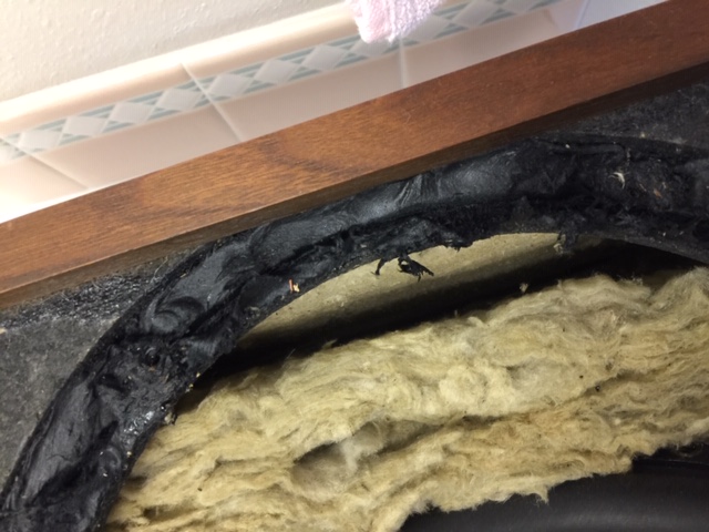

I've got a pair of A25 speakers that I bought from a guy on Craigslist about a year ago. I bought them because I wanted to hear what they sound like. After all, they're famous and practically everyone has heard a pair, right? Well, I hadn't. Now I've heard them.
The guy who sold them had monkeyed with the front baffle <which didn't worry me at the time>. It wasn't until after I had paid him my $200 and he was driving off that I removed the woofer in order to see just how screwed up the speakers were. It turned out that the front baffle portion that held the driver's screws in place had rotted out, so this guy had used caulk/liquid nails/black goopy gunk to 'seal' the woofers to the baffle. Of course, this throws the sound off.
Anyway, the speakers have sat in my office for a year now. I'm not going to listen to them. I've considered offering them up for sale; selling just the drivers (all 4 work) and keeping the cabinets for a future project, or just tossing them in the garbage when no one is looking. I could even offer them as a KARMA (recipient would have to pay for shipping!).
Anyone have suggestions? How should I handle this?

Pictures please. They have gunk to seal them from the factory (it's not glue though). I'm not sure anything sounds off about them yet. I like them personally buy recognize they aren't perfect and maybe not for use in ones primary stereo.

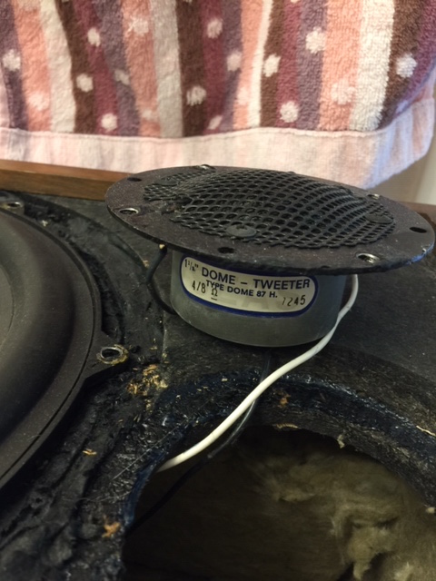

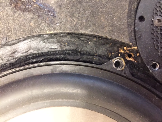

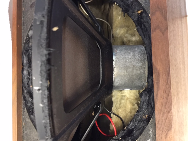

I think you can make out that the baffle is still intact, but the seller must have thought the screws were no longer capable <alone> of securing the woofer drivers. My original idea was to hire a guy locally to make me new front baffles. However, I'm not so enamored of their sound that I want to go to the expense or trouble of reconditioning this old pair.

The woofer sealant on my Dynaco A25's is one that does not dry.  Had to carefully peel the woofer out of its mounting hole.
Got lucky and found an A25 and A25XL that had tweeters mounted as mirror image pair.   Sound very good for their age.  Replacing the tweeter series connected electrolytic cap with a Solen PP film made a big difference in sound quality as did cleaning the attenuator switch contacts.

Those are bone stock, probably never opened before. Totally factory and just fine. They aren't exactly meant to be played without the grilles...
They need a new capacitor if the tweeter isn't blown, and some fresh goo, that's it.

   That's no problem. Very carefully take a 1 inch putty knife and some rags and scrape up that gorpy glue. You want to be careful to not bring up any of the particle board. Fill the old holes with some silicone caulking and scrape them flat with your putty knife once the black gorpy stuff is cleaned up.
   Get a roll of Mortite at the hardware store.It's like modeling clay on a string. It comes in a big roll and is used to fill cracks in old wooden windows and can be pulled out for the summer. It's the easiest way to make a uniform woofer gasket that does not harden and does not get goopy. When you put your woofer back in note where the old holes were and move the woofer over 1/2 an inch....remember to make new pilot holes smaller than the screws diameter. Protect that woofer from any slips of your hand! I know from experience.
    I noticed that little point of crumbled particle board. One pair I fixed looked exactly like yours I put a Mortite gasket in an just kept it abutted against the woofers edge around the routed edge of the woofer cabinet hole.When your screws are in place it will be air tight I did the same with the tweeter. Don't over tighten the screws,the gasket does a job of holding too. The Mortite doesn't even squeeze out,it was made for Dyna it seems.
   I saved 2 different Dynaco woofer gaskets. They were a cheap way out,foam, and are as thin as a piece of paper. I forgot wipe the black crap off the woofer frame too. When your done you will have a better Dynaco A-25 than before,,,,,Mark.

Wow, please don't butcher them. Despite being the number one made speaker in the world there isn't a pile of them around for us to pick them up for nothing and enjoy.
The aperiodic vent at the bottom is special tuned, and for the tuning to work it needs to be very well sealed.

   I looked again at the pictures and would like to add a little. Some earlier A-25's used a ScanSpeak woofer, not the more common Seas.The ScanSpeak has little bumps around the screw holes on the woofer frame while the Seas does not. So you might not be able to use new pilot holes.Once you de-gorp ,clean up the woofer hole and put a dab of caulking in the existing screw holes.The Mortite gasket you will have made does 90 percent of keeping the woofer in there anyway, like Blu-tack poster putty.
  Folsum, I don't want to be mean but I couldn't even unfurl my roll of Parts Express speaker gasket material. It became a mess and I had to give it the heave ho.My roll of Mortite,and you get enough to do 100 speakers is still just as pliable as it was new 25 years ago.In my old apartment windows in Maine it dried out after a few years but that was Mortite exposed to mother nature  not your listening room.I'm a big Parts Express fan though,there great.
     Why put gorpy gunk back in when it shouldn't of been there to begin with. I will get some pictures including the sheer thin gasket Dyna used.When you make your Mortite gasket it's so easy it's like going back to kindergarten and playing with modeling clay. Scrinch in some little pieces around those screw holes...take care Mark Korda
