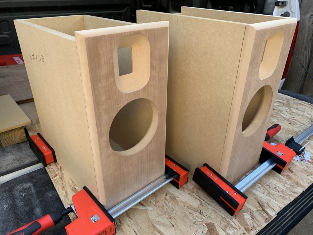

Thinking about 3/8” rabbet cut into the inside edge of sides, and have the long parts of the grill only 1/2”. While dry fitting parts I realized getting the grill in and out would be cumbersome without some kind of knob / pull. So I decided to cut the back down 3/4” from the sides (original design dimensions) and found that the grill can easily be removed by grabbing it from the back of the speaker and lifting up without any pulls or knobs.
I’ll have enough MDF cut up to make two or three pairs of cabinets since I’ve been playing around with this mock up.
Nice idea!

You can see 3/4” cut down Of back part in this pic. Original design vs side walls to the top.

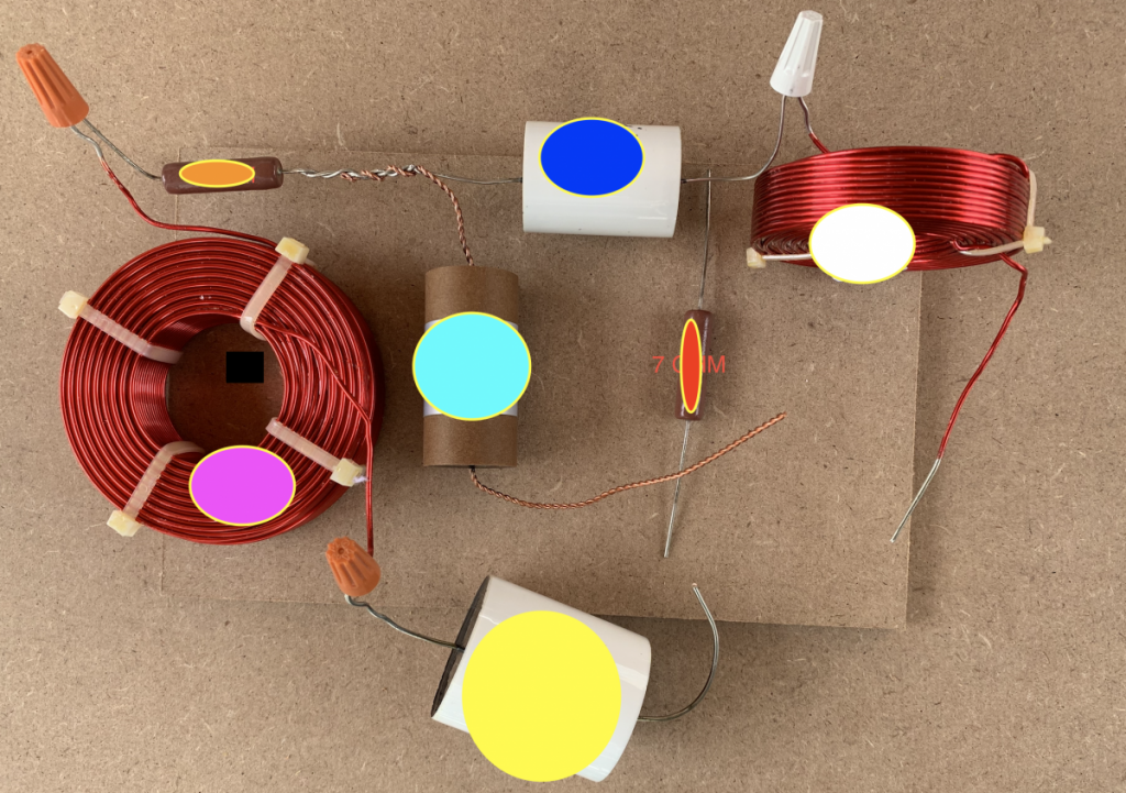

Attached is my crossover thus far for NX studio.
I have wire nuts at the ends where I will attach wires and tube connectors.
(This is to help me remember tube connectors)
Does this look correct so far?
Having trouble finishing off the rest of it.
From pics in post threads it looks like Sonicjoy and Michaelhifi had different capacitors and I can't tell from blurry pics what goes where.
Should the 7ohm resistor go in parallel with the capacitor?
or should it go perpendicular to capacitor?
I have all parts in reading orientation from left to right, is this correct?

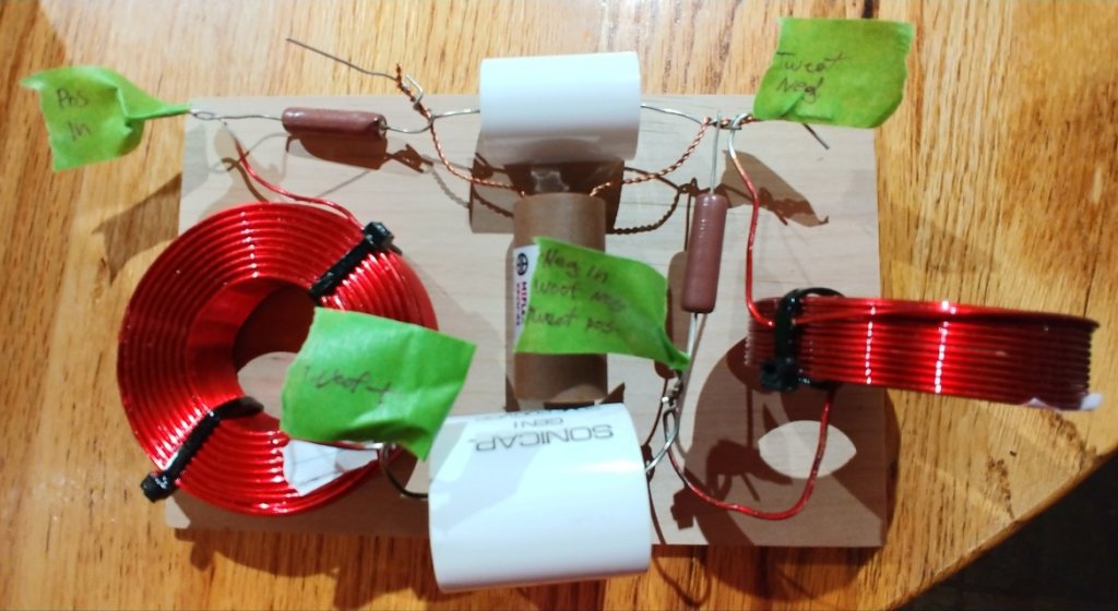

Sonicjoy
  • Posts: 366
Re: Sonicjoy's NX Studio build. With photos.
« Reply #208 on: 22 Jun 2020, 01:40 pm »
Study these carefully.
I see that the copper bypass cap you have is different in that the wires come out each end instead of the same end as mine do.
Just have to connect them the same as mine, on either side of the white sonicap at the top of the photo.
Upper left says positive input. Upper right says tweeter neg.
Lower left says woofer pos. Center tape says neg. input/woofer neg./tweeter pos. (all 3 connect together)
You can see the wires going to the inputs and drivers here. The red and white wires on the right going into the box go to the tube connectors.
the other two to the tweeter and the lower ones can be seen going to the woofer.
« Reply #209 on: 22 Jun 2020, 05:19 pm »
Anyone know of a cabinet builder in the Midwest? I'm thinking of getting the kit, but without a flat pack don't believe I have the skill set to build something like Sonicjoy did. I know Mike L is an option as well and have reached out, but Danny suggested posting here as well. Thanks!
We will have full  flat packs soon
PZ, try not to post  values of cros over components,  I know that  can be  difficult at times when asking  questions.
I have not built out a pair of these yet but  know that the  resistor you are talking about  will be in series wit the  high pass cap ( in front of it).... should  be shown pretty  clearly on the  schematic...

MichaelHiFi
« Reply #212 on: 7 Jul 2020, 12:32 am »
I think Sonicjoy's caps and mine are the same. The leads exit out at one end of the cap in Sonicjoy's and both ends on mine.
It might be prudent to NOT use my photo's as I never got confirmation that my x-overs are/were built correctly, only that I had located my lost schematic and it seemed correct. That and the speakers played well until a woofer stopped woofing.

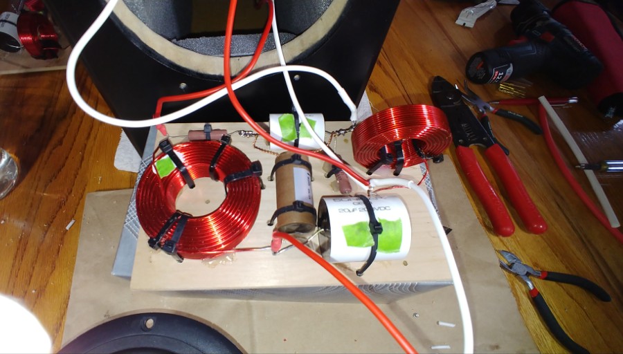

Ok here is the crossover part.
This was the mock up I did and asked Danny to confirm that it looked correct and he did. Thanks Danny!
Here are the parts ready to go. For details on crossover assembly read the Sticky "Crossover 101" Thread.
Edit: Make the crossover board 4 7/8 inches by 8 inches. Once you have the locations for the zip ties marked, stack them and drill both at the same time so they are the same.
Here they are ready to be hooked up.
The input wires installed with the tube connectors.
Edit: Be sure to review the tube connector Sticky thread to be sure you install them correctly.
Now I will caution others to be careful with your wire lengths as there is just enough length included in the kit. Just!
All connections made and ready to install the crossovers and woofer. Tweeter is already mounted.
You should mount the tweeter before wiring it. I drilled 1/8" holes for the tweeter wires. It fits nice and snug with no sealer needed.
Edit: Notice the Kleenex box under the crossover. That's to raise it up to make the tweeter wire shorter while soldering it to the board to save wire length.

And assembled and bolted to the stands. Again I will take some better photos soon.
