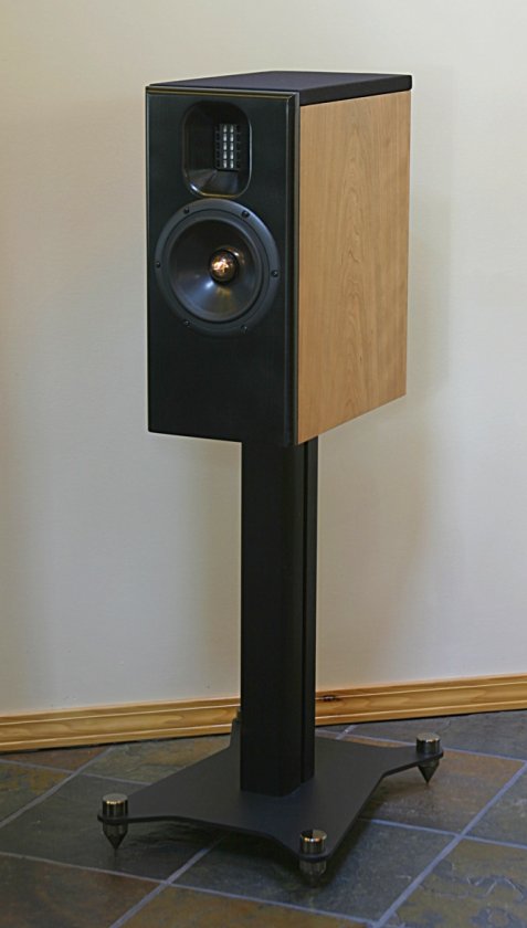

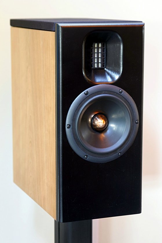

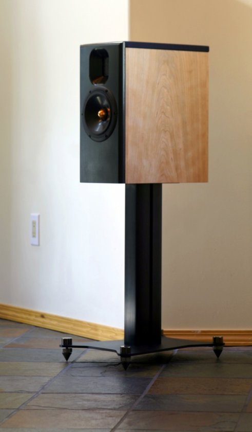

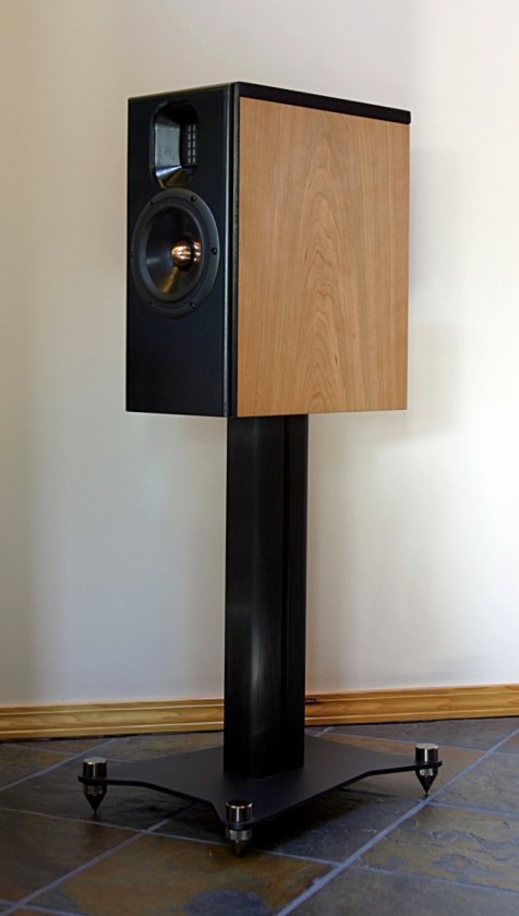

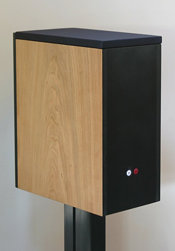

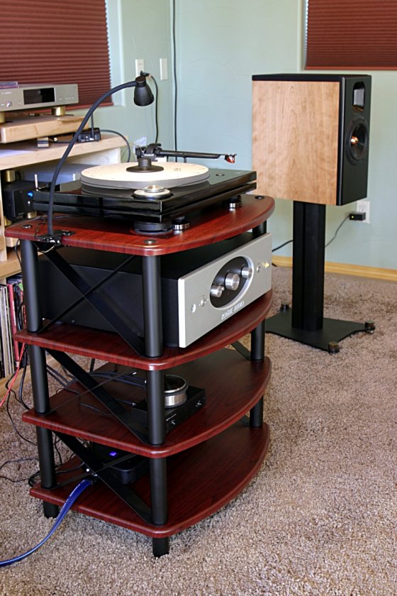

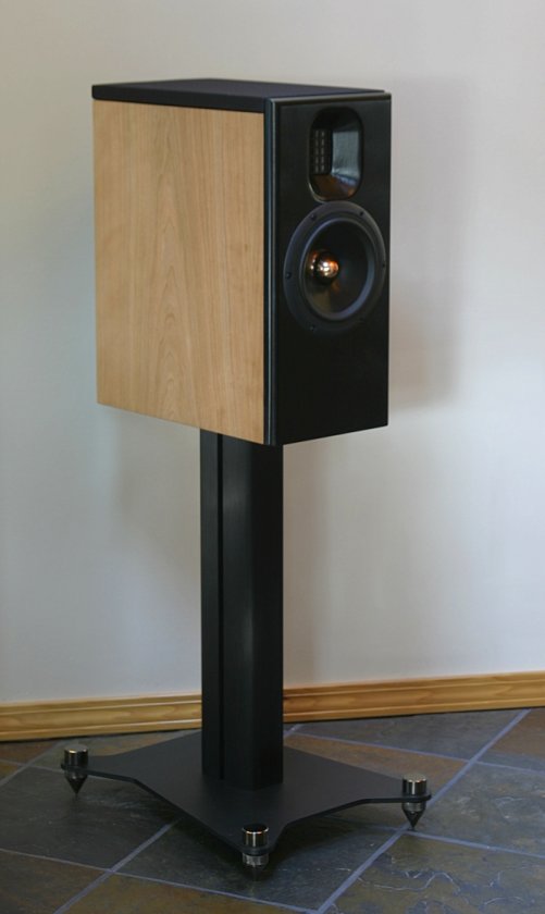

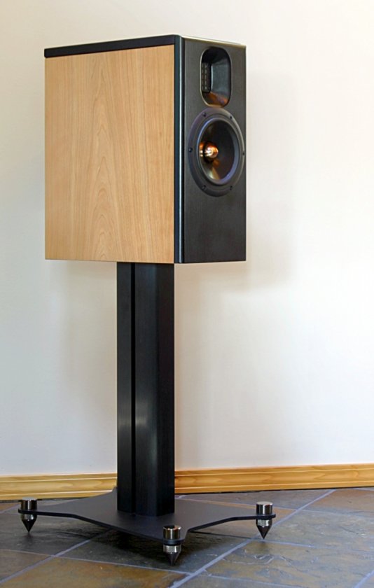

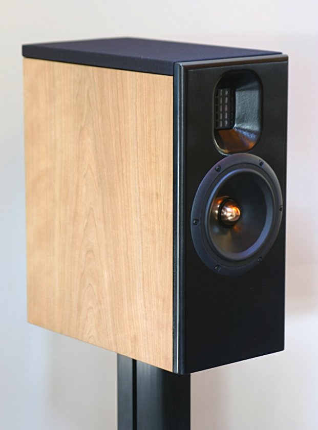

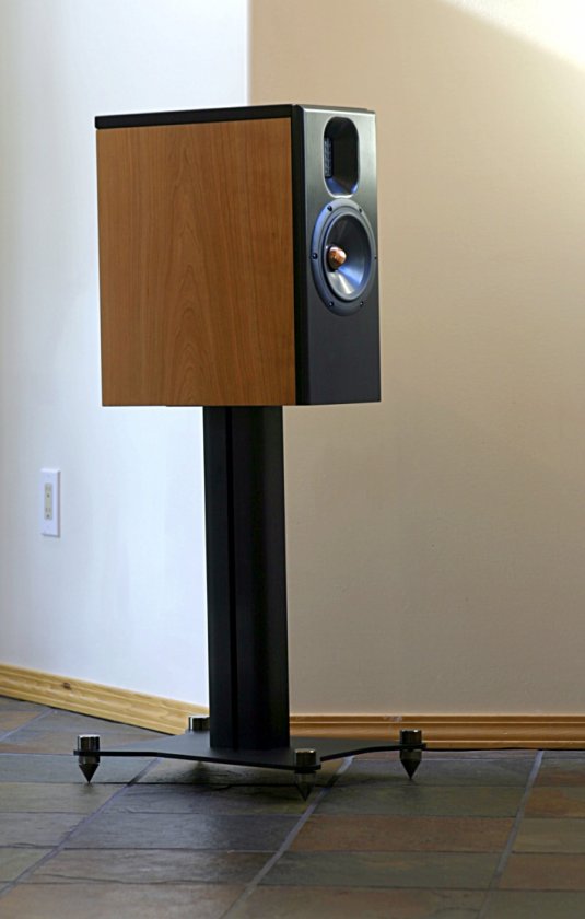

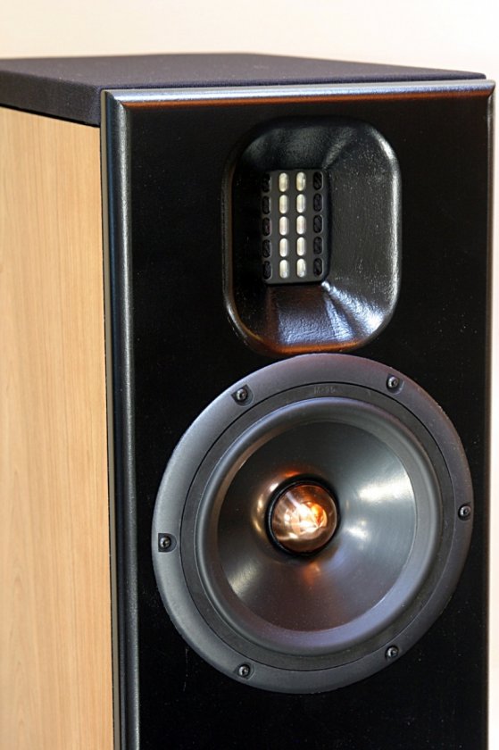

 Alright I am finally finished with this speaker build. I got the grills assembled today and they look good!
 Regarding the grills, if I could make one recommendation to anyone else building these it is this: Make the grill frames slightly smaller than the top of the box to account for the thickness of the cloth. I thinned the thickness down from 3/4" to about 11/16" but could have gone down to 5/8" and the width and length could have been made less as well. The cloth added more thickness than I expected. Minor detail but if I had it to do over? It's not bad just not perfect. Also when fitting the grill frames for the mounting clips, drill through the frame with a 1/16" drill bit from the top all the way through into the box. That will give you perfect alignment marks for the clips or magnets. Forstner bits work best for making the mount holes. In my case I needed a 1/4" in the grill and a 3/8" for the box.
Anyway here are the photos I have been promising. Enjoy!
This has been a fun project for me! I hope everyone else who builds these has as much fun as I did and feel free to ask any build question you may have. Happy to help.  :D

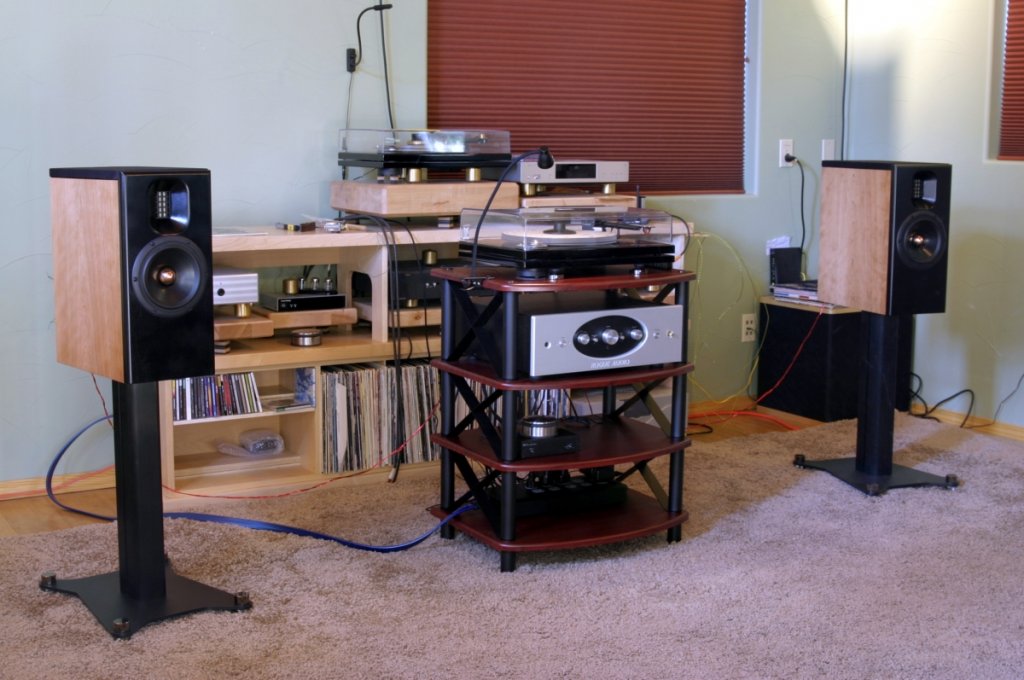

So I have been listening to the the Studio's with my Vandersteen 2wq subs for the last couple days. I have the subs placed just inboard of the speakers on the same plane. That is my preferred position in this room. This is proving to be a great combo! The Studio's having a box lower section blend very well with great box subs it turns out. I have not heard Danny's OB subs yet so I can't speak to that combo but I can say that they also blend excellently with good box subs so they should be very versatile in that regard. Now the Vandy subs are very good music subs! They use 3 down firing 8" drivers slot loaded in a sealed box and use adjustable high pass filters in front of the amps to roll off the lowest frequency's  before they get to the main amp/ speakers. They get their signal from the speaker outs of the main amps. The subs internal amps have a matching curve that restores the lows to the sub drivers (that are rolled off by the filters).  It's a great system that gives the subs the sonic signature of the main amps and make for excellent integration with the speakers.
This is sounding wonderful and has taken the Studios to a new level and allowed the mids and upper bass to be cleaner and smoother.
Very nice indeed!
