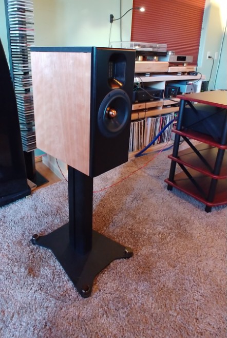

Thanks guys! That does look a little better Maty. I'm using my phone for the photos and editing. I will take some better pics with my DSLR after they are finished. Plus it's dark in my room early this morning.
What type of stands are those? I like them too!

Those stands are Elac brand for their Adante stand mount speakers. I like the fact that they did not put their name on them so they look better with other brands of speakers. They are 23 1/2" high which puts the tweeters at 38" off the floor and can be filled with sand. (if you plug the wire holes). They have nice looking smoked chrome adjustable spikes as well. I got them from Music Direct for $240. They were an open box clearance special. Regular $300. $600. list, but don't pay that for them.

Getting close to being done now - very exciting.  I'm really interested to get your impressions of them once they are up and running.  As I think back on all the speakers I demo'd at Danny's, in some ways I think it's the most impressive of the lot, because he gets such clean, clear, and big OB sound out of such small speakers that are half enclosed.
I will say this - that OB tweeter in the deep waveguide is something else.  It was very surprising to me that Danny was able to create a midrange driver that keeps up with it.

Wow, those turned out really nice!  I wasn't sure at first about an all black front baffle with cherry sides but those just look incredible, well done!

Yes you just have to make sure that the crossover board is narrower than the opening. There is enough room for one hand to work inside. Now I understand why Danny designed the divider brace the way he did. So there is room to work in there.
Just be sure to pre-drill the screw mounting holes in the crossover board ahead of time. That will make installing it in the box easier.
